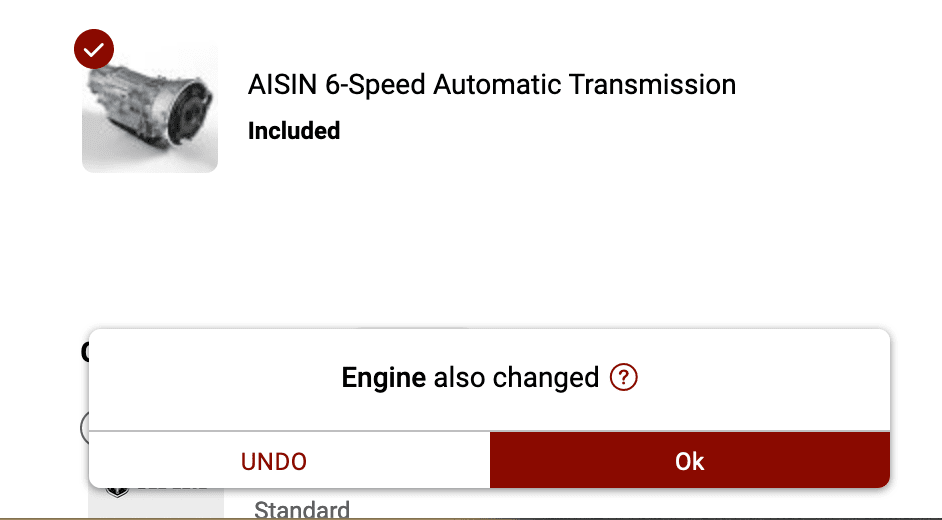

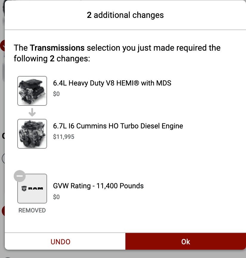

You can’t “build one” on Ram’s website like that. I seriously doubt you can order one with a SO/Aisin combo. Never seen one listed, can’t build one, nor has anyone ever reported owning this combo. It’s an odd duck. I don’t see that as a real possibility. If so, can you show us please?
Just tried to build a 3500. When you select the Std Cummins, you get a popup that tells you there was a change, which is the 68RFE. Then, if you select the Aisin you get another popup saying the engine has changed.
Then, started over, and went right from the base 6.4/ZF to selecting the Aisin, and it forces the HO.
