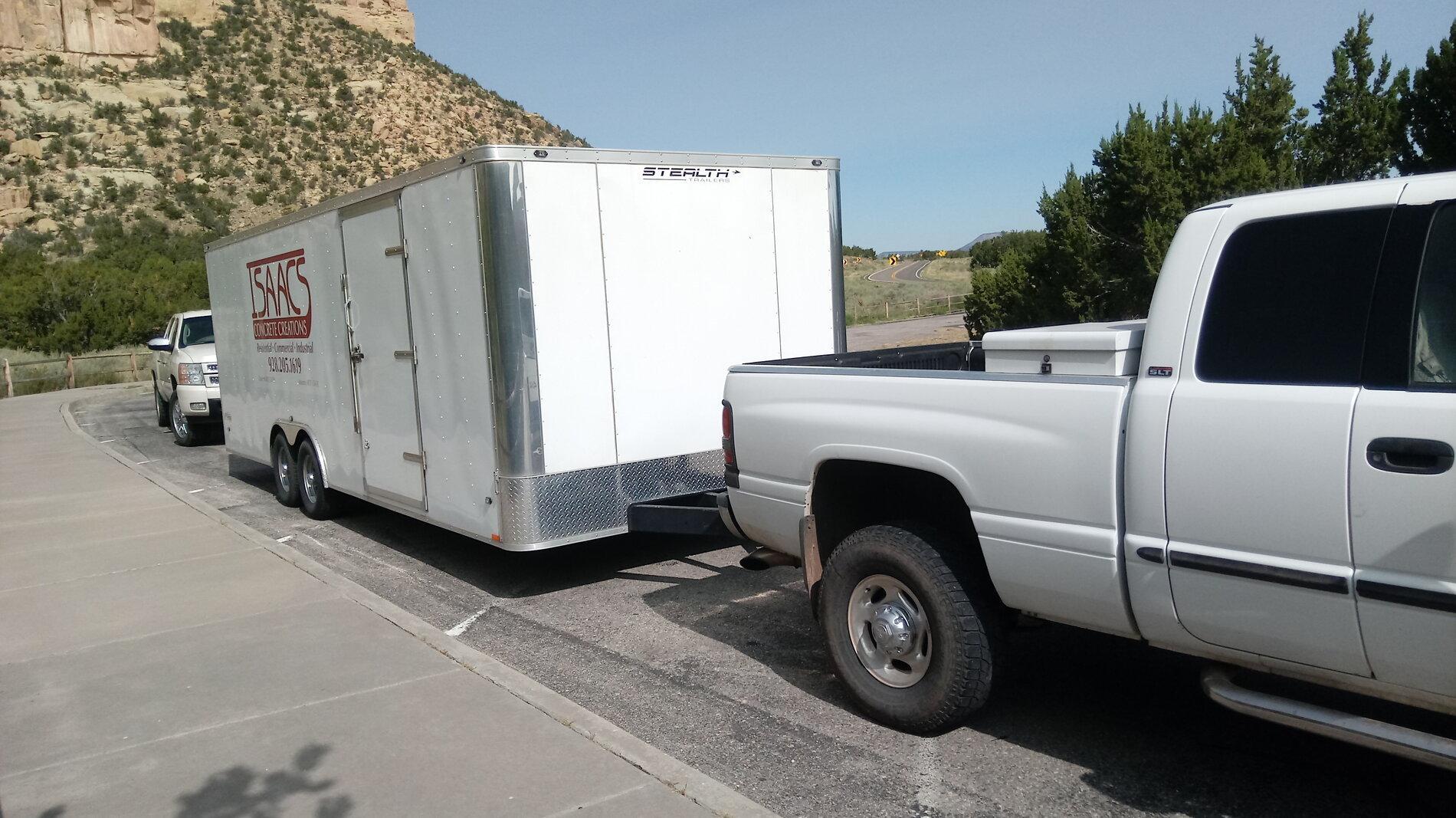

My son towed this trailer this weekend with his car in it, he said sway was so bad he had to stay at 60 mph and still white knuckles. He was using an equalizer hitch and has air bags. He said down hill he had to slow to 50 mph.
He said it was so bad he had a friend in the group drive the car home.....same uncontrolled trip...no help at all. He weighed the combo, about 13.5k, truck 7k trailer 6.5k.
He used this same trailer and load two years ago but pulled it with his dually. The truck was stable but the trailer wasn't. The owner says it sways his Dodge 4x4 and his Dodge 4x2. He even has sway control but my son didn't hook that up.
I did a Google but not much about the v-nose causing issues. My other son had one for a short time, he said it was really bad too.
The truck is a '21 Ford 250, 4x4, trailer is a 28', 10k rated, torsion axles.
Anyone?

I never had that in mine. I've seen to much tongue weight have sway and also not enough. I'm sure y'all know how to load a trailer to 15-20% tongue weight.
might be worth taking a tape to the tongue and axles to see if square.

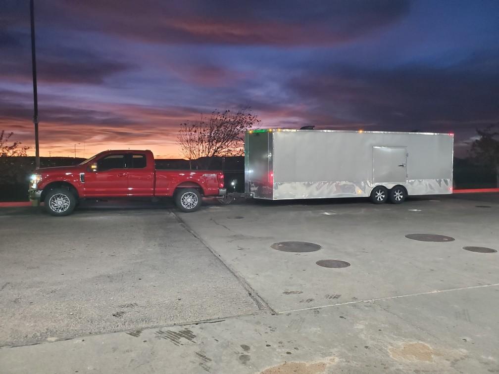

Judging by the picture I'd say tongue weight was more than sufficient....
Did they try adjusting the load at all while the car was in there?
I'm assuming a thorough inspection of the trailer was done, leaf springs, u bolts, etc.

The wind was bad both directions, worse on the empty trip. They did not move the car but he said it was right. My oldest son followed him both ways and was amazed at the trailer action and accused him of being drunk, Lol He has a flat faced enclosed that pulls fine. I pulled it one time and it was like it wasn't there. I would love to try this one but don't want to insult anyone:D
They thought about switching trailers but didn't. My oldest was using his dually pulling this trailer. I can't come up with a reason for what was going on.
I suggest it’s too much tongue weight. The nose of the pickup is sky high and the rear squatting. I would like to see the axel weights for an exact tongue weight. I would not be surprised if the front axle of the pickup is lighter when the trailer is hooked up.
Loaded or not the balance of the trailer may always be off say from bad axel placement.
Agreed, that was kind of the point. A truck that sits like that with air bags sure seems to be overloaded....
But on the other hand if Nick says it was right I believe it is. Could just be optics. The trailer looks to be level if not real close. If Nick didn't publish the weights I'd of guessed he was just plain over loaded.

It's misleading looking at the picture but the front end seems higher.
He does have a reverse level kit, he removed the rear 2" block, so when loaded with the right hitch weight, it will be low on the rear. He has hauled several vehicles with it on my old 20' equipment trailer with no issues. I don't think the front is light.
Proper inflation on truck tires for the load??? Looks like the front may be getting unloaded as in too much hitch weight and nothing being added to the front axle. That tends to get very squirrely.
That was the missing link, how could such a light trailer should squat a 3/4 ton pickup like that.
