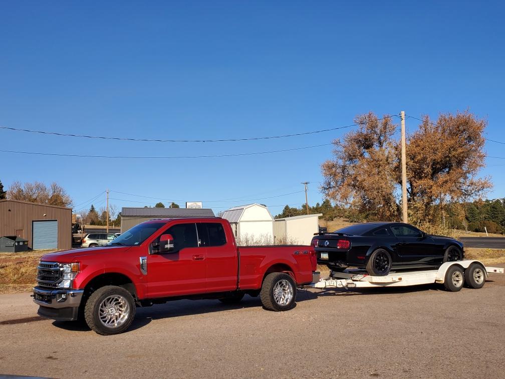

When hitched to the pickup, what is the distance from the ground to the front part of the trailer, and what is the distance from the ground to the rear part of the trailer, ie is trailer level when hitched to the truck?
Less than an inch.
Just my $0.02, I've never had heavy tongue weight cause sway, but I have had light, and especially negative, tongue weight cause sway.
I had a buddy that asked me to haul a truck for him on a car hauler. I don't remember why, but we had to back it on. It was actually lifting the back of the hitch slightly, probably around 25-30 pounds of lift. It was CRAZY swaying. It wasn't very far, we took side roads and couldn't hardly run over 30mph.

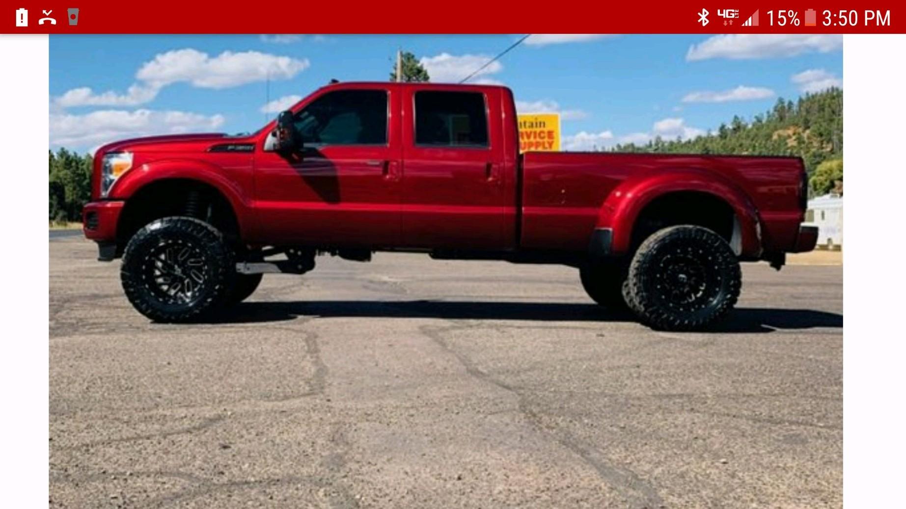

I'd like to see a pic of the truck without the trailer.
I'd like to se a pic of the truck without the trailer.
Same here, I have had to tow some very tongue heavy loads with no issues so long as the truck tires are up to it, the OPs pic doesn't look very squatted in the rear at all especially for having a reverse level, cant see how that would cause the issues described. Makes me wonder if it was just light on the tongue afterall.
i've had to much tongue weight cause sway. moved the car back 2" and all is well. first time I moved car back 4" and sway was bad. that's how i found the magical 2".
Godzilla? What is his opinion of it?
Yes, 7.3, he likes it, says it has good power. He is waiting for a blower to be released. He wanted a regular cab but leather was not an option, so he had to go super cab. I think a hotrod is in his plans.
I asked him for a side view picture of the empty truck.
This is the truck he towed the trailer with 2 years ago, same road and load. He said the truck was solid but that the trailer was funky. Note the tires on that thing, super single SRW on the front. The tires are huge with a rear width of 8' 9", over width:eek: It is also his paint job. He can't leave anything alone, has to modify everthing he owns and is not loyal to it, sells everyone. He has built tons of trucks, mostly 70's Fords.

I feel like there had to be some underlying issues if a trailer is that sensitive to weight distribution that 2" caused issues.
I have had trailers that swayed and if hitch height is right and weight is right, it has to be mechanical in the trailer. If it is mechanical and as bad as you claim, there should be some odd tire wear on it somewhere. It might just be a tire that belt is separating.

My son said this load was a piece of cake. I asked him why he backed the Mustang on and he said to clear the doors with the trailer fenders.
