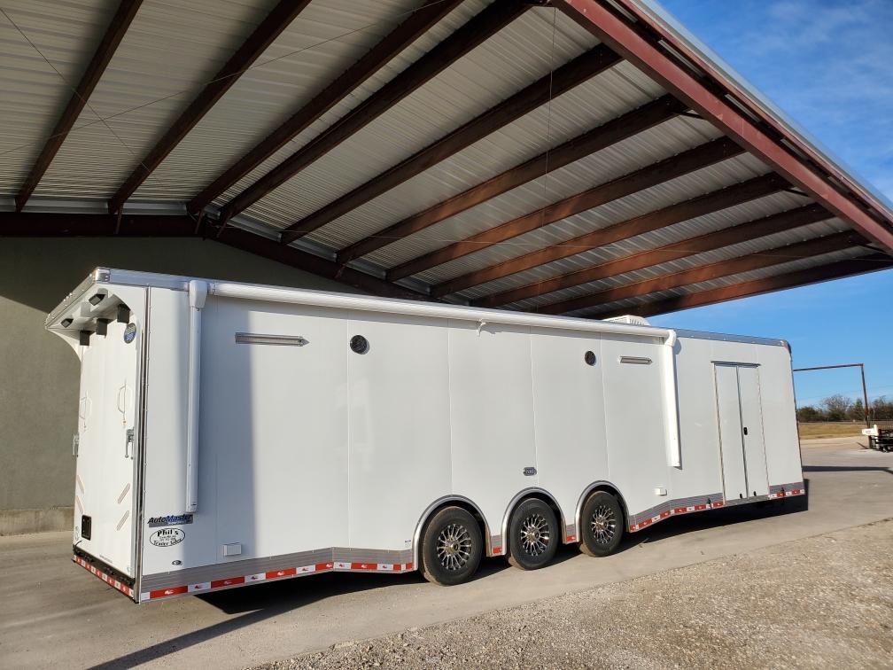

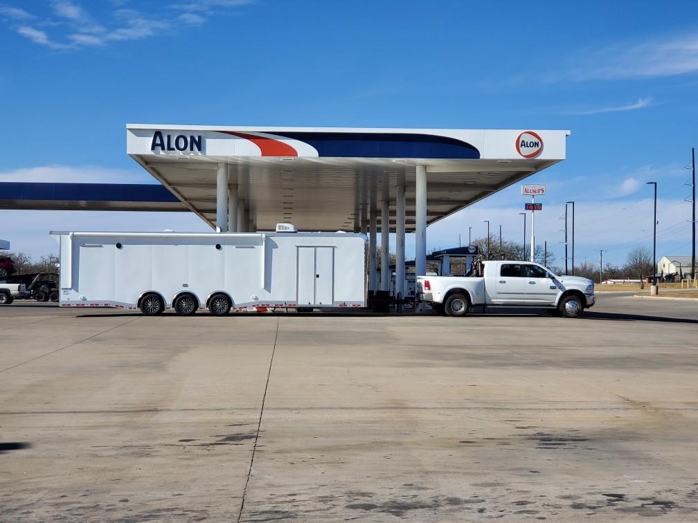

My son sold his 24' enclosed car trailer and picked up a 34'. It has a small lounge with a small bathroom/shower, refrigerator, AC, microwave and two fold up couch/beds. He is using his '16 Mega Dually. Downhill to central Texas (Waco) he got 16 mpg and uphill he is getting 8, just using the display. He said it is pulling pretty hard, but he drives fast. It has triple 6k torsion axles which surprised me, because Dexter doesn't recommend that. I told him I would go get it, but he said my rates are too high:D

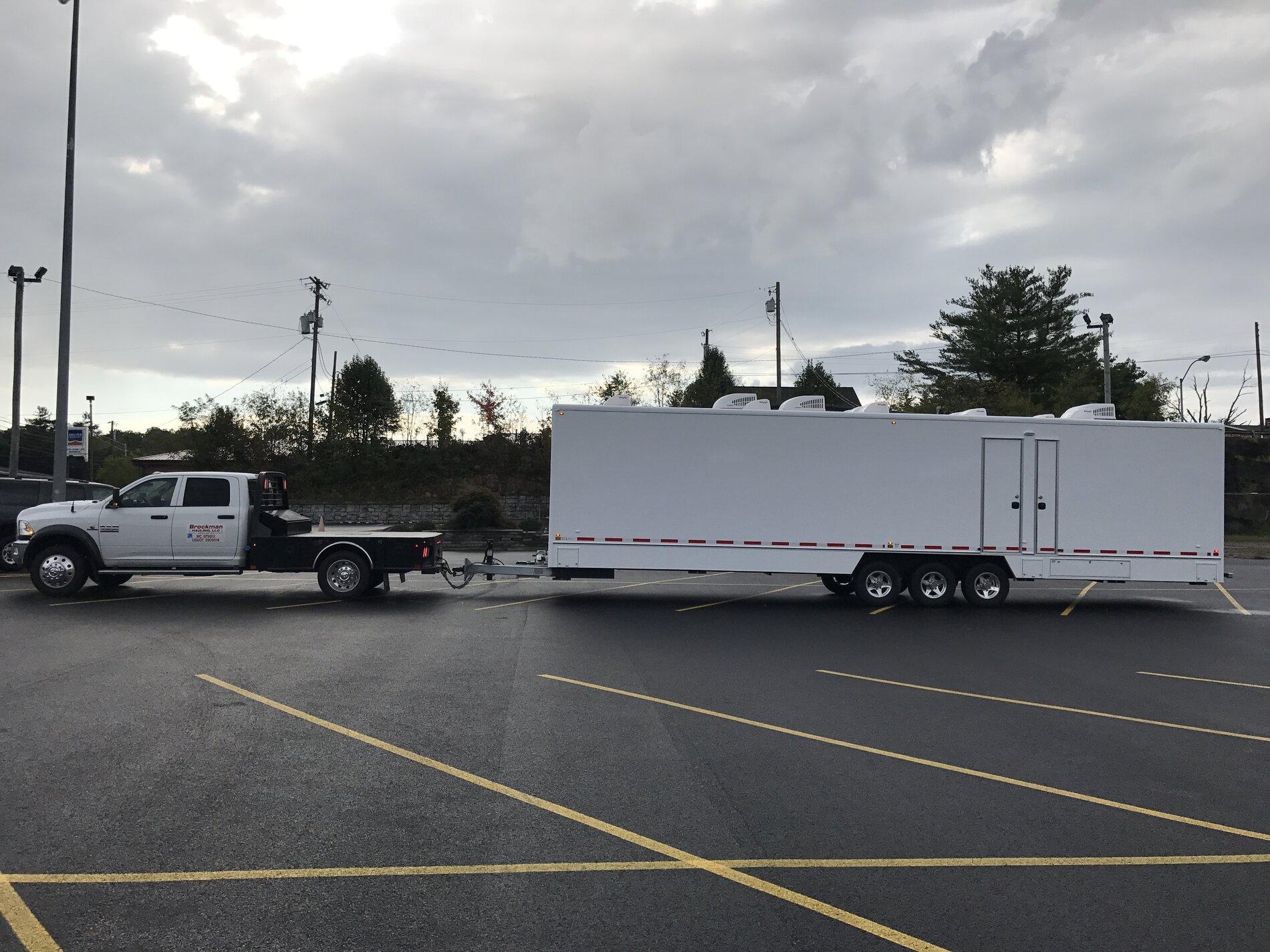

All I can see is that tail wagging the dog,. All I have now is goosenecks so maybe I’m just being biased
I would have picked that trailer up for him in an instant with my 2500. When they are right, they are no problem at all. He will be using his 5500 for all his local towing so "where is it"?:)

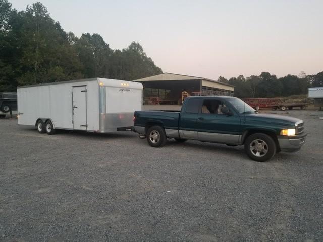

I know this one's not near as long, but I've pulled it several times loaded with cars and trucks with no problems.
Last time I pulled it was when my brother used it to move when they bought a new house. I left it overnight so they could load it and went back the next day to pull it to their new house. They had loaded everything in the front, the tongue jack was on the ground, and my rear tires looked like they had 15 psi in them. I should have taken pics, but all I could think about was reloading it and getting that weight off my truck. I supervised as they unloaded it and reloaded it properly. They all learned a hard lesson that day.
