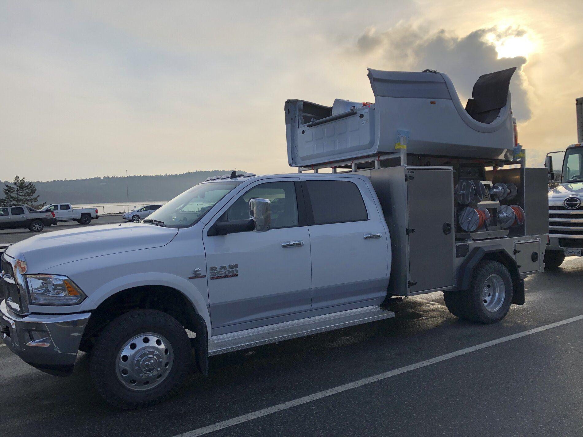

I currently own two 2018 Ram 3500, 4x4, crewcab duallies. One has the Aisin w/4.10’s and the other with the 68rfe w/3.73’s(in photo). I’ve put 8,000km on the aisin and 4,000 on the 68rfe. The Aisin truck’s braking with full brake/tow haul is much more aggressive at slowing you down. With the 68rfe truck I find myself having to use the foot brake much more often to assist in slowing down. Now there is some torque multiplication advantage with the Aisin/4.10 truck that does also help with the braking as well, but the programming with the 68rfe isn’t as aggressive. (I wouldn’t have bought the 68rfe truck but we needed a new welding truck and couldn’t wait to order a 2019 and there were basically no Aisin truck in western Canada that were the right fit) I beleive this is because the Aisin is much stronger and can handle the braking internally much better. At least I won’t have to be the one driving it, one of my employees will be.

His comparison is NOT equal as the 3.73 gears will NOT slow you as well as the 4.10’s.​
I do drive both trucks aggressively and this is my second Aisin and my second 68rfe, and I know that the 68 is an adaptive transmission and drive accordingly.
As well, I DID mention that the 4.10 equipped truck has an advantage.
