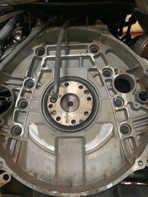

My driver is reporting Trans made loud squealing noise, lost power getting on the highway so they started to pull off to shoulder and it made a loud clunk and the rig shut off. Tried starting-ran for a second then stalled. Trans codes are present. Hope it’s solenoids and not the TC.....
The code doesn’t correlate to the converter. And it wouldn’t kill the motor while starting to pull off the shoulder. You would need to be almost stopped.
PO700
U0121
Also present.
Kinda unverified as to when it stalled, and wether the screech was loud as it was described. Anyways it’s going to the mechanics, will post a follow up.
Welp........
Flywheel broken or did it come loose? What about the code for pressure control circuit? Did they find a problem or are the fixing the flywheel and putting it all back to verify then repair?
Torque converter swelled up and pushed the flywheel into the flexplate/bellhousing adapter. Converter is currently stuck on the transmission.
