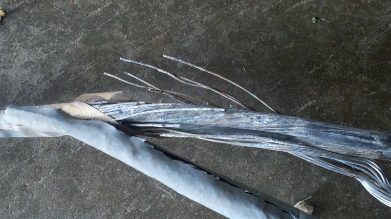

I cut the wire open just below the meter box and found neutral completely corroded and destroyed 8" below the meter box. I will post pic later. Looks like I fried a few things in the house.

Here is a picture of the wire and the neutral. It was about 10" below the exit of the meter box.

I continued to cut it open today. It looks like that the entire way.
Not sure how to answer your question... ... ... . I didn't pull the panel or the meter box. Replaced whole feed from meter to panel. About 10' worth.
That is an ugly pic! I might have missed it but did you pull your box with hot feeds?
