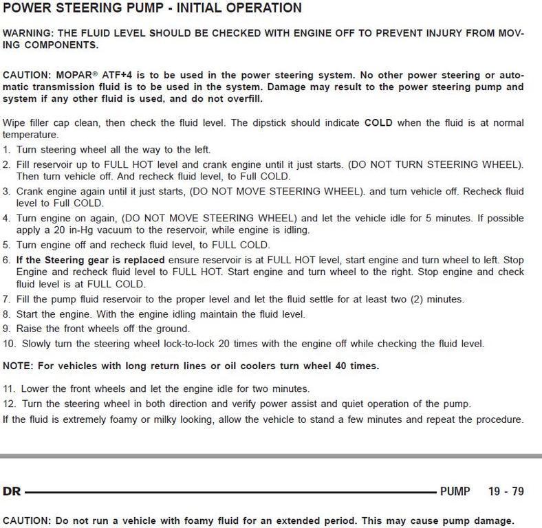

After 6 power steering pump replacements including 2 that never made it out of the driveway. These pumps were replaced in about a total of 35000 miles driven and yes I used AMSOIL trans fluid and followed the directions of turning the wheel lock to lock with the motor off before starting the motor. I am at a loss, tried Advance Auto and Autozone wanting a local supplier and found out later they both use Cardone as rebuilder. So who sells a reliable power steering pump that will hold up and not break the bank? I am looking a an AC Delco reman pump, and ideas?

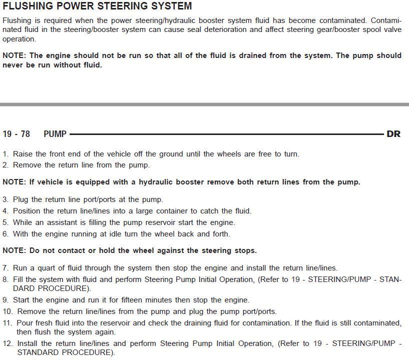

Have the lines been flushed? Do the brakes work?
Well the new AC Delco unit is here, waiting on the pully puller kit to get here, tired of renting one. When the pump failed there was no warning, just died, complete loss of any power assist both brakes or steering, increase of RPMs didn't help. When this one blew I was parking my 34' 5th wheel and was fully loaded down. I was lucky that the 5th wheel was straight and all I had left to do was back up. I did call Cardone and they want the dead new pump back and they are sending me another pump to turn in to Autozone to get my money back, we will see how that goes. not sending anything back until money is back in my pocket! I plan on flushing (again) the system and thinking about adding a filter, any ideas on that?

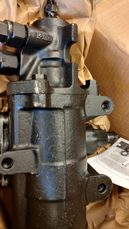

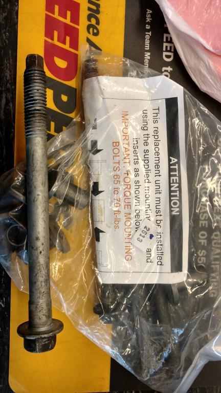

Got the AC Delco pump in was working fine and then the Cardone rebuilt power steering gear box blew the bottom pitman arm seal and back I went to Advanced Auto for a replacement gear box. To make things worse the gearbox they now carry is a lighter duty, it uses smaller bolts and you have to use supplied spacers, don't think you can torque those bolts to the required 145lbs and I wasn't going to find out.. I do have pictures of the bolts and spacers, trying to figure out how to post them. I returned the Advanced Auto cardone gearbox and bought another gearbox from Autozone (its not a cardone) and now truck is back on the road.
I also placed the factory bolt next to the bolts that come with the Advance Auto gearbox and if you look at the gearbox oil fittings they use adapters to fit the larger 1/2 lines our diesel trucks use. would you put this gearbox on your truck?

No, would not even mess with the rebuilds or aftermarkets anymore. The updated OE box looks to be the best option for longevity.
