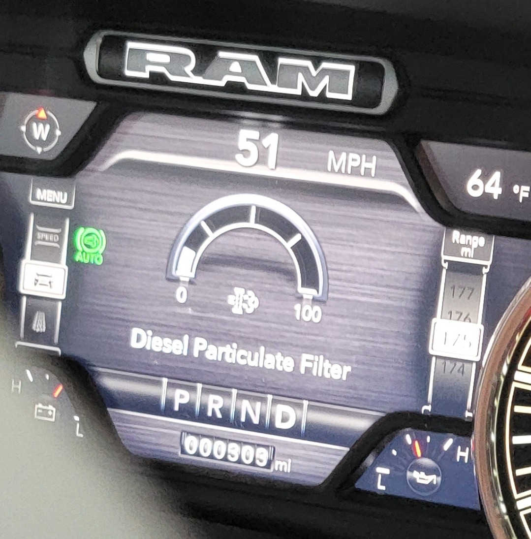

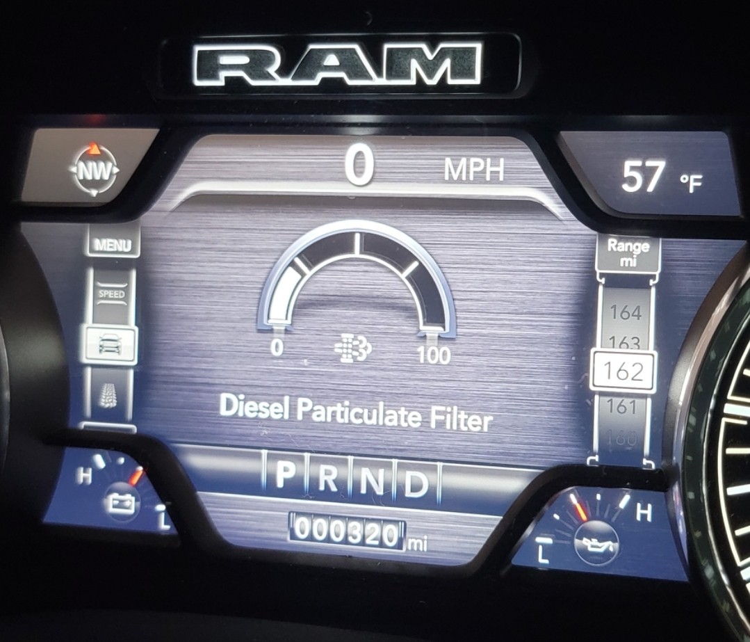

My '22 is brand new do no towing yet and with the paint process has pretty low miles.
Here are some shots of what I saw today.
What kind of driving is this happening, any towing when this is doing the regen so often deal, or light daily driving.
Idle Hours: 3
Drive Hours: 8
Total Hours: 11
303 miles driving home
320 when I got to the store before I got home it jumped up a little.
