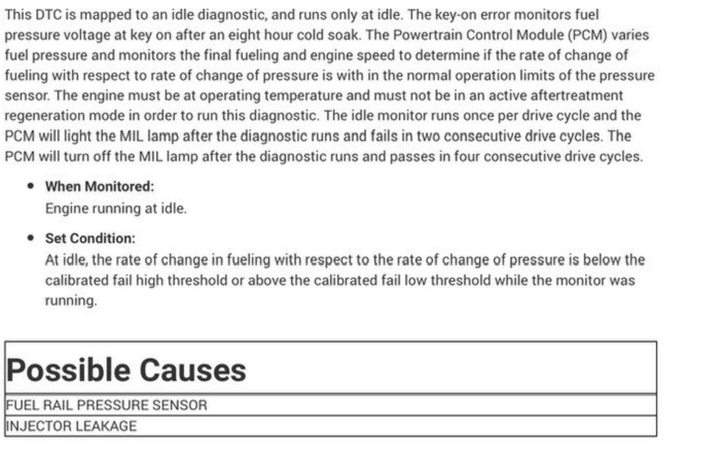

I've post here before about my P0191 (Fuel Rail Pressure Sensor - range/performance problem). I had this code going on 3yrs. Truck is 2012 2500 stock with 155k miles. I've replaced the FRP senor, the FCA senor, and multiple genos OEM fuel filters. From a performance perspective I haven't notice any issues, so I've just lived with it. I'm planning a couple longer camping trips with the family and would like to get this issue finally resolved without spending too much money on needless parts. Using the Car Sanner Pro app I'm able to monitor both command and supply fuel rain pressure and supply is usually about 200psi under command this works out to about 2% under command which IMO is reasonable although I have no data to compare. What I have noticed is the MIL comes on when driving around time. Once we hit the freeway for a trip the MIL will clear next day. When I'm at the stop light the truck will sometimes idle a little funny and fuel pressure can drop as low as 4,400psi. I have started to suspect it’s likely a leaky injector’s. I had an oil analysis done some time back and no fuel in the oil was detected.
Looking through some closed threads on this topic I came across this interesting diagnostic. I think the funny idling is the truck running this diagnostic test. The truck doesn’t always idle funny, but when it does I know the MIL is coming soon and that’s when happened today.
Looking for suggestions on steps on how I should go about having the injectors test. I’ve read the injector tubes can leak. Is this something that can be fixed by checking torque? I’ve also read there is a flow test that can be run without removing the injectors. I’m not sure if this is something a normal diesel shop can perform or if this would need to be done at a RAM dealership? Thank you for your time and input!
