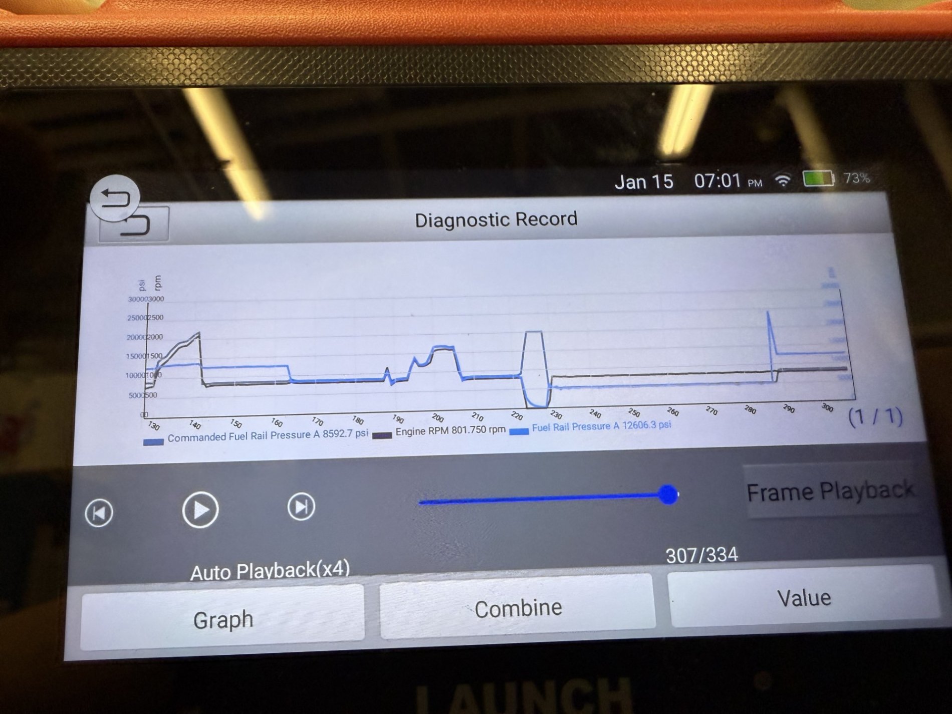

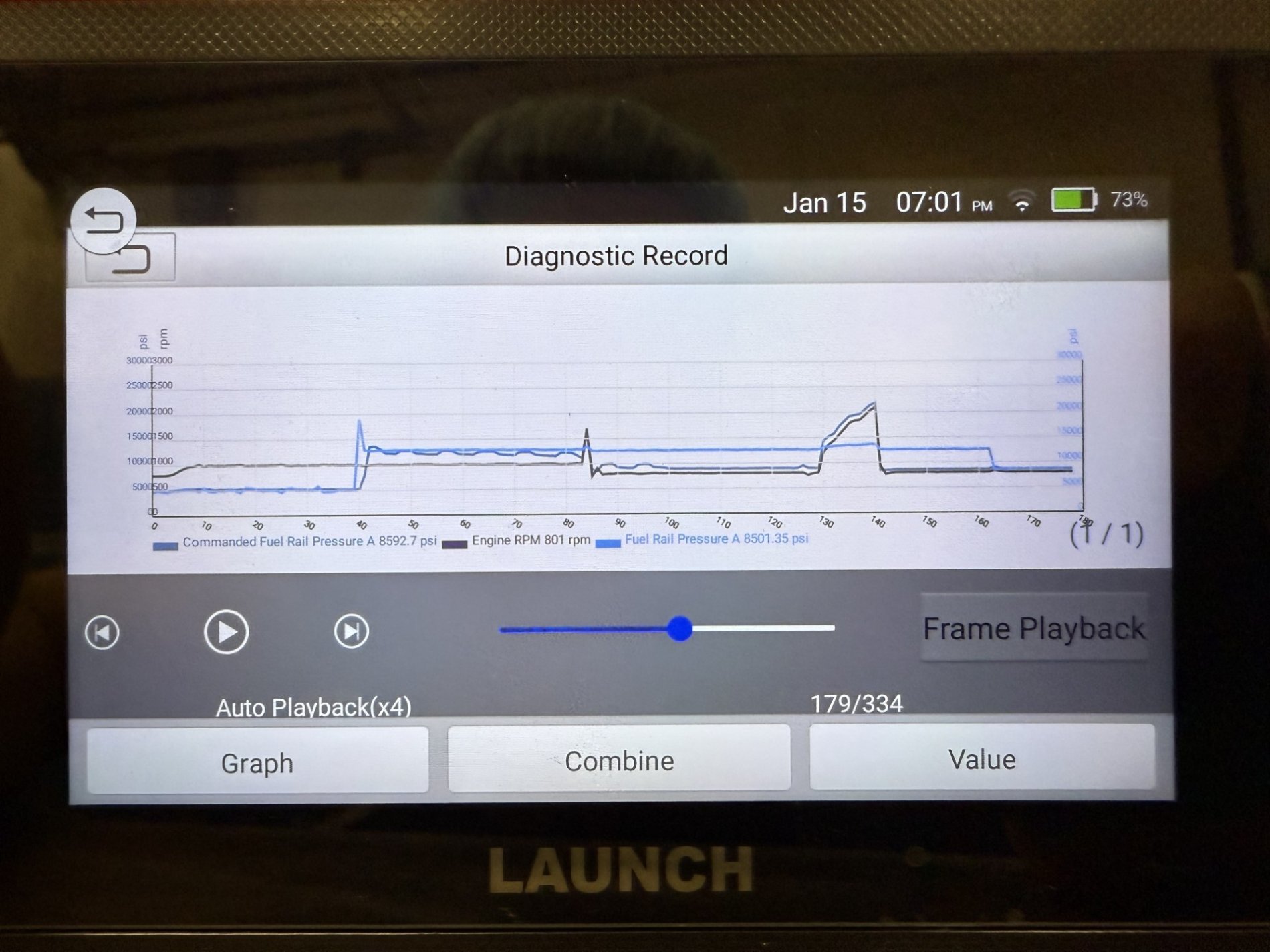

So, after unplugging the FCA while it was running I see some odd things. Before Unplugging it commanded and actual were pretty close at 5k psi. The actual was still fluctuating a bit. I unplugged the FCA and the pressure spiked to 18K for a second and then dropped to ~12k and held there. Commanded did some weird things, maybe it saw the pressure spike and wasn't happy with that and trying to get it down I am not sure on that part. But what was weird was when it was plugged back in both commanded and actual hung around 8500 PSI. Turning the truck off and they were at 5kPSI and then unplugged and plugged back in it did the same thing. I should add there has been no recent work or updates done to the truck to cause this. My question is, is the lift pump going out or not flowing enough fuel to get to the high pressure (spike of 18kPSI) and stay there. And why after plugging it back in will it stay at 8500PSI commanded until the truck is shut off?

Your rail pressure should have spiked to 26K psi and opened the HPRV. I wonder if you have a weak HPRV.
I can kinda see that, maybe? Why though would I see fluctuations at 5k, and not at 12k then? Even not getting up to the 26k it still held steady at 12k with no issues or deviations makes me wonder if it's getting enough fuel to make pressure. If it has enough to make 20k and sucks that out and only has enough fuel to make 12k isn't that what it'd make? From what I can see the pop off for those is 32kPSI? Does that sound about right

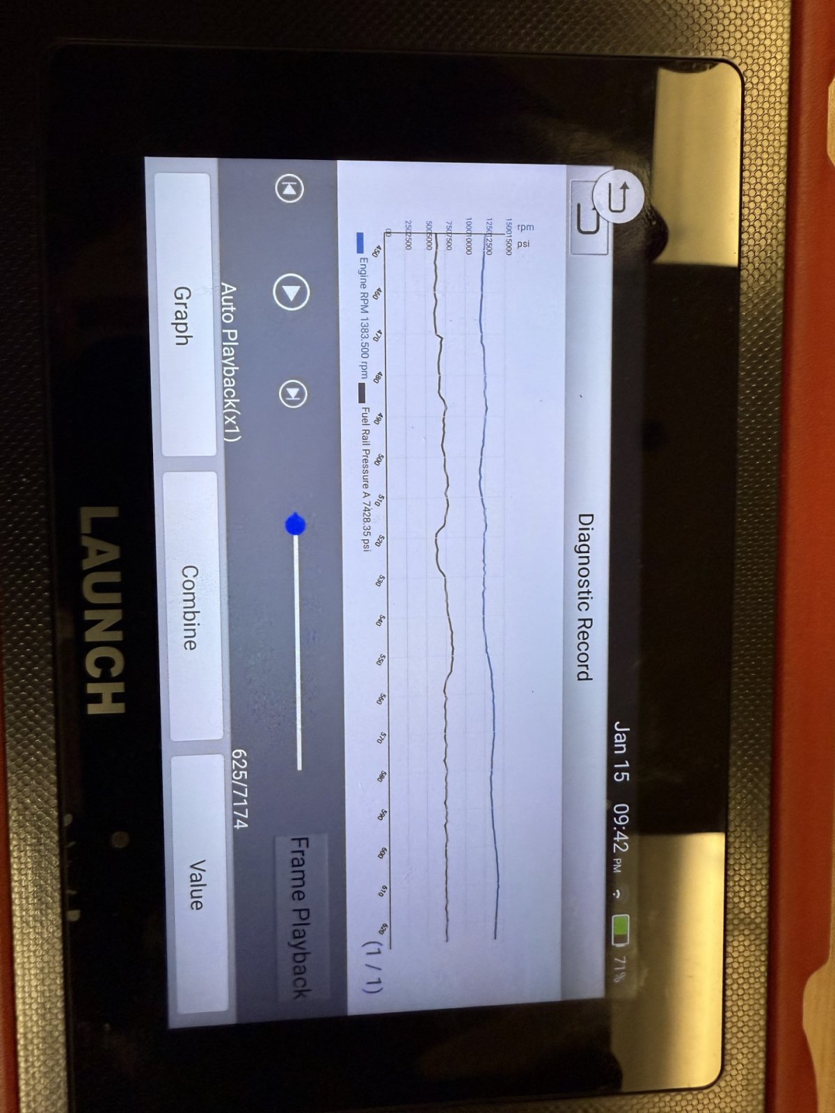

Whats the Max rail pressure you see while driving with the Scanner connected and the FCA plugged in of course.

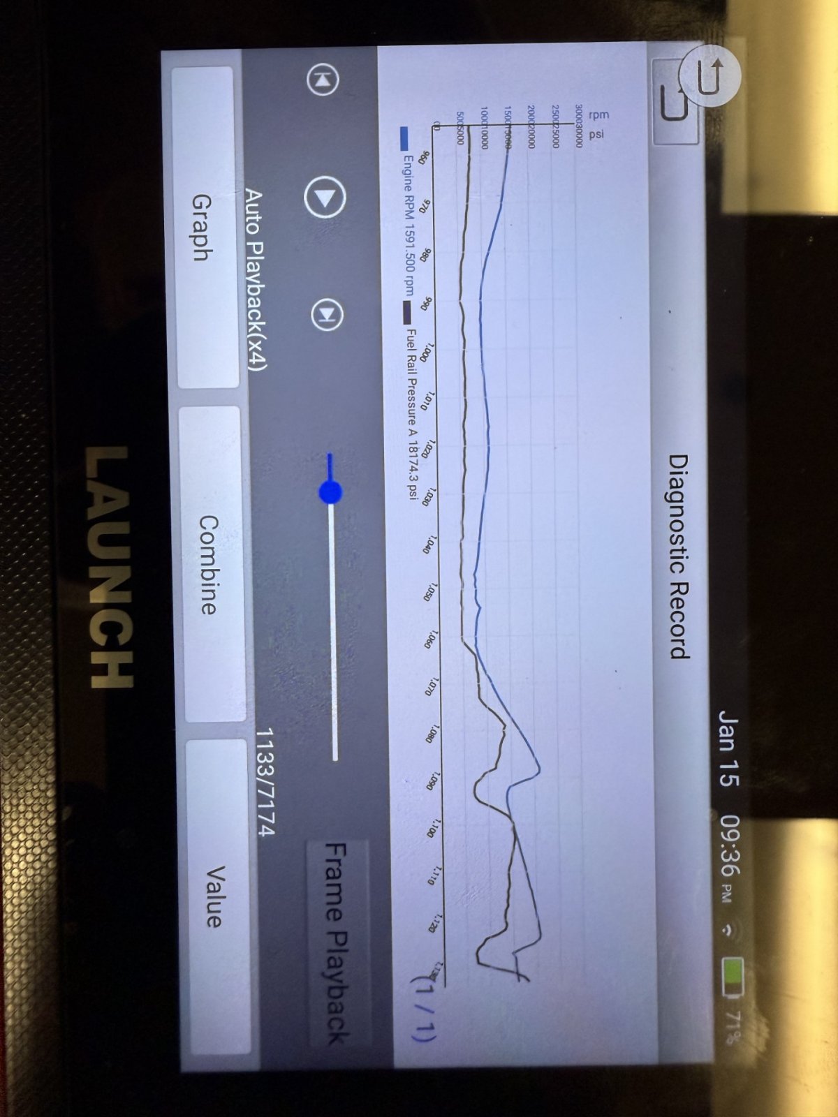

Usually the highest numbers up to 23k I see is at around 1500-1800rpm with a steady throttle and medium load.
WOT and high rpms give lower numbers like 12k to 15k.

Is that 22-23k stable pressure? About stable I mean I'm not exactly worrying about splitting hairs here, just as long as it's not fluctuating like in previous graphs have shown causing the rough idle and driving issues.
Yeah more or less stable as the oberflow valve regulates the rail pressure then, the CP3 is a max volume equals max pressure.

I wish there was a way I could link these files so you guys can mess around with them and see whatever you wanna see. Unfortunatley i can t figure out how to export them off of the scan tool. It looks like driving and shifting to 4th(I don't use 1st gear) I see Sub 19K @1800RPM
That looks way to low for the given circumstances, 7k I see at idle, never while driving.

I don't even see that at idle, it's always calling for 5k. Except for today when I plugged that FCA back in and then it started calling for 8500, which is still weird to me that even blipping and a rev hold and it wouldn't command any less than 8500PSI. I'd have to key cycle it and when it started again it was commanding 5k

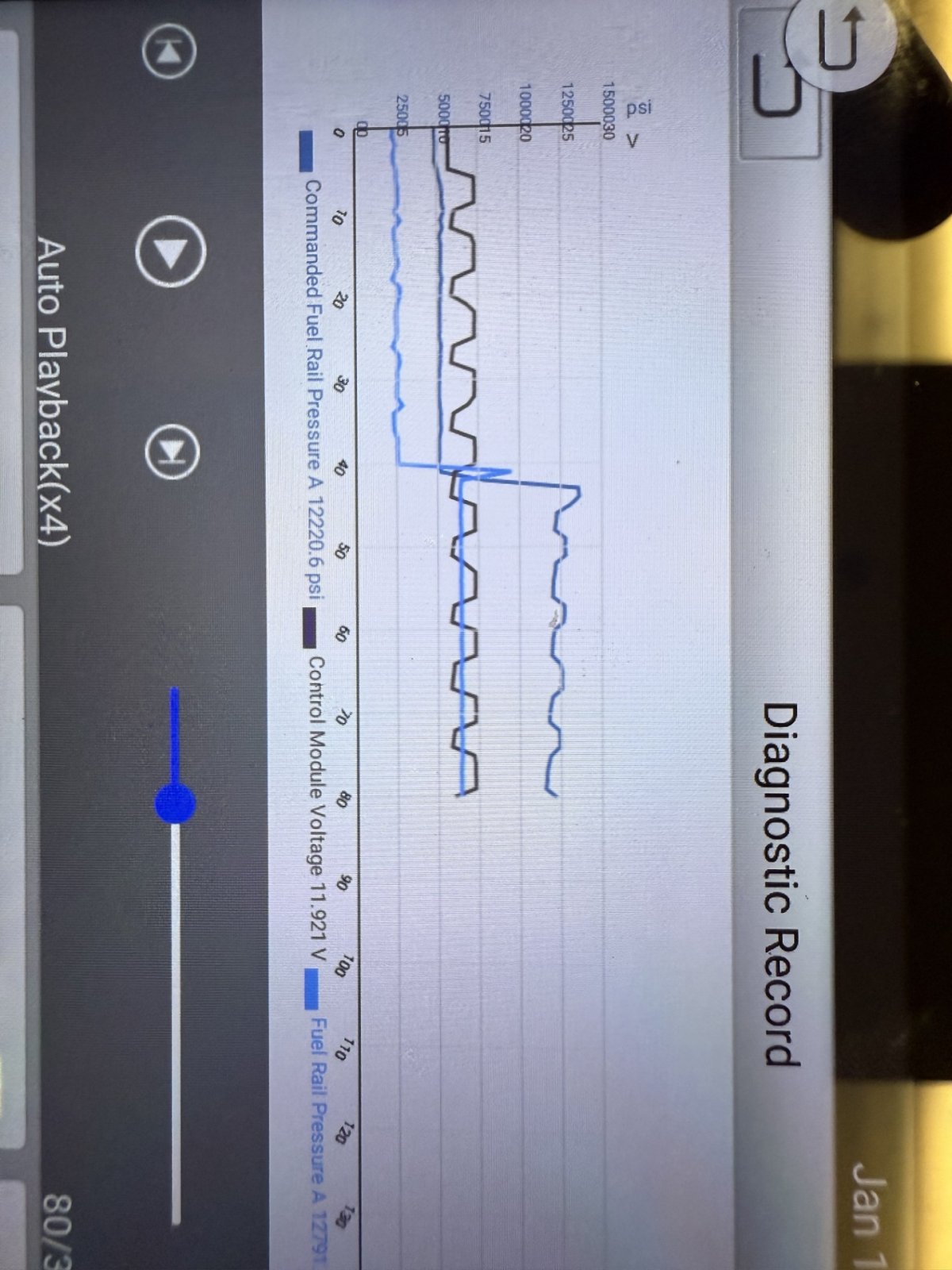

Just out of curiosity, at what voltage do issues start cropping up? I'll need to meter the batteries to verify but I pulled the graph for the Control Module Voltage and the commanded pressure kinda mimicked it? *EDIT* I might have put my foot in my mouth on this one, I've gone through all my other charts and found that the CMV didn't do this before. After a bit it did even out at 14.5v I will still check the batteries when I can again to make sure one or both aren't low as the truck was sitting for twoish days before I unplugged the FCA.
