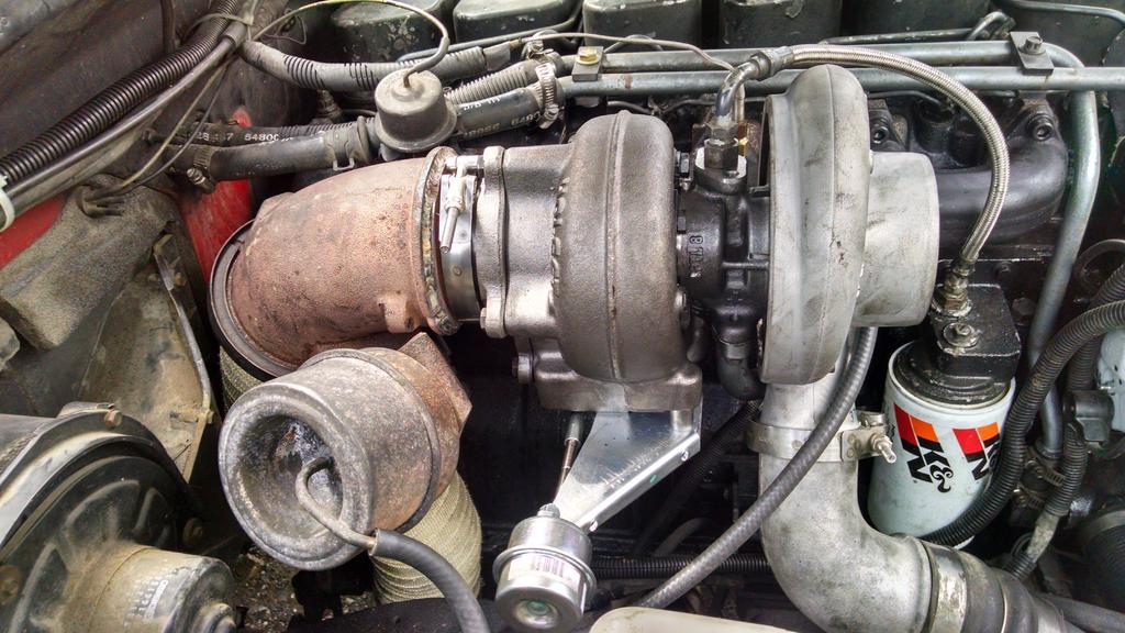

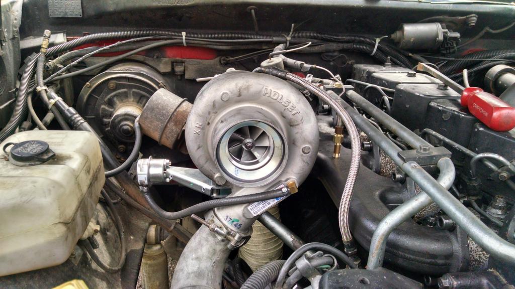

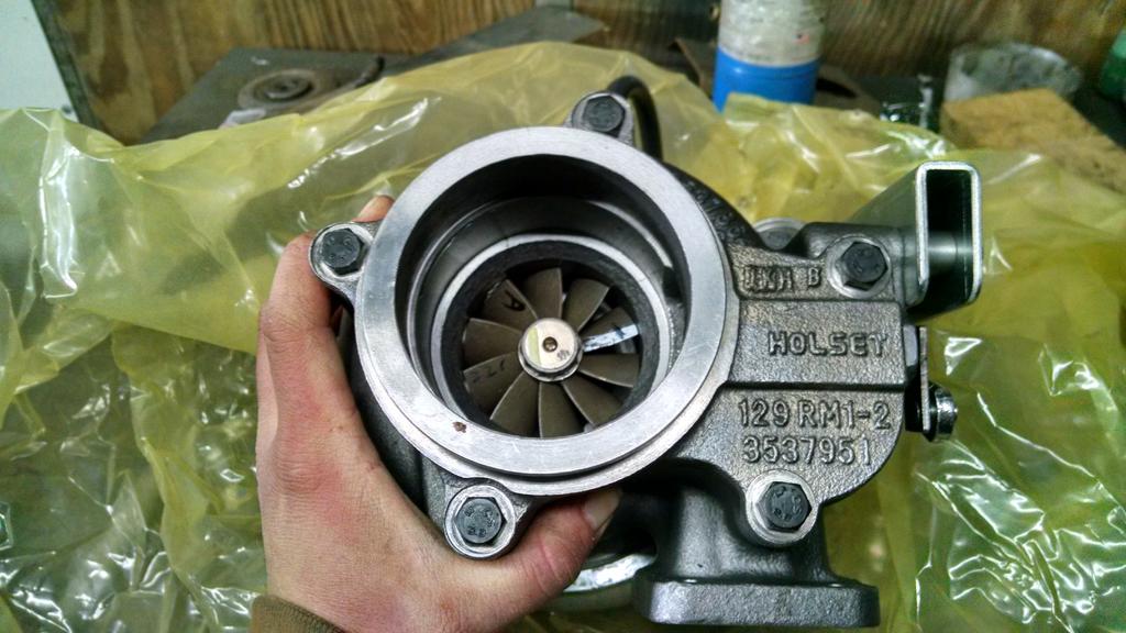

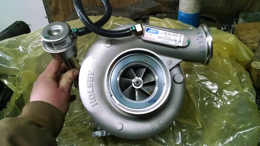

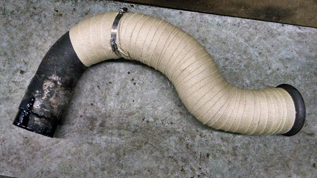

After waiting for a week I finally got my super 40 turbo in and got every thing put on the truck, a friend of mine changed the mounting flange on my old 3rd gen exhaust break so it mounts directly to the super 40 instead of the HE351 it was meant for. The weird combination of parts im running did require the making of a custom down pipe to make every thing fit, but even so the pipe is still real close to the fire wall and heater box so I wrapped it with header heat tape.
