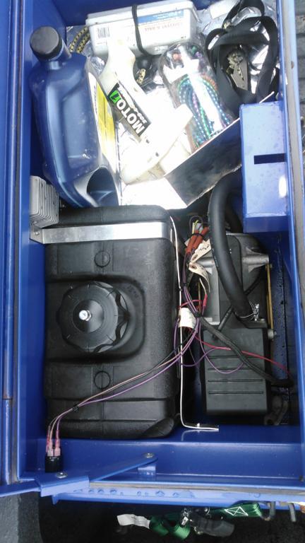

Hi guys,
Long story short, I put an Espar, Hydronic M10 on my truck within the last week. I had previously set in up in my garage using test equipment to do fuel flow analysis, and amperage draw; the heater worked awesome. I finally got around to plumbing into the truck. I retrofitted a jobbox in the bed of the truck and kept everything in it. I've got a 7 gallon fuel reservoir mounted inside as well. I plan to run kerosene in it during the cooler months. I tested it for a few days before permanently installing the power wiring and switch wiring. It worked flawless for three days, probably 8 hours of run time. I decided to finish my install by adding the switch to the cab, and adding the power wires up to the fuse box rather just a standalone battery in the truck bed. Once I had it permanently installed, my problems never quit. I had trouble starting the system. It would click on and then off really quick. The green light faded like the water pump was bogging down and then shut off. I would need to start the truck and run it or else the water pump would just bog down and shut the system off. But after I started it with the truck running, I left it run for 30 mins after that. So the system worked great. I tried a restart, and it would do the same thing, no be able to spin the water pump. I tried several more ideas, all resulting in the same thing, nothing. I think now I am in a controlled lock situation from attempting too many times to do a restart, because it won't do anything. Literally nothing. The green light comes on on the switch but nothing on the unit will respond. I read undoing the power does a full reset, but that hasn't seemed to work. Any ideas?

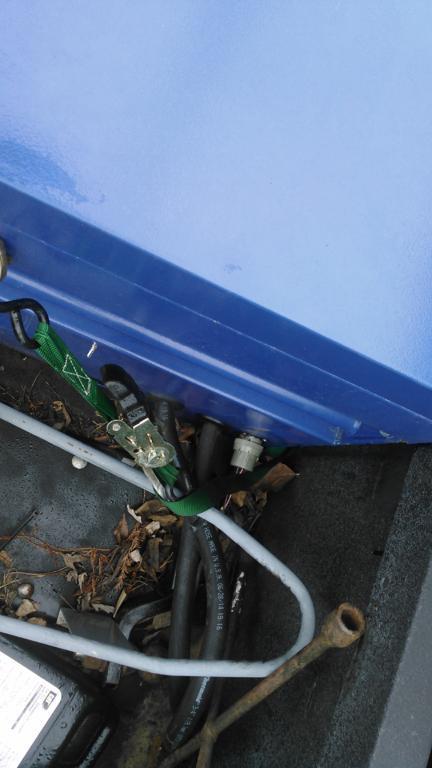

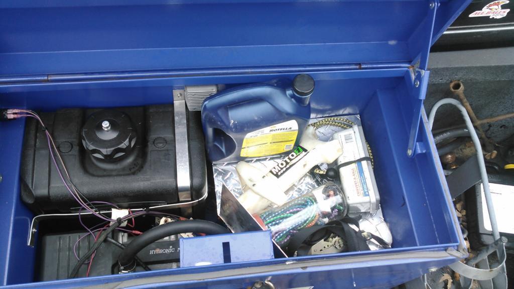

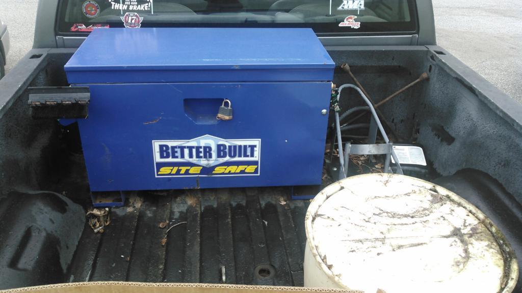

If you look at a connection per connection basis, it's hooked up correctly. But as per location on the truck, I'm way different. I mounted in the truck bed in a knaack tool box. I have a 7 gallon fuel reservoir mounted in the tank. Everything is in there, right now, including the 12v battery, and 12 to 24v converter. The only thing running actually connected to the truck is the water lines. I ran them through the bed, below the cab and up to the engine bay. I used a one way check valve and plumbed my espar lines into the heater core line. When the espar runs, it can't flow backwards because of the check, but when truck runs and not espar, it "should" pass through the check valve and not push coolant through the espar. That's how I imagined it, but no guarantee that's how it's working. It may still flow though the espar if it's least resistance.
In case someone is wondering, no I didn't go buy a kit. I work for a Cat dealer and we had to remove a few of these good working units. I went through our wiring schematics, and parts manuals for the installation on a machine and mimicked the installation. It's push button switch, so no timer is used. Too bad, because I'm reading that those timers are also code/fault readers. I bundled everything in the box and put it in the truck bed because I didn't like the under the cab option. Like we've mentioned, it's way too large of a heater, so mounting under frame was a little bit of a burden. And I'm picky about salt and snow, and didn't want it getting all the winter time road debris.

Some people like what I did. Some people think it's pretty dumb, lol. But all in all it was a project I wanted to get done because it was on my mind for four years and I'm happy as can be with it. Sometimes I get some faces from people walking past my truck in the dead of winter and hearing this loud "whistling-whooshing" sound from the truck bed. (I never got around to installing a proper muffler, lol). But it's worth it. The right people question it, and it sparks great conversation. Ill try to put some picture up of the install, never used pictures on the TDR yet.
The reason for doing all this in a tool box was for easy removability; if I didn't like it, it didn't work, and it wasn't permanently attached underneath the truck where it would get road debris and salt on it.
