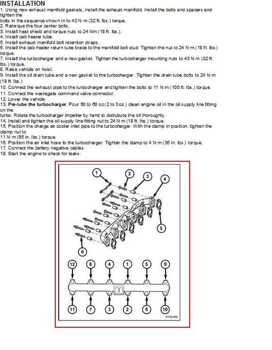

I'm attaching a copy of the manual section that spells out the steps for torquing the manifold. A old standard in torquing a manifold is to do it in sequence as shown but also do it in stages. First, torque all to say 20#, then go back over, in sequence, to 25#, then up to 32#. Then I'd go back over them all at 32#.

I got those instructions while I was at the dealer. I followed them exactly including the torque the four center ones again.
