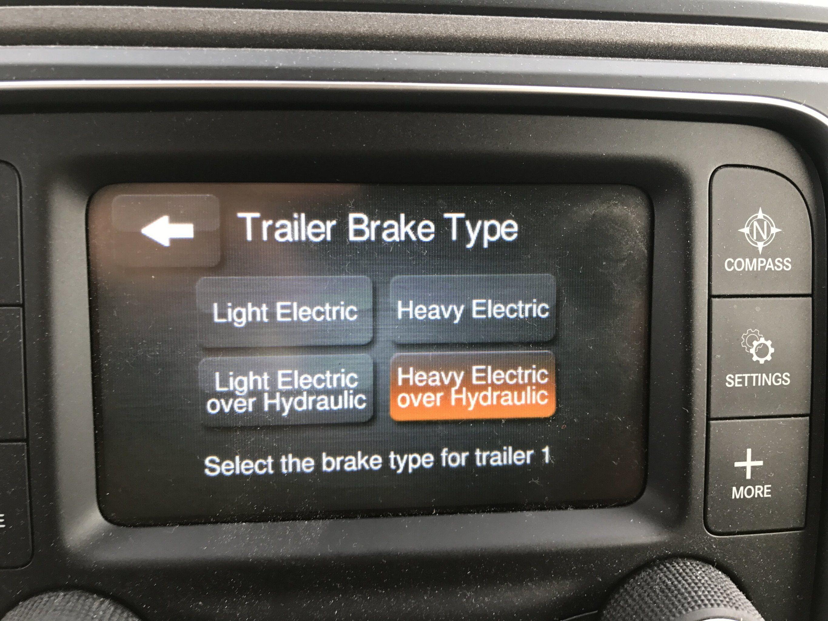

Yep did that when first hooked up to trailer . On light setting at Max , barely enough . I think what I need help with is after setting it up for light mode how do I get to heavy setting

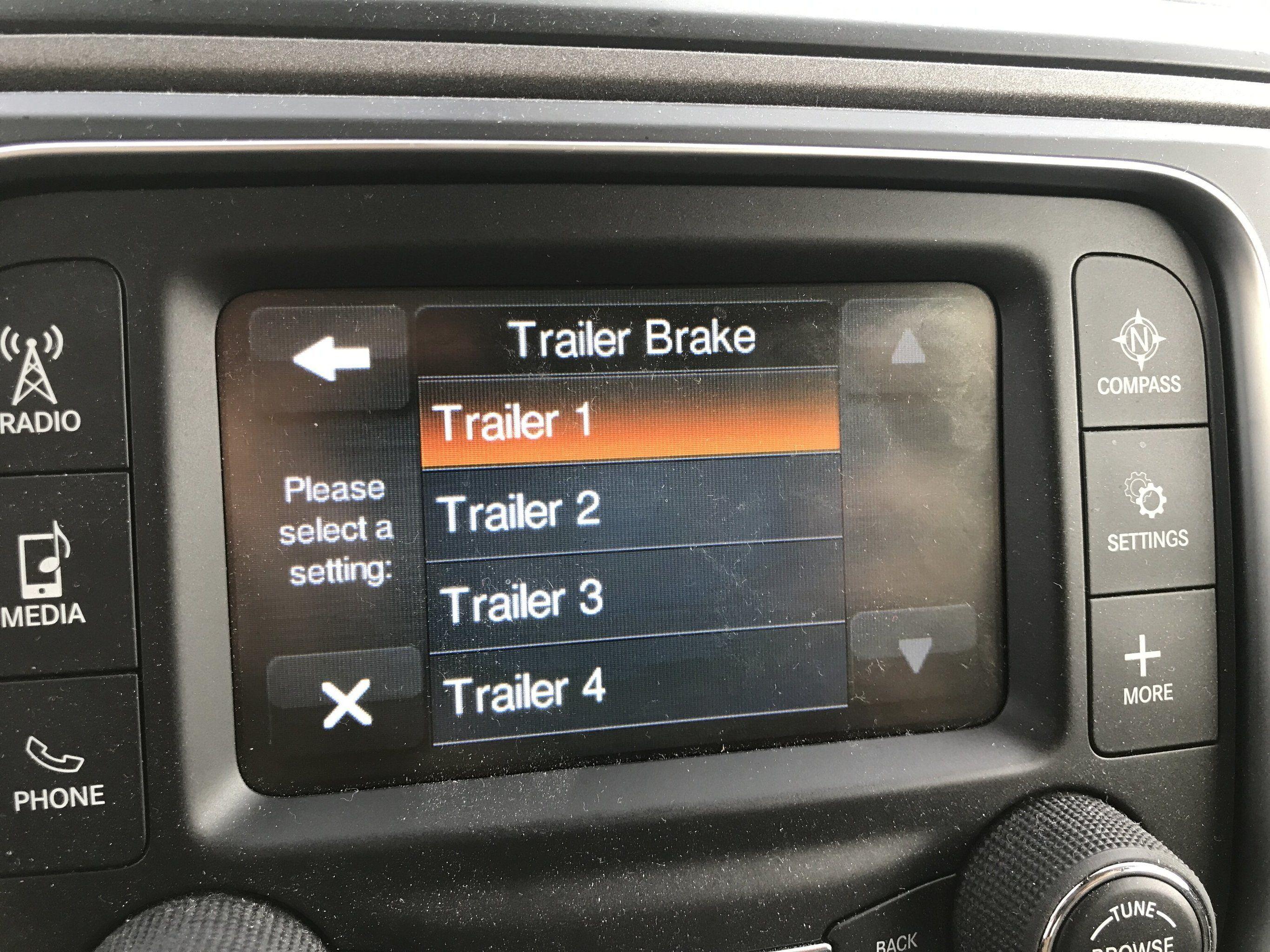

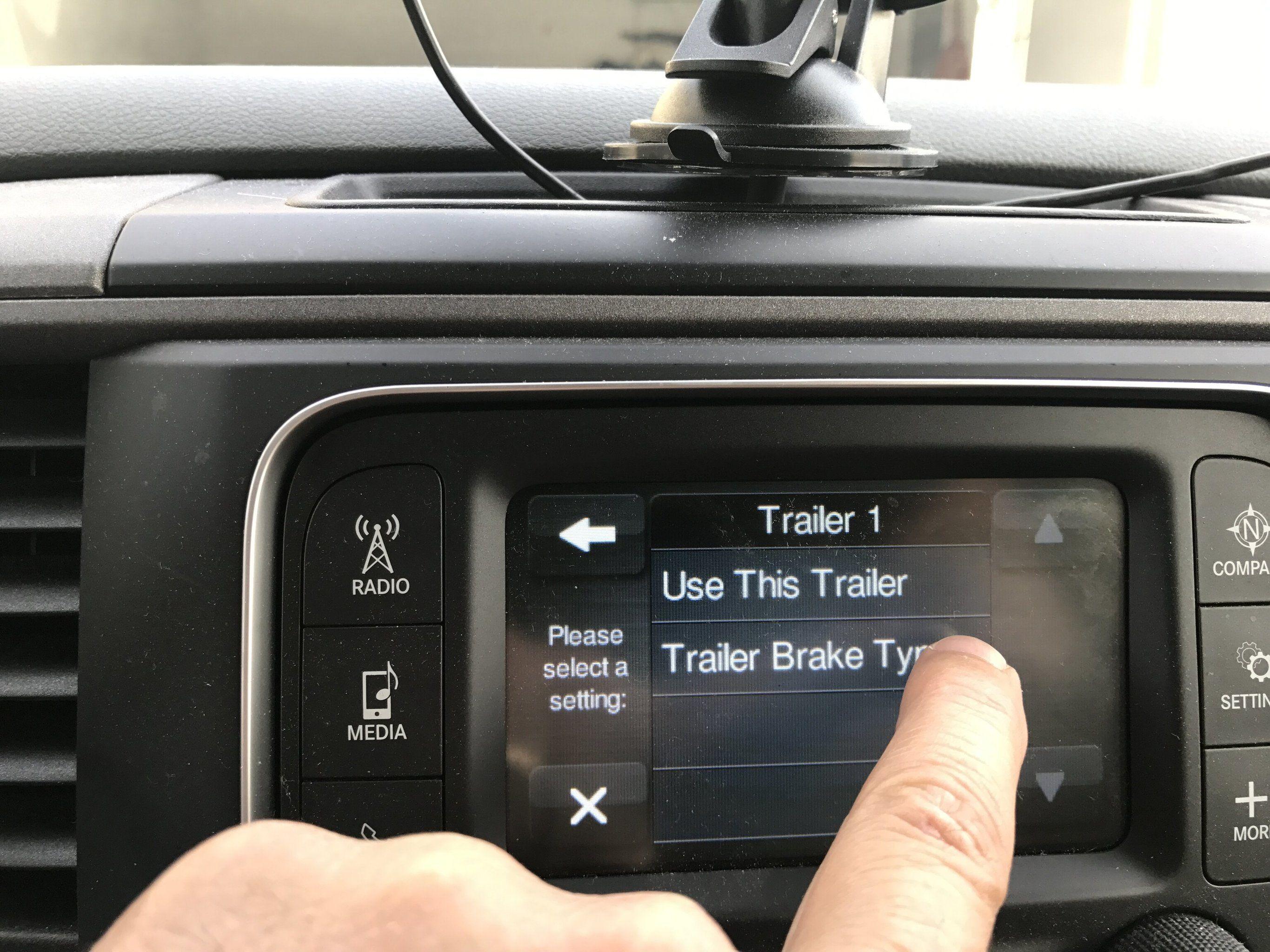

Maybe I don’t understand exactly....but I took these pictures.....
Thanks gsbrockman . I was trying to change settings using the readout in dashboard . Now trailer in storage will have to wait sometime to hook up . Hope I will remember next spring how to change settings . Thanks again ,,,, ,,,,, love this forum , and just confirming

Ok , gsbrockman another question .
Heavy electric
Heavy electric over hydraulic
What is difference?
Have electric brakes on trailer
Have hydraulic brakes on truck .
Which setting to use , next spring ??

Electric over hydraulic is hydraulic brakes on the trailer. Only difference is it doesn't send a check signal which typically damages hydraulic actuators. Otherwise no different.

Sooooo, if trailer has electric brakes , then use heavy electric setting?
