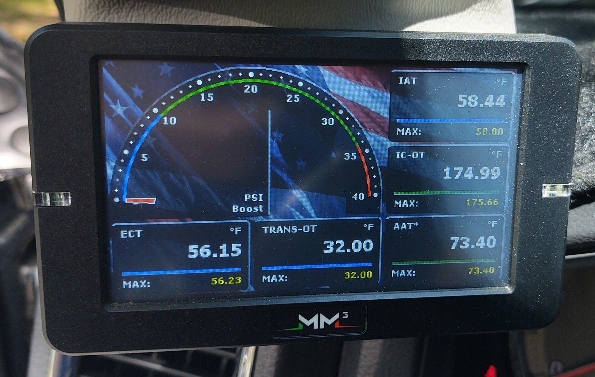

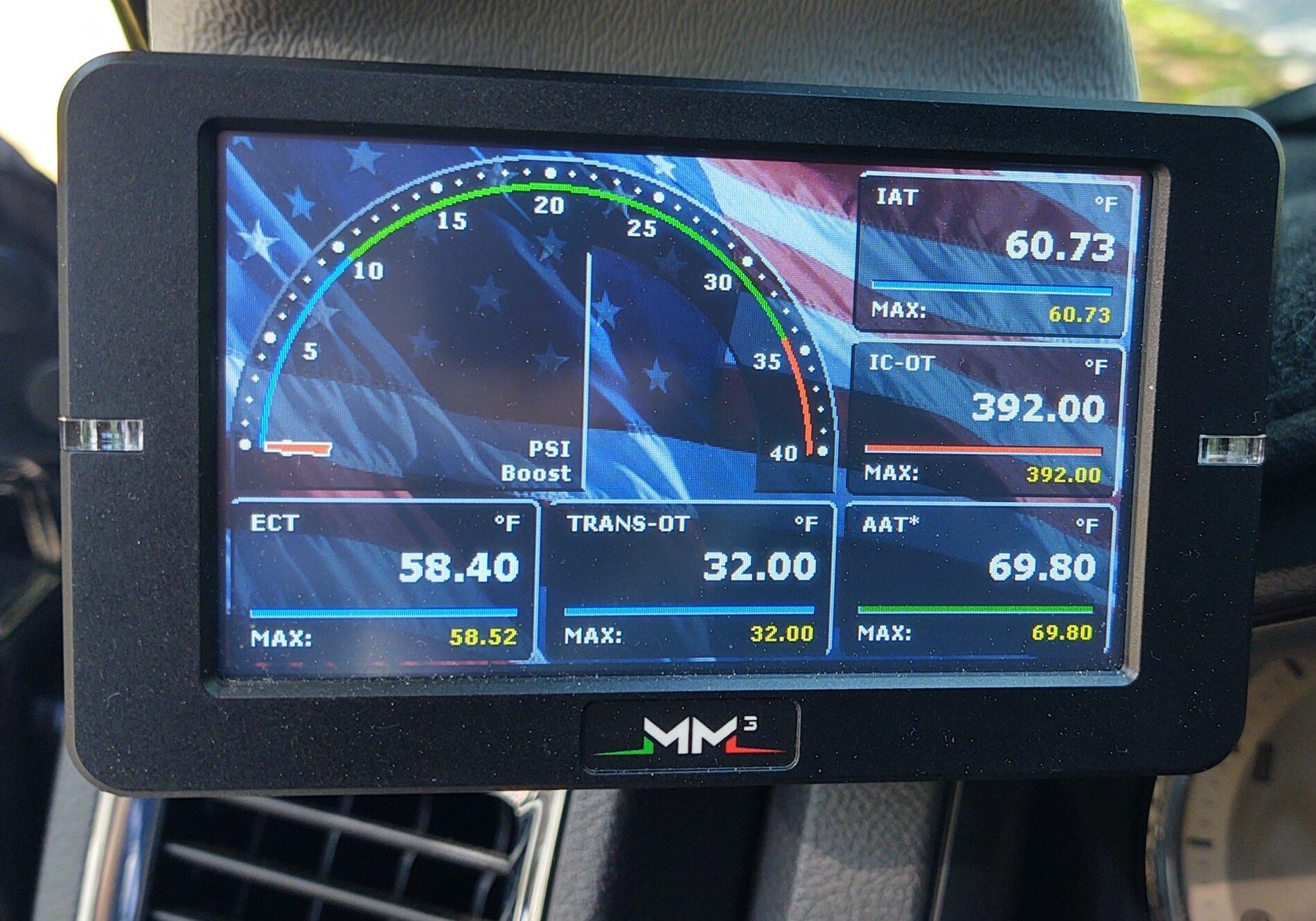

You were showing a high temp while everything is cold reading on one. Was that a calculated reading?
The trans sensor showing 32F - does that ever change?
What is the ac pressure sensor reading?

The trans the always read lower than ECT.

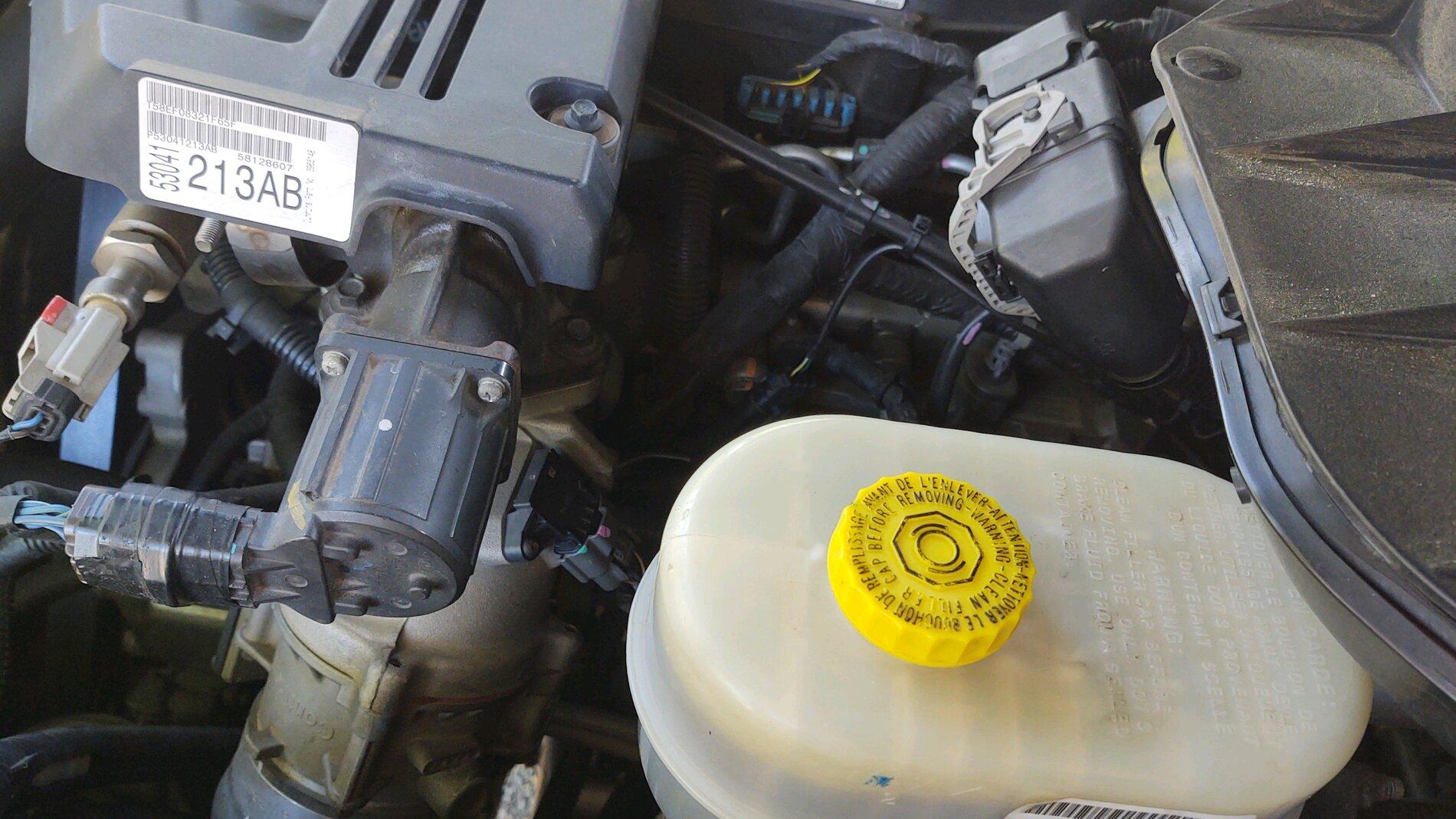

On the MAP/TEMP sensor, after testing the wires with a meter I found no issue and the temps still read over 200 degrees.
For a test, I cut the TEMP sensor wire on the connector and wired in a 2.2k resistor which brought down the reading to about 10-15 degrees above ambient temp. Much better then 125-200 degree over ambient. Also checked A/C pressure using my manifold gauges. System showed 38 low and 260 high and outside was 91 degrees.
