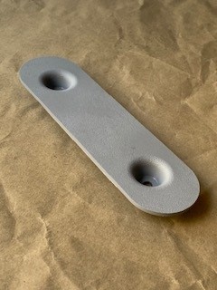

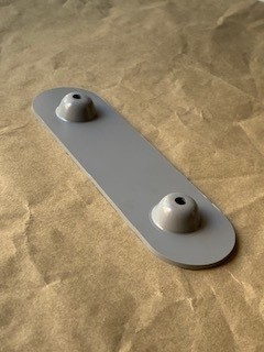

Yes, it's fairly easy accessible from the top. My profile goes over the full width of the insulation and keeps it up there.
I did the same underneath the truck but used the stems already there, they have Metric Thread on them.
I formed some Kydex in the oven.
Then drilled holes in the center of the rubber plugs at the bottom of the cowl plenum. (after removing them)
(They are used to access something at the back of the head, I think…)
The dimples are deep enough to snug the screws (M5?) and not crush the insulation.
The screws are in the rubber plugs (through bolted with lock nuts) to reduce sound transfer into the cab.
Cant find that in "your profile".
I guess you mean you have a "how to" write-up with pics somewhere ?
No just my english isn't that good, im not a native speaker.
In German we can shorten sentences to a good amount if something was mentioned earlier. Gives a faster conversation.
I meant that the aluminum u-profile i used is about 2 feet long and holds up the insulation full width under the cowling. I liked that idea better then just a big washer.
