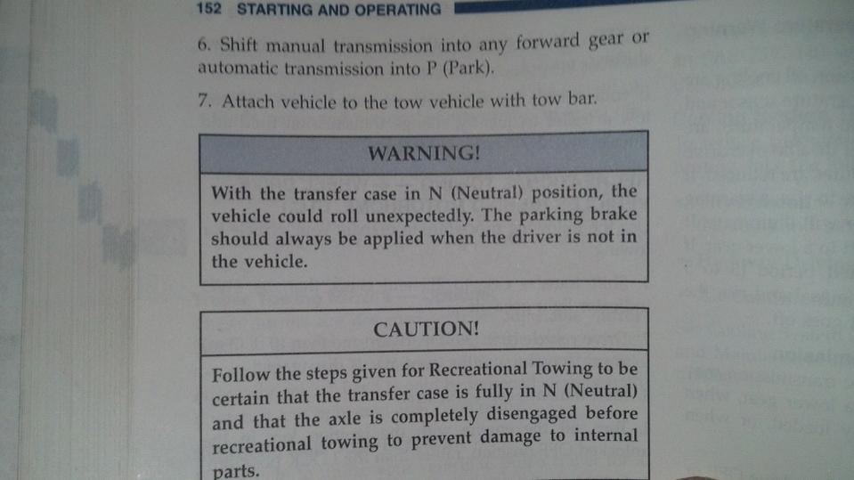

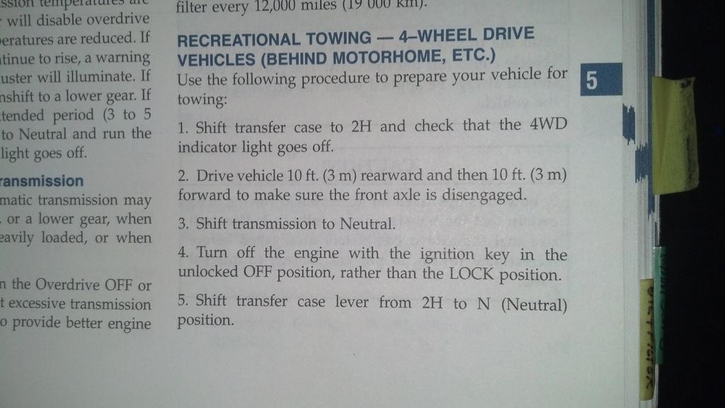

From the 98 book
View attachment 90932 this is in book for The 98
That's for 4wd. I believe the OP had 2wd. Does it say anything about flat towing a 2wd? I'm thinking that could potentially be a show stopper since there's obviously no transfer case and just having the transmission in neutral usually isn't enough because the output is still spinning. Unlike most transfer cases which are just lubricated with slingers or by the gears just being submerged within the transfer case, an automatic is lubed with a pump.
