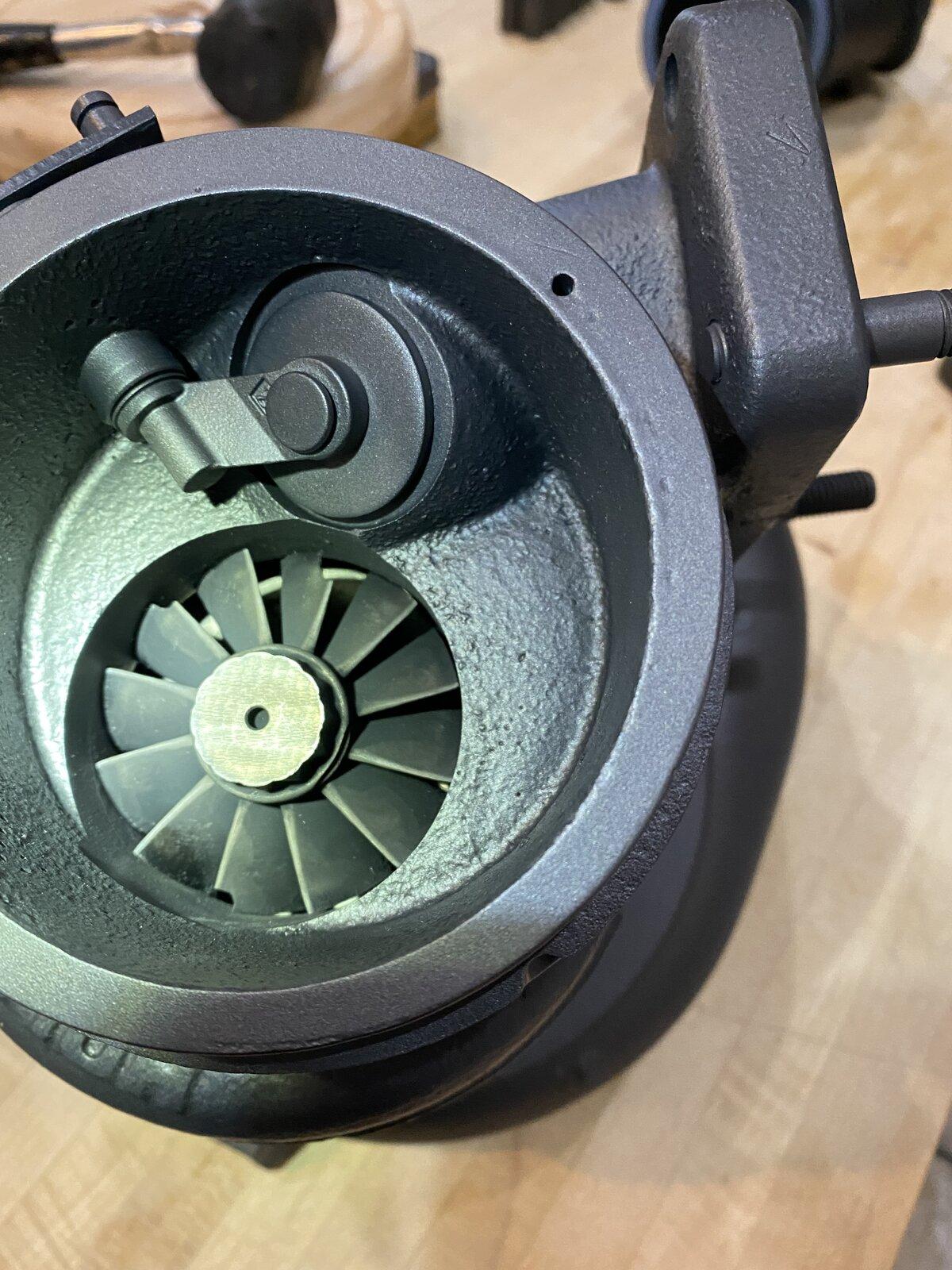

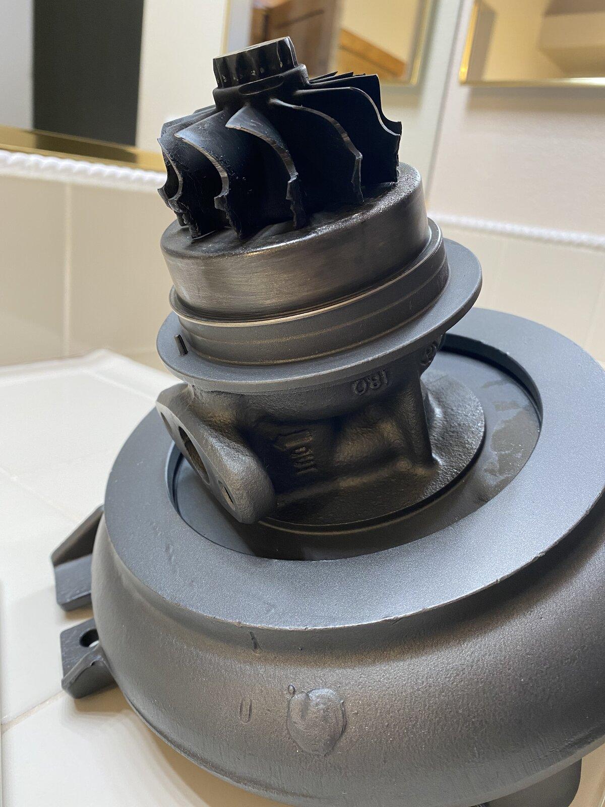

It was my intention to just reuse my turbo that I had upgraded by Turbo Resource (discussed above). However I did decide to paint the turbo and exhaust manifold before reinstalling. I found a local shop that does high heat ceramic coatings for applications including exhaust components including turbos. That required that I disassemble my turbo. The shop did a nice job and when I got the turbo back I started to reassemble the turbo and upon cleaning the turbine wheel of soot I noticed what appeared to be damage to the turbine wheel.
Here is another photo with the turbine wheel inserted in the exhaust turbine housing:
Needless to say I do not intend to put this turbo back on the motor without, at a minimum, sending it back to Turbo Resource for another rebuild. At the time I did the mild upgrade to my turbo I only contemplated injectors and exhaust manifold upgrades. However, the remanufactured motor has many more upgrades so I am now contemplating whether I should upgrade the turbo. I really want to stay with the Holset HE351CW turbo platform so my research indicates I have a few options. First, the following is the stock parameters of the HE351CW:

IMO I would outright replace the turbo or send it back to Turbo Resource for another rebuild. In case it wasn't pointed out: the turbo ate parts of the piston going through it. Damage to the housing and a bent/cracked shaft are possible. Warranty on turbo if it takes another engine out on failure vs. DIY is a good ?
You also need to make sure all debris are cleaned out of the intake and exhaust sides. Debris gets thrown around and the comparatively weak airflow doesn't stop it from going backwards in the intake from piston or valve motion. IMO the intake side all the way to the intercooler needs an inspection for debris. You may find other debris in the cat converter that I doubt would come back up.

Yeah this turbo will not go on any truck until it is rebuilt. I was going to call Turbo Re-source tomorrow to see what my options were.
When I disassembled the turbo there were no pieces evident anywhere. I didn't notice any scoring on the exhaust turbine housing. It wasn't until I cleaned the soot off the turbine wheel that I noticed the damage. I assume any pieces went downstream. I will check out the intercooler but I would note that the billit compressor wheel is in pristine condition and would assume that if any particles made it through the bearing housing, no matter how small, that there would be evidence of damage given how fast the compressor wheel is spinning. I will check out the intercooler (which I replaced after the first event) and was already replacing all the intercooler rubber sections.
I'm trying to wrap my head around how particles in the CAT could move back upstream in that environment? I guess I could unbolt it and shake it out to see if there are any particles.

As you ran the truck for awhile... The damaged turbo likely happened while it was wound up. Then at idle other debris can move around. Going backwards clean through the intake side: debris gets stopped at the intercooler before reaching the intake side of turbo. IMO you only need to look as far as the intercooler. I wouldn't think things could get back out of the cat, but, I wouldn't bet a turbo and engine on it. After all Nissan has the cats closer to the engine and when they fail debris goes back into the engine through the exhaust valve, scores up the cylinder till it pops a rod, and then the massive oil leak from the popped rod on the cat burns the car to the ground.
