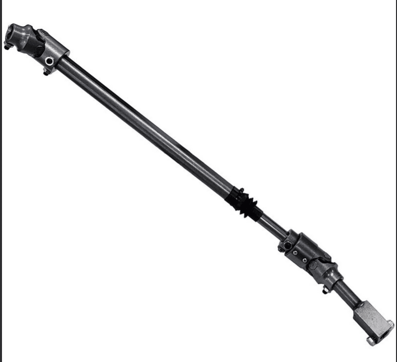

I highly recommend to NOT use the Borgeson steering shaft. I installed one and then removed it 153,000 miles later. Wished I would have never installed it.
Here is what I wrote in my maintenance log after I removed the Borgeson steering shaft and replaced it with a Dorman OEM style 153,000 miles later:
Replace Borgeson steering shaft (still operational). This shaft is poorly designed with 10 set screw / jam nuts to hold parts together, which makes it a high maintenance item. Set screws are difficult to inspect or to tighten after the installation of steering shaft. The slip joint offers too much friction and has to be disassembled to grease. After driving a few thousand miles, the slip joint gets sticky and affects steering performance and needs to be cleaned and re-greased - not a simple task. It took 25,000 miles of driving the first time to figure this out. I also feel that set screw type clamping pulls the clamped components off-center, which is felt in the steering wheel.
The Dorman replacement steering shaft appears to be of very good quality. Only two OEM style clamps for installation (keeps components centered) which makes for very easy installation / removal and is virtually maintenance free. The rag type joint removes vibrations transmitted from the road. This shaft is quiet and very smooth - far better than the Borgeson steering shaft.
The Borgeson shaft cost $270.00; the Dorman shaft cost $127.00. Sometimes I learn the hard way.
I think this is the Borgeson steering shaft that fits your truck. Note the 7 set screws with jam nuts. This method of clamping will not be your friend.
