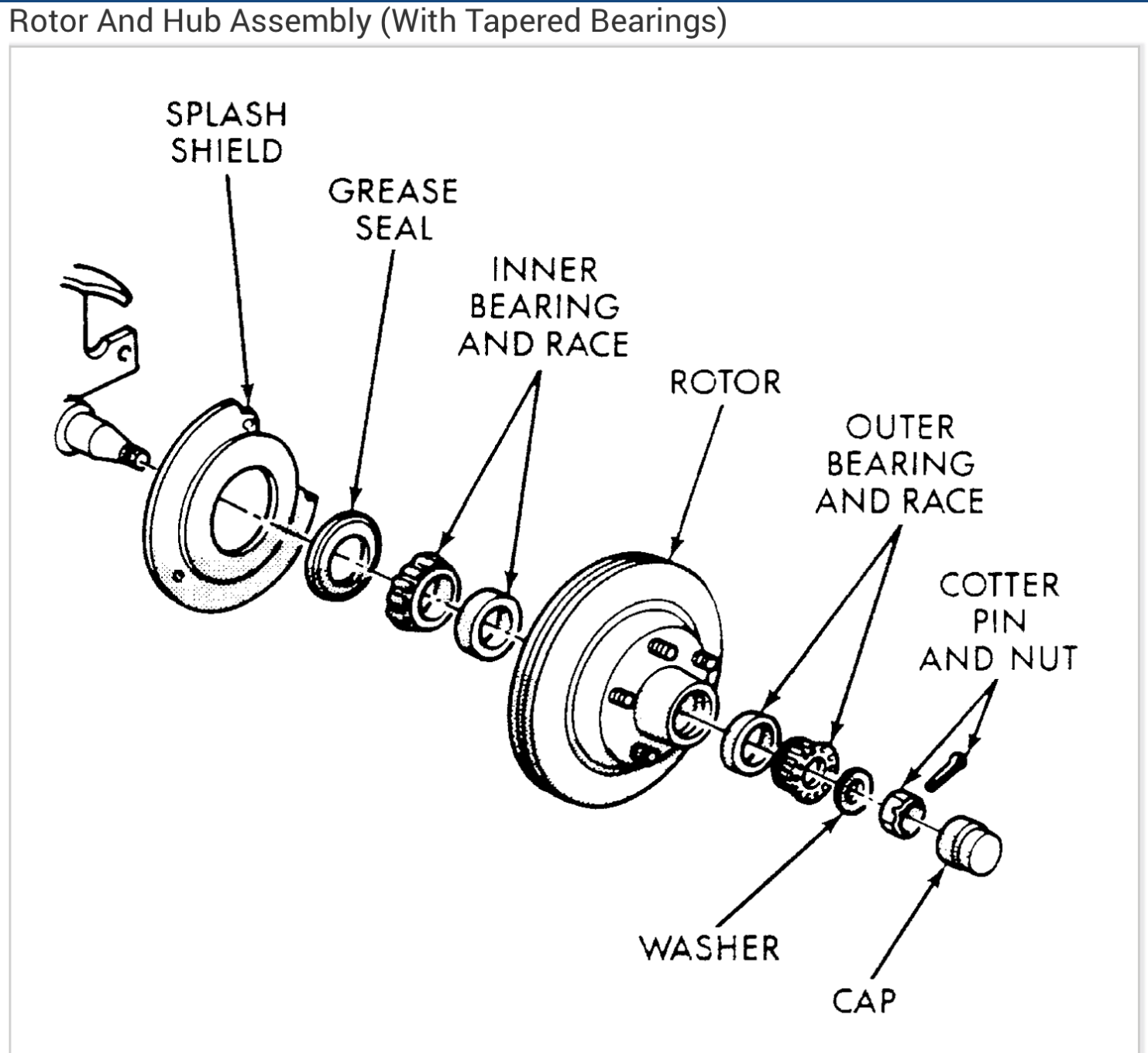

So he brings them and sells them to you with a markup from his price or does he just recommend them? It's immaterial if they are factory original. If they are serviceable all they need, at the most, is bearings and races. If the existing bearing and races are still good all you need is a re-pack of the bearings.
Aren't we talking about Inner and Outer Wheel Bearings and Rotors or do the 2nd Gen RWD 3500's use hubs like a 4X4?
Lots of talk about "Hubs" in this thread....
That's new to me, thanks for that information.
So every time the rotors need replacement the hubs are part of it.
That is really a special way of building brake rotors so to say.
That’s the way most all RWD vehicles USED to be. Some, like newer F-150’s, now use a hub like 4x4’s do. That way the knuckles, rotors, hubs, etc are the same for all of them.
I’ve just never heard them referred to as “hubs”, always just rotors and bearings.
