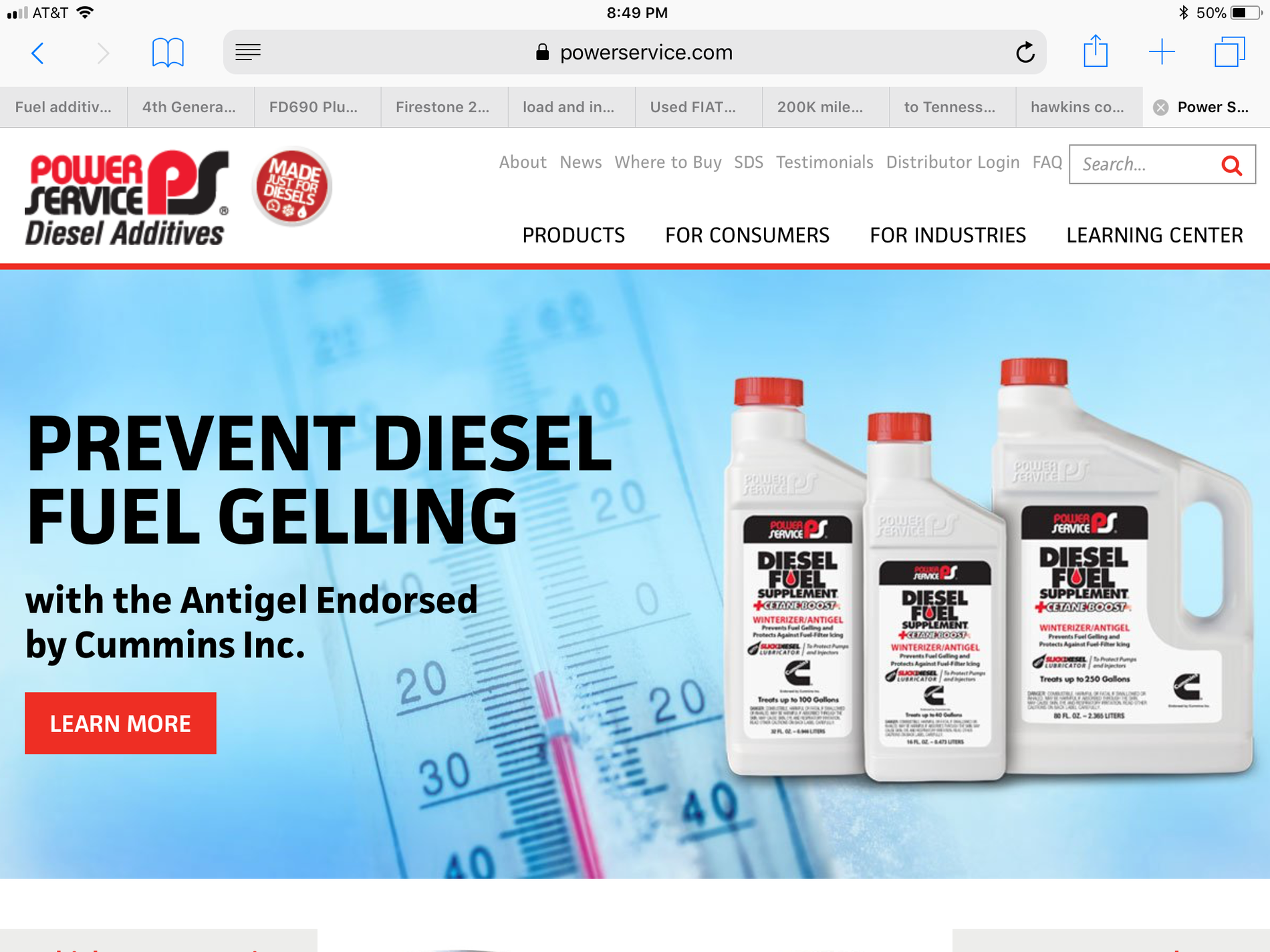

Well.....as of recently, Cummins has been OK with Power Service in regards to promoting their product.
Required? No.....
Endorsed? Yes....
Who warranties the RAM engine? Not Cummins!
Who do you think steers the recommendations on oil viscosity, service intervals, etc. Definitely not Ram. If it is being endorsed or recommended there is merit, that is for sure. The ad specifically calls out fuel gelling as a concern, for those that live in climates that have wide temperature swings it is a real problem.
This is something that Cummins has recommended for a long time. Just because Ram doesn't necessarily promote it really only tells me they're only concerned about getting you through your warranty.
https://www.google.com/url?sa=t&sou...Vaw00AHKWJAUVFSlahhVQDWUb&cshid=1551016750333
I believe you’ll find Cummins recommends Power Service for the same reason it endorses Valvoline Premium Blue. It does no harm. It performs as advertised and Cummins has a marketing agreement with the company. That includes display of the product in a prime location at the dealership and favorable pricing for Cummins.
I think the Business Wire article misrepresents the facts. Reading their literature I can find no "recommendation" to use additives. They just put the Fleetguard brand on theirs, so they sell it. Now they sell Power Service. I suppose that having an interest in the product is a tacit recommendation, but as jhenderson pointed out, it is marketing. How many of you don't use Fleetguard filters or Valvoline Blue and don't think a thing about it? https://www.cumminsfiltration.com/sites/default/files/LT36503.pdf is a link from their Power Service page. https://www.cumminsfiltration.com/additives
