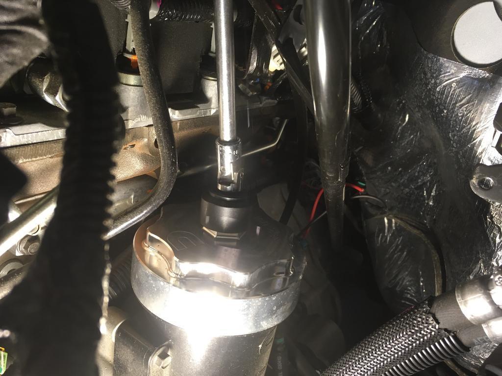

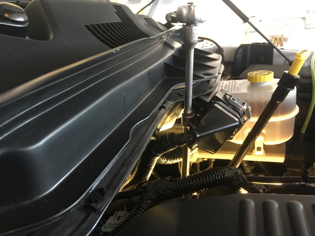

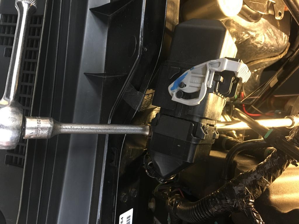

I just changed mine for the second time and it was just as hard as the first. I tightened it to the proper torque the last time I changed it and even put a light coat of grease on the O ring. I thought sure the cap was going to break just before it broke loose.
I use a universal joint and a long extension and I use my long handled torque wrench to remove and install the cover.
The O ring swells and causes it to be very difficult to remove the cap. Not how tight it was installed.

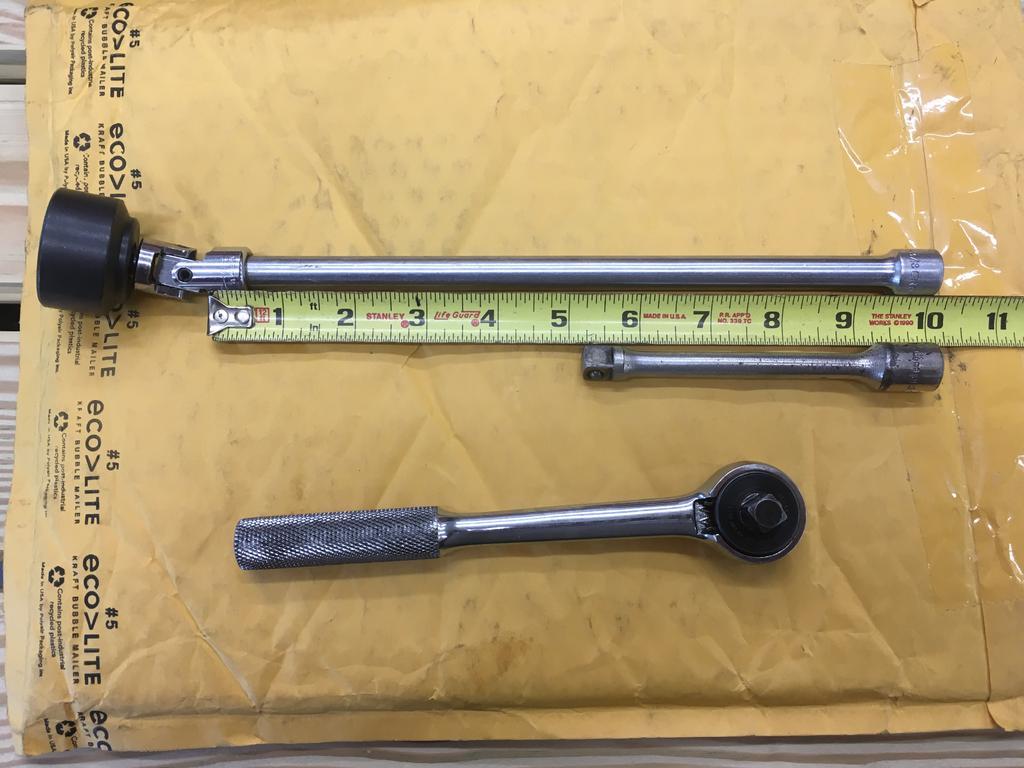

My tools: View attachment 97391
That little ratchet does not give you much leverage.
