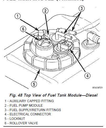

HH, I think the tank vents negate any need for a vented cap. They should be open all the time unless in a roll over condition. There is no vapor recovery system on a diesel which is the only reason to have a vented cap.
IIRC there were some tanks collapsed because of a red cap on the tank vent from the factory. bg

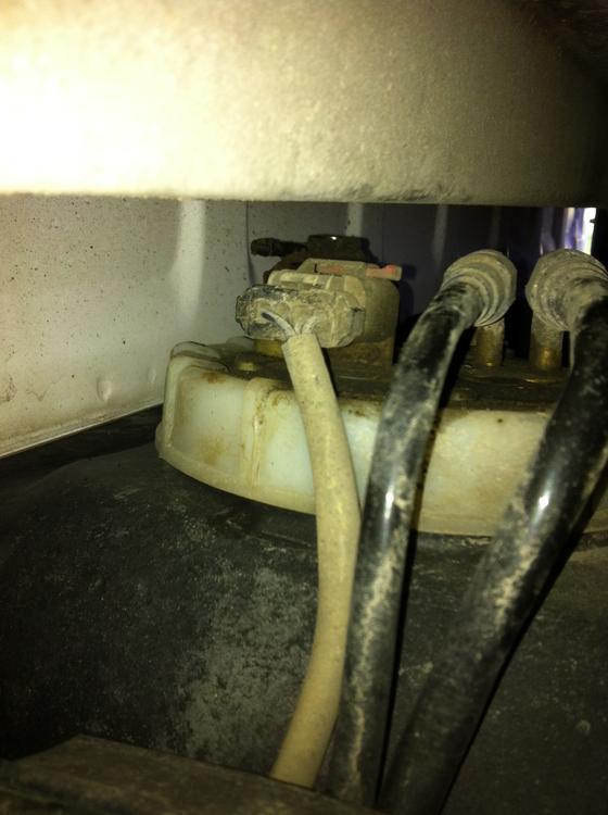

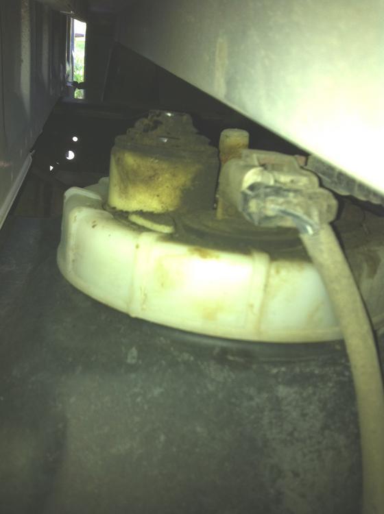

Mine was one of them. Dealer did not remove the red vent cover from the factory resulting in a collapsed tank and premature demise of the lift pump. Got both replaced under warranty. This was on my '98. 5. Prior to this,everytime I loosened the cap I got a vacuum coming off the tank.
I was able to find the answer. Cap is not vented because of the rollover valve on top of the tank - I always fill my tank until I can see diesel and never have a leak, so the floating valve must be stuck and I got a vacuum problem. I will be drilling a 1/16 inch hole in my cap.
The rollover valve on my 99 got clogged up with junk and I could hear a hissing noise coming from the cap, sounded like the tank was collapsing. Got in there and cleaned the valve out and solved it. I tried the vented cap and it didnt really change anything for me.
