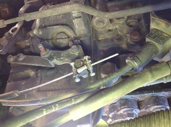

I did the solenoid delete and it's worked great. I installed a pto cable through the firewall just in front of where your right knee would be sitting in the truck. Took the whole fuel shut off solenoid out and used some cable clamps to hold the pto cable to the fuel arm. So far hasn't vibrated loose. No welding here. I got the idea from a tdr issue (don't remember off hand which one). I can post some pictures of what I did tomorrow.

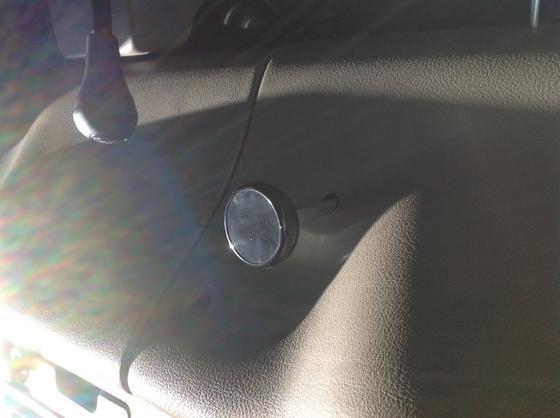

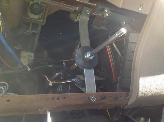

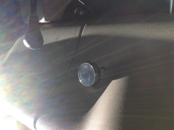

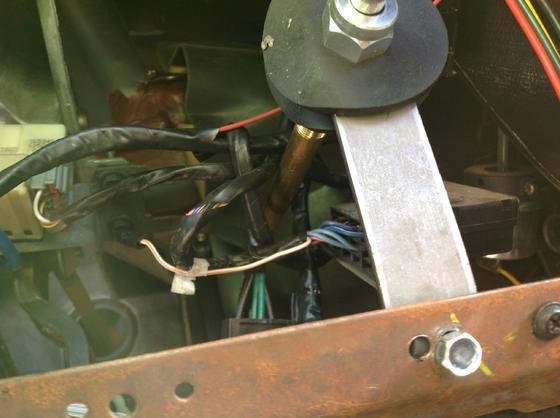

Here are some pictures of my cable install
Pic of strap that cable is mounted to. Used large rubber washers to isolate vibration from dash. Sorry pics are upside down not sure why.

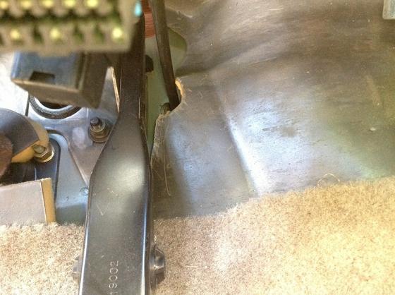

Pic of cable going through firewall. Drilling the hole though the firewall took a little bit. The pto cable was 20 dollars I think from aw direct. Nice thing is they were only 15 minutes from me so I could just pick it up. I used a 10 foot cable and cut to length. Followed all directions in the tdr.
