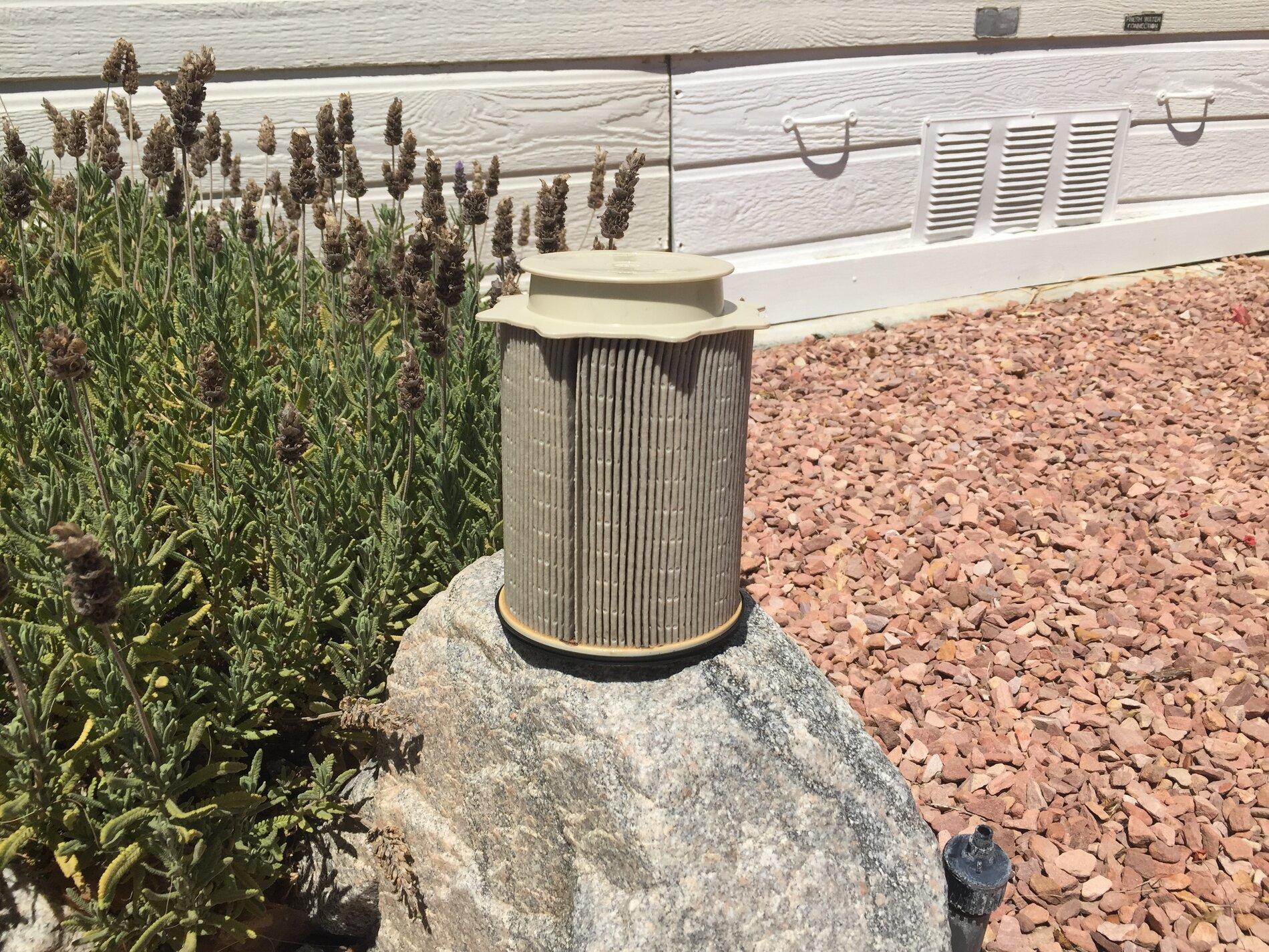

Engine mount always looks good at 15k. Really impressed with the RACOR primary filter.

My front filter always looks that clean. I'd bet that front fuel filter can go another 10,000 miles before changing out. But I don't buy scratch off's or take trips to Indian casinos's either so what looks like a perfectly functional filter gets changed with the rear filter.
