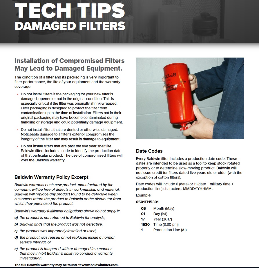

Filter makers state the shelf life VERY CLEARLY when you can find it. Baldwin 5 year shelf life example attached. They will also not warranty a filter used longer than a normal service interval and in the case of 6.7 Cummins RAM fuel filters this is ONE YEAR clearly stated in the owner's manual.
I have gotten my money back from shop.cummins when they sent me aged out fuel filters for a vintage Onan generator due to Fleetguard's 5 year shelf life policy. I have had to order Baldwin filters due to said bad habit of shop.cummins to get filters that are not aged out.
Congratulations, you found one example of shelf life from one manufacturer which amounts to them not warrantying the filter if it is older than 5 years.... think you can find another example from a different manufacturer?

well, so far I learned from you that Baldwin doesn't warranty their oil filters 5 years after the date of manufacture.
that seems to be about as far as it goes for anything in writing.
I actually have been looking to see if any other company says anything about shelf life and basically it seems to be a moot point or it is so obscure a data point that subject doesn't exist except on forums and places like Reddit..

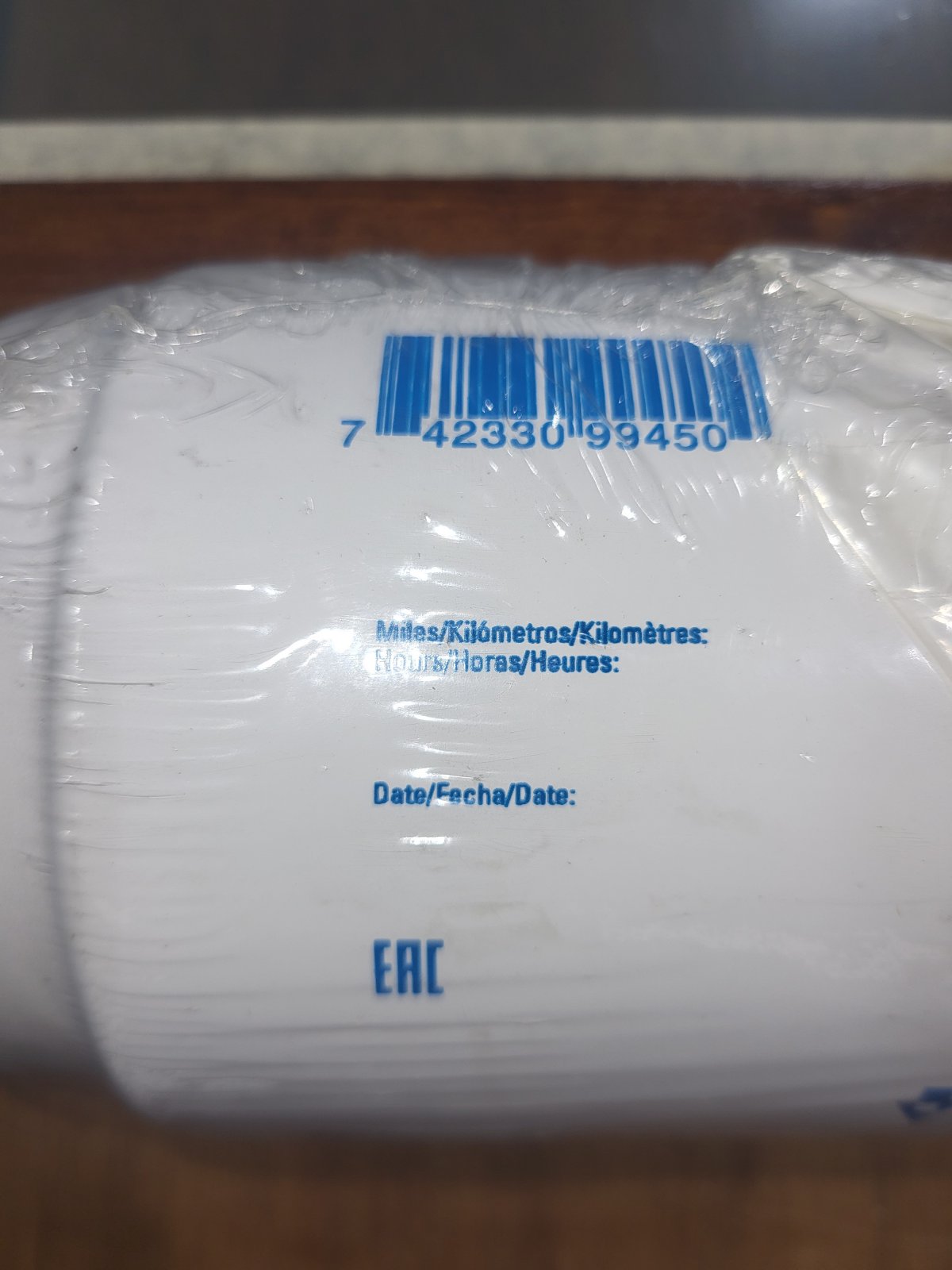

How does one know exactly when a filter was manufactured? I just looked at a new FS53000 and don't see any dates. There does appear to be some type of code on the top of the filter that I can't read without removing the sealed plastic.

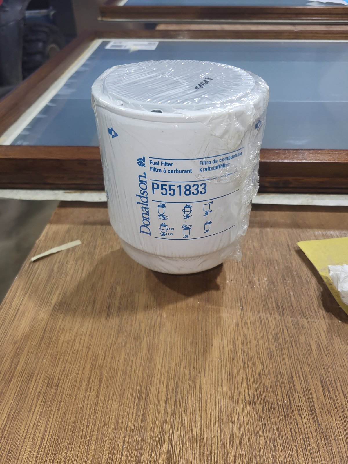

Then there is this Donaldson primary. No mystery numbers anywhere.
It does have a clearly marked spot for noting in service date/mileage.

yeah, lot of food stuff says Best if Used By... doesn't mean its spoiled but common sense should prevail. I think in the case of an oil filter there is some common sense in that little article, do not use it if it is dented or rusty , or if it has been removed from the packaging for a long period of time, same as on a can of food.. anyway, it isn't something I am going to worry about.
