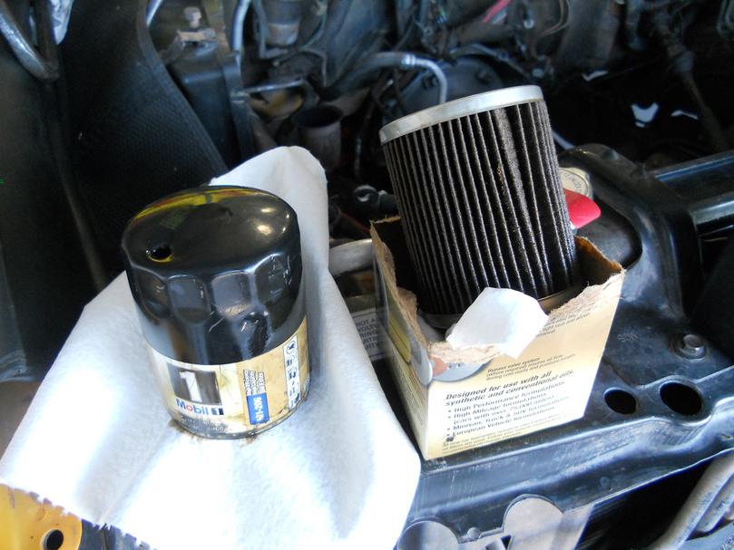

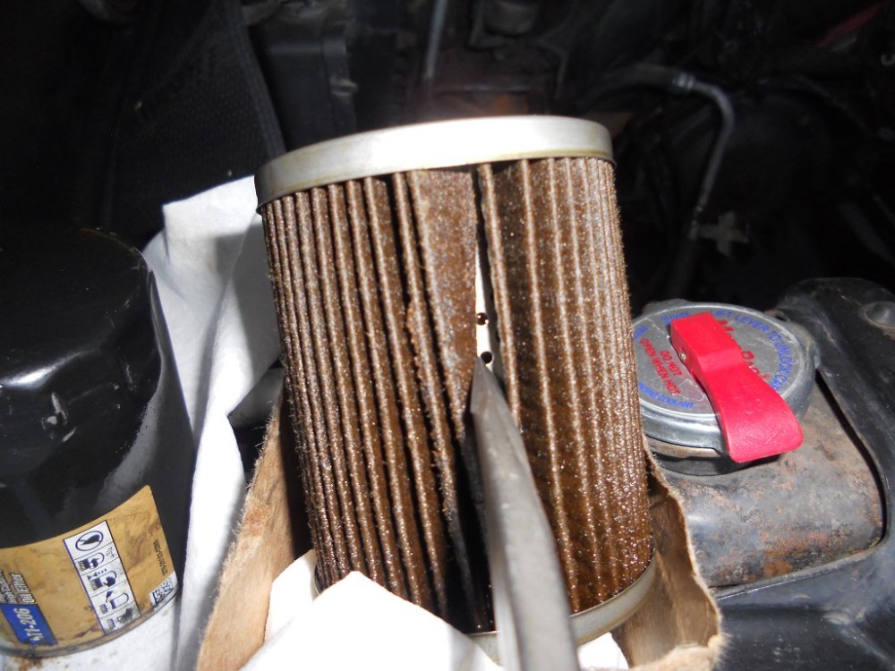

I have opened up many filters and found manufacturing defects where the filter is bypassed. Consider the Bad Rash all over the internet of Tear-O-Later filters that are known to fatigue fail in use with torn pleats.
Imagine using this defective filter past it's warranty date even after being vacuum packed for long term storage.

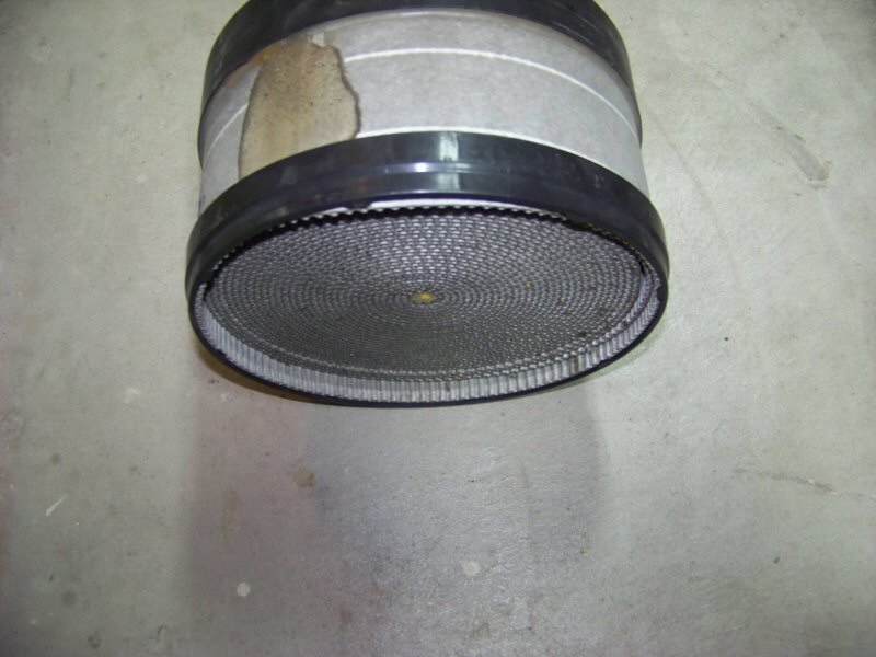

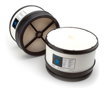

Maybe you got hold of a old filter design like a Donaldson air filter for a 2008 Duramax. They redesigned this air filter with a "X" cross stop as the filter glue would fail and the filter came apart.
Failed at 57K miles under one year old.
Updated design with a "fix".
