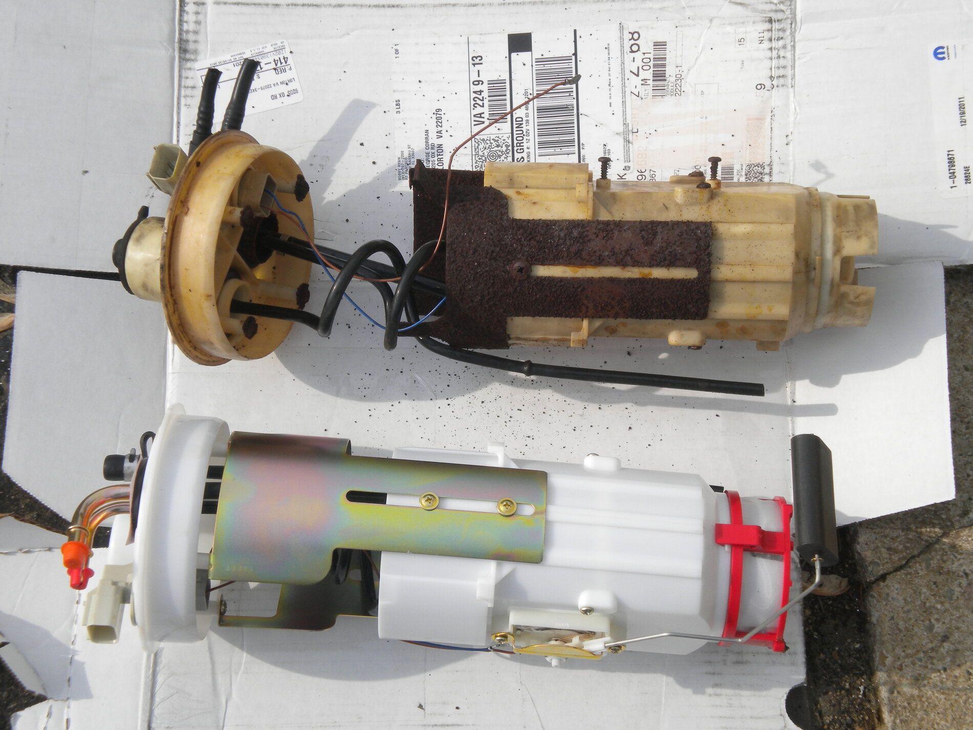

Well, after two weekends of misery and getting drenched with diesel, I got it done. Pulling out and replacing the sender wasn't a big deal. The retaining nut and gasket were in good shape, and the sending unit cartridge showed no trace of rust or corrosion. That was the only really good part.
The original plastic fuel line had been pinched against the frame rail on the assembly line. Time and heat had set the pinch into a permanent bottleneck, which might have explained some of the slower uphill performance while towing and feeding from all the main tank. (The auxiliary tank wasn't affected.) Almost all of the rubber fuel lines had hardened to the point of being brittle. So replaced the majority of the long runs with steel tubing with rubber hose connections. The 5/16 inch quick connector at the top of the tank unit has not been properly pinned and it looked as if it was about to develop a drainback air leak.
Before undertaking the job, I bought the least expensive Harbour Freight transmission jack and their 12 volt diesel transfer pump. Both tools saved me a lot of time and worked really well. The main tank was of course the full one. So I pumped it into the auxiliary tank. When I had finished with the sender job, I pumped the diesel back into it from the auxiliary tank. (That makes it seem easier than it was, because the suction line won't snake into either tank. I had to remove fill hoses to make it work.)
