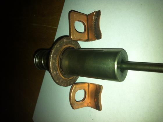

As I just experienced the 97,000 mile starter contactor issue and replaced just in time. :eek:
I trust you cleaned up the plunger contact disc - on the GM solenoids I've worked on, you could remove that disc, and turn it upside down for a new unused surface...
I just replaced all 3 items for ~$33. 00, but still have the old parts. I will try to reverse the disc for a backup. Nice idea.
