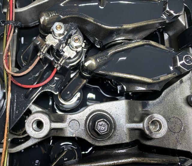

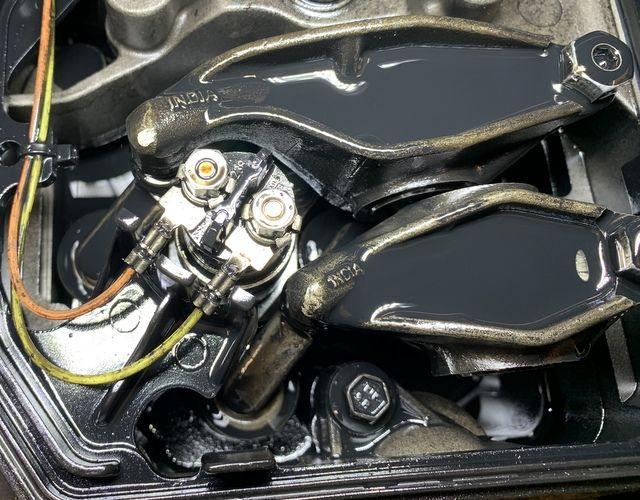

Another first timer question. Injectors are in - running smoothly. Went back and did valve lash - went OK - need to recheck after some idle time. But - decided to run the engine with the valve cover off and I noticed #1 and #3 intake rocker did not seem to be oiling the valve bridge like all the other rockers. Pulled them both off and cleaned the passages. Reinstalled and #3 looks fine but #1 still flows less. It looks like plenty of oil is coming up, the arm and pushrod are well oiled, the top of the rocker is filling just fine. I did note that it took longer for all the intake rockers to oil the bridges compared to the exhaust's - but # 1 is still lagging. This is a few minutes (<5) at idle. Am I being paranoid? Pictures with engine off don't do much justice but that #1 intake valve well looks pretty dry compared to all the others, and you can see a nice coat on the #2 bridge when compared to the #1 bridge.
#1 Intake
#2 Intake for comparison

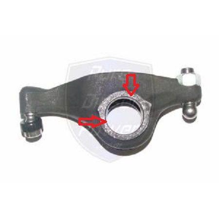

Each rocker is individually lube. Either the lube circuit has some blockage or the bushing may have some imperfection allowing seepage....take it apart and check for wear. double check the assembly of #1.
TC, I did disassemble and clean that rocker twice, all the passages are clear as far as I can tell. And like I said, the rocker shaft, and the pushrod are getting plenty of oil up through the rocker and out, so it's acting as if only the passage to the bridge end of the rocker is blocked - but I have cleaned it well. What bushing are you referring too?
Gotcha TC - thanks for the graphics. I did check that bushing and it fits tight and smooth (oddly enough #3 intake rocker/bushing felt like it has a bit of a bur, couldn't feel it with my fingers and it was tight - but not smooth). In any case I buttoned up the truck, drove a couple miles, opened it again and watched - now the oil is flowing just fine. So perhaps there was still something interfering with the flow, air pocket maybe, or it just wasn't warm enough. Quick oil change now in case any debris is in the system. Appreciate the help.

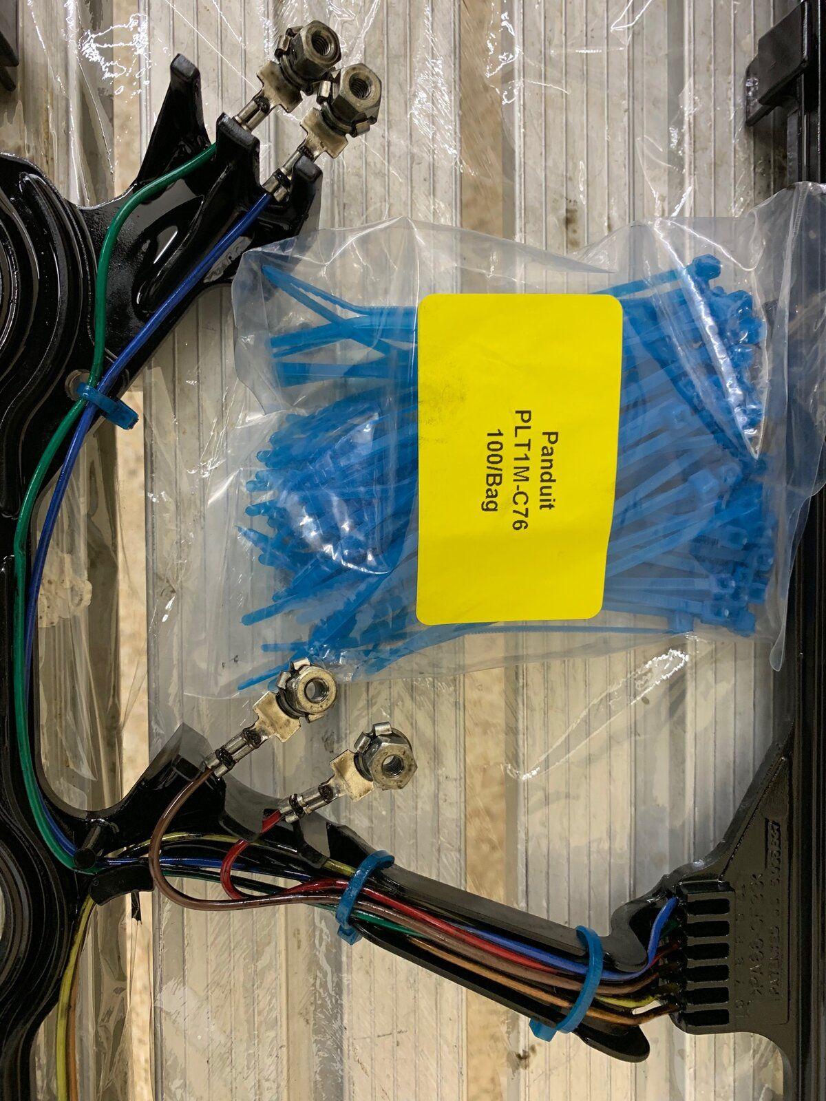

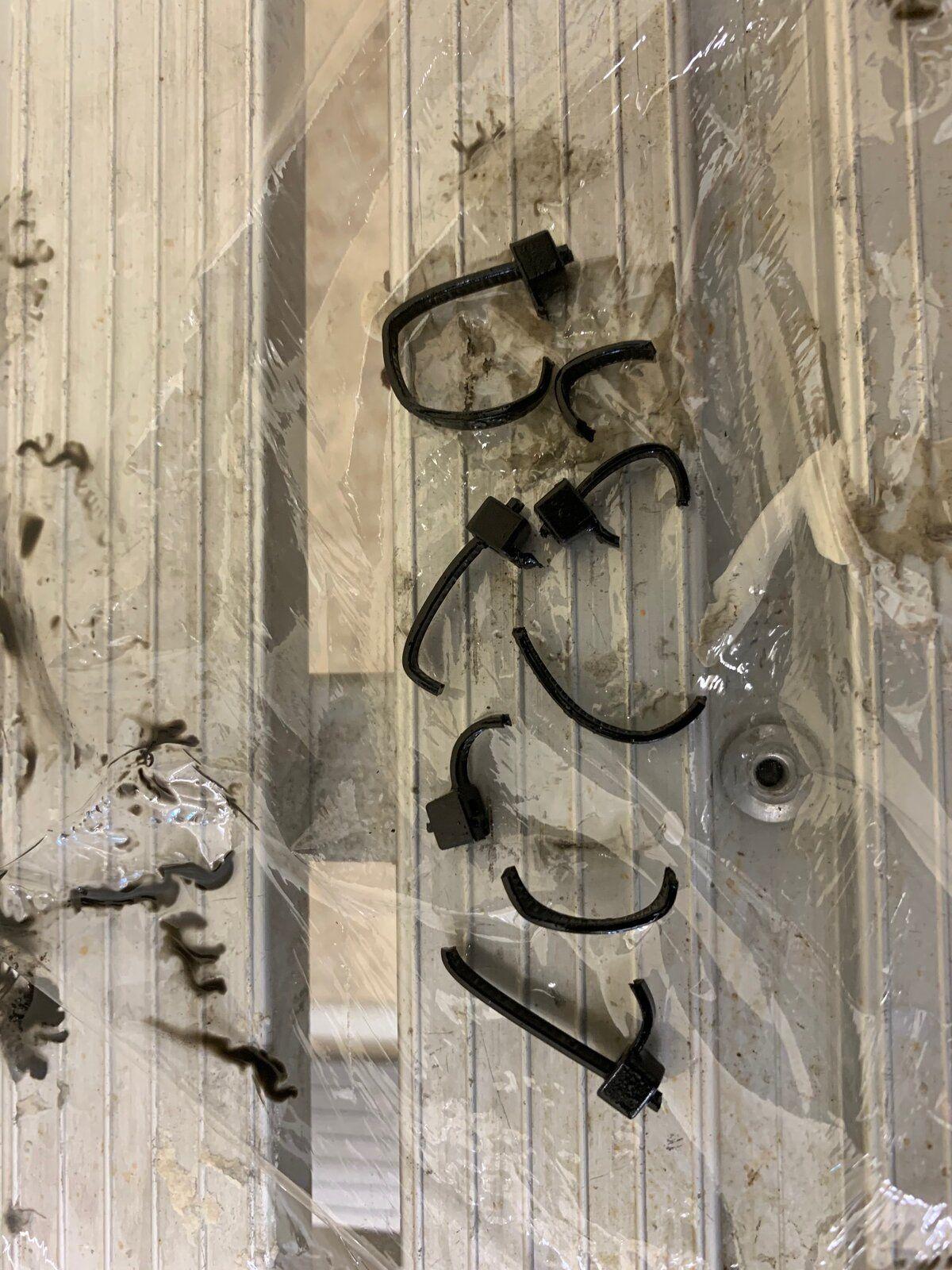

2) One extra little fun I had when putting the injector wiring harness back on, one of the little BLACK cable ties holding the wires to the plastic frame broke and fell into the rocker box filled with BLACK oil. I did not like the thought of that getting churned through the system but man was it hard to find, back on number 6 of course so I had to fish around blind to pull it out. When I did a little tugging on the rest of the wires I found that all of those cable ties were deathly brittle and broke at the slightest stress. Normally those ties never see any stress, but I caught a wire reaching in to #6 and that was all it took. Obviously the heat made the ties brittle, and I wanted to replace them with something better. Found some higher temp rated ties and tested them with a heat gun. Ties were rated to 338 degrees F, I hit them and some standard ties with a 600 degree heat gun. Both shriveled up, but the good ones did not become brittle, while the normal ties broke up like an old cookie. Pictures below of the factory black, new blue, and white test subjects. This is a quick replacement you might do next time you have the valve cover off.

I would, like it was shown the plastic ties gets brittle along with the insulation on the wires. For around $150 at Geno's its great insurance.
