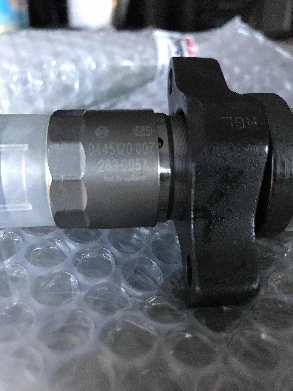

If you purchased MY4.5 injectors you should not have got the 007 injector as they have the MY03 spray angle of 143 degree.
If you need to proof that the 007´s are not for your application you can use the Bosch product search site
https://www.bosch-automotive-catalo..._p_col_id=column-2&p_p_col_count=1&autoLoad=1
At least you can find in the article desription that it is for 1400bar rail pressure and not for 1600bar.
If needed I can take a picuture of a OEM Bosch packaging as they come in a cardboard box

The main difference of the 1400bar setup is, that the valve spring force is adjusted to a lower value. So if you are driving at 1600bar the injector has less force left to close its valve seat.
So there is a high risc of longer and unstable injection events (bigger injection quantities and high shot to shot spread)
The risc is even higher if this is combined with some eccentricity of the grinded vlave seat to its diffusor bore. That eccentricity will cause side forces on the valve ball when it is opened causing misalignment and for that reason the valve ball has to slide eccentric into the valve seat during the closing process needing additonal force because of the friction between the valve ball and the valve seat.
Worst case is that there is a little gap left on the valve seat causing permanent leakage between ball and valve piece which will cause extreme hot spots and also abrassive wear.
Ouch!! That is disturbing inasmuch as it explains a lot of issues with low quality injectors.
I am guessing that this "some eccentricity of the grinded vlave seat to its diffusor bore" may also be a large contributor in lower quality remans with a lack of QC and attention. That combined with some less than ideal injector setup on the spring pressure is why we see issues with remans that ostensibly pass standard testing.
There are so many things that can be done wrong in the remanufacturing process if you do not exactly know what you are doing.
But that eccentricity is not one of them.
The valve seat is grinded into the valve piece at Bosch, it has nothing to do with the remanufacturing process as it can not be adjusted afterwards. But at all manufacturing processes are tolerances. Those tolerances are very small compared to any other product but they are still causing effects.
A coaxiality of 20micrometer on the valve seat is already a lot but would not cause any issues if the valve spring force is correctly adjusted for the pressure it is used.

so I just installed my id injectors and they are 007. I did talk to Andrew the owner of id. he told me that they put 143 nozzles on the 007 cause the 238s were on backorder and he says his bosch supplier assured him they are modified to work in the 04.5 to 07 trucks. but he did offer to swap out for the 238s if I want to since he says they now have them in stock. That being said I hope martin would answer if I will be okay if I keep these in my truck or is there still a chance of a problem?
