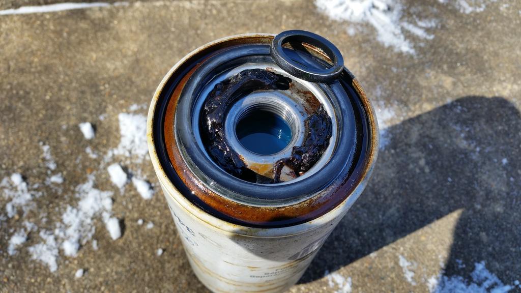

HI Guys,
My work truck, a 1997 Freightliner MT 45 (step van....5.9 cummins engine, 4 speed Allison ...19K gvw, 285K miles) is running VERY rough.....BY running very rough I mean it'll barely pull 15-25 MPH on the road at nearly full throttle up seemingly minor grades....all the while laying down a clout of whitish / bluish smoke (the truck does not burn or leak oil).
Yesterday it ran so badly I thought It would die out in the middle of the road but luckily it never did....I managed to limp it home....
The truck used to run pretty powerfully (able to climb one hill in particular at 55 MPH but seemingly over time performance has slowly deteriorated to the point that it only does about 45 in a lower gear if I really push it up the same hill).
Anyways, one thing I will mention is that the truck had for awhile a "ticking sound" .....I feared that it was an exhaust manifold leak (i.e. hard to fix because of rusty bolts) but it was later discovered that one of the injectors had a leaky seal and an injector seal kit made the noise go away.
Around the same time as the injector "fix" (a few months ago while it was warm out), the truck seemed to develop a slight "miss" if you push the throttle hard around 55 MPH to maintain speed on grades (in all fairness the truck used to have a slight "miss" and whitish smoke screen during colder weather but it ususlly when away after about a half mile or so....just seemingly never at high speeds).....backing off the throttle made the miss go away but of course you lose speed doing so...It sometimes makes me think that all the return lines we had to take off to fix the one injector may have caused something to get messed up somewhere (i.e. fuel leak BUT everything is dry so I assume no leaks).
An interesting side note is this....historically, the missing and cold weather rough running combined with the smoke screen seemingly only happened when it was cold out (like fall / winter)....warm weather and I never laid a smoke screen down and seemingly never had a "miss"....Also the "miss" and rough running used to only be when the engine was cold or low temp. / low temp out and typically a half mile or so of driving and the truck was good for the rest of the day ...when the engine warmed up it was more or less fine....now the engine can be at full operating temp and miss / stumble and lay down whitish smoke.
A friend of mine suggested I change the fuel filter....I did that and to my horror this is what I found (see pic)....I have no idea what the "gunk" on the edges blocking the small holes along the filter rim is but it covered all but one and a half of the small holes.

so we are to assume this is a 12valve? fuel system doesn't look good could be algae . Curious to see if the power service helps. wait for someone with 12v experience to chime in.

As far as the "gunk" off filter....It is a very dark colored stuff....almost reminds me of partially dry silicon but of course not sticky but I didn't actually touch the stuff other than to move it a bit later with my knife.

Definately looks like algae. Not sure of yours but on some there is a screen in the tank on the pick up tube. Depending on the severity it may require tank removal for cleaning or some very high doses of Biocide to kill the critters and a lot of filters to keep changing until the problem clears up.

When was the last time that filter was changed? It looks rusty in the picture, not something I would expect on a southern truck. I agree with the above comments, shock your tank PRONTO with some algaecide and keep a couple of fuel filters with the truck at all times in case you plug up while your on the road. You will go through some filters as this stuff goes through your system so have some on hand. Once you get the bug, its dang hard to get rid of. Gonna have to be diligent and treat your fuel consistently to get rid of the crap. Sometimes dropping the tank really is the best solution.

I don't think that you have really solved your problems. The root of your issues is likely gunk (water, algae, etc) in the fuel tank. I would start with cleaning the fuel tank and pickup screen. Biocide will kill stuff in the tank, but not remove it. The dead stuf remaining in the tank will eventually be a good home for new critters. Look for the source of the water intrusion into the tank. Top of the tank is a good place to start. My experience is that water in diesel is almost never delivered in the fuel, but leaks into the tank at the vehicle.
That would be exactly opposite of 99% of the rest of the population. Water into the fuel tank from a problem is rare, almost always a self induced problem. The bulk of the incidents of water int he fuel are from the fuel tanks. Lets face it, stations are in the business to sell fuel not cater to customer needs by making things as good as possible. ULSD is highly suscpetible to water contmaination whihc just compounds the problem.
Blank gunk on the filters with ULSD is not always any kind of contamination, frequently it is just the asphaltenes being cooked out of the fuel. Any system that moves a lot of fuel thru the hihg pressure pumps and returns it to the tank is going to get a lot of that showing. Filter changes on a schedule are a must or it will plug a filter. Iy weill also plug up baskets and any other filters by accretion over time.
