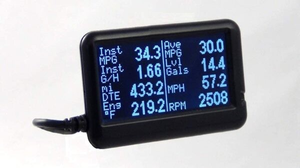

A feedback device is invaluable: UltraGauge is the inexpensive, configurable tool I’ve used for a decade to confirm or correct intuition
https://www.ultra-gauge.com/ultragauge/
This — and the overhead MPG readout (number doesn’t have to be right, just changes shown are accurate percentage-wise) — is how I ran those 90% same errands loops and over time honed sharper the edge.
Engine Load Percentage is a damned handy number.
