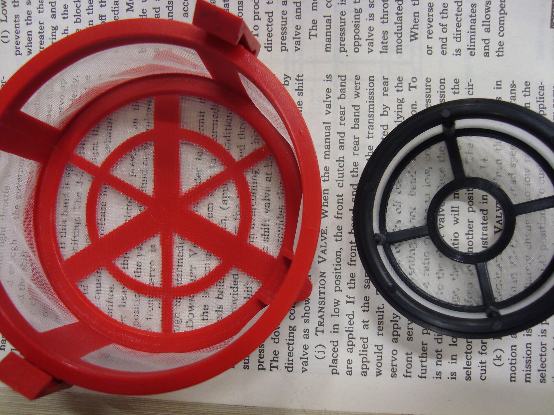

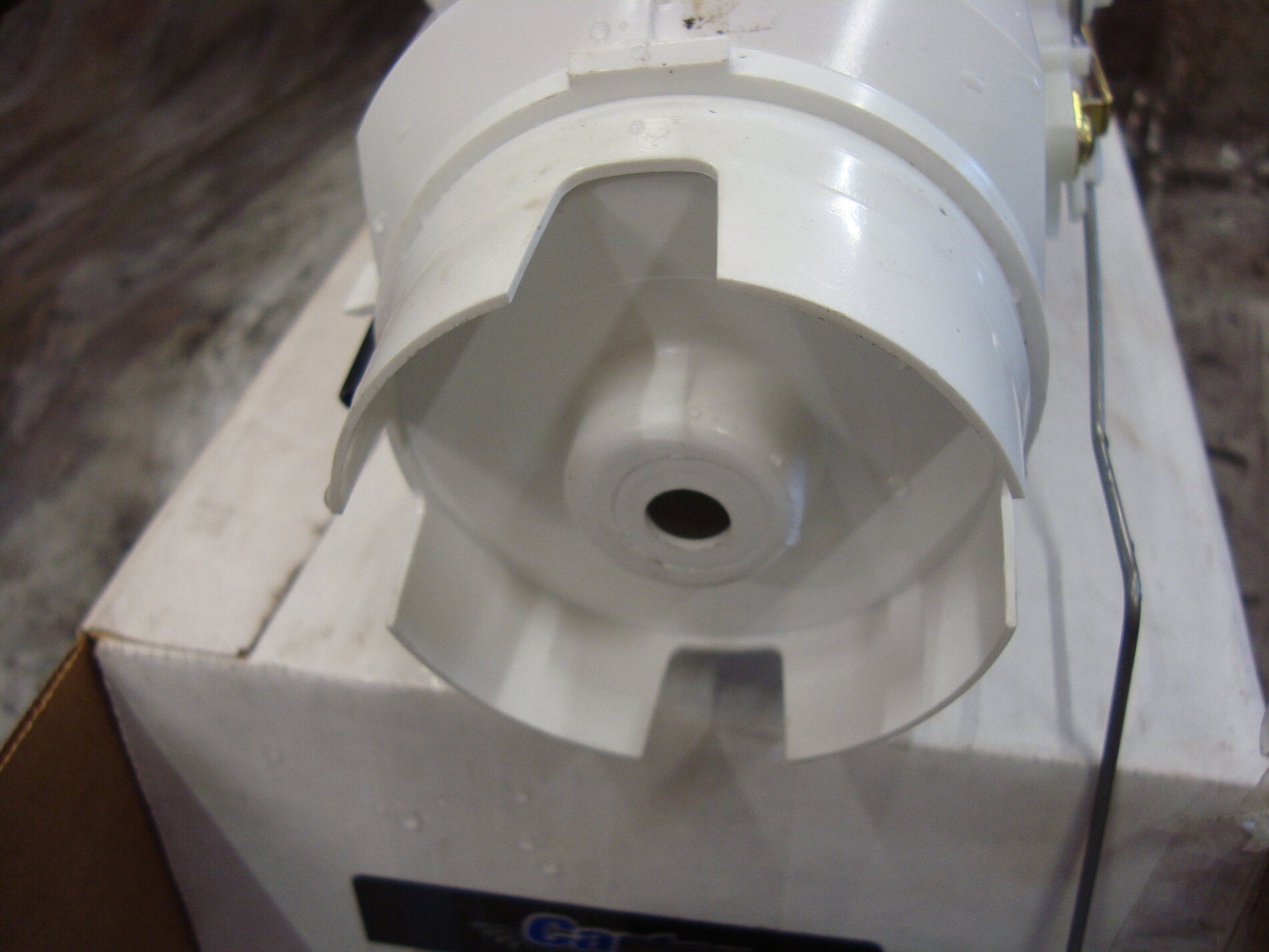

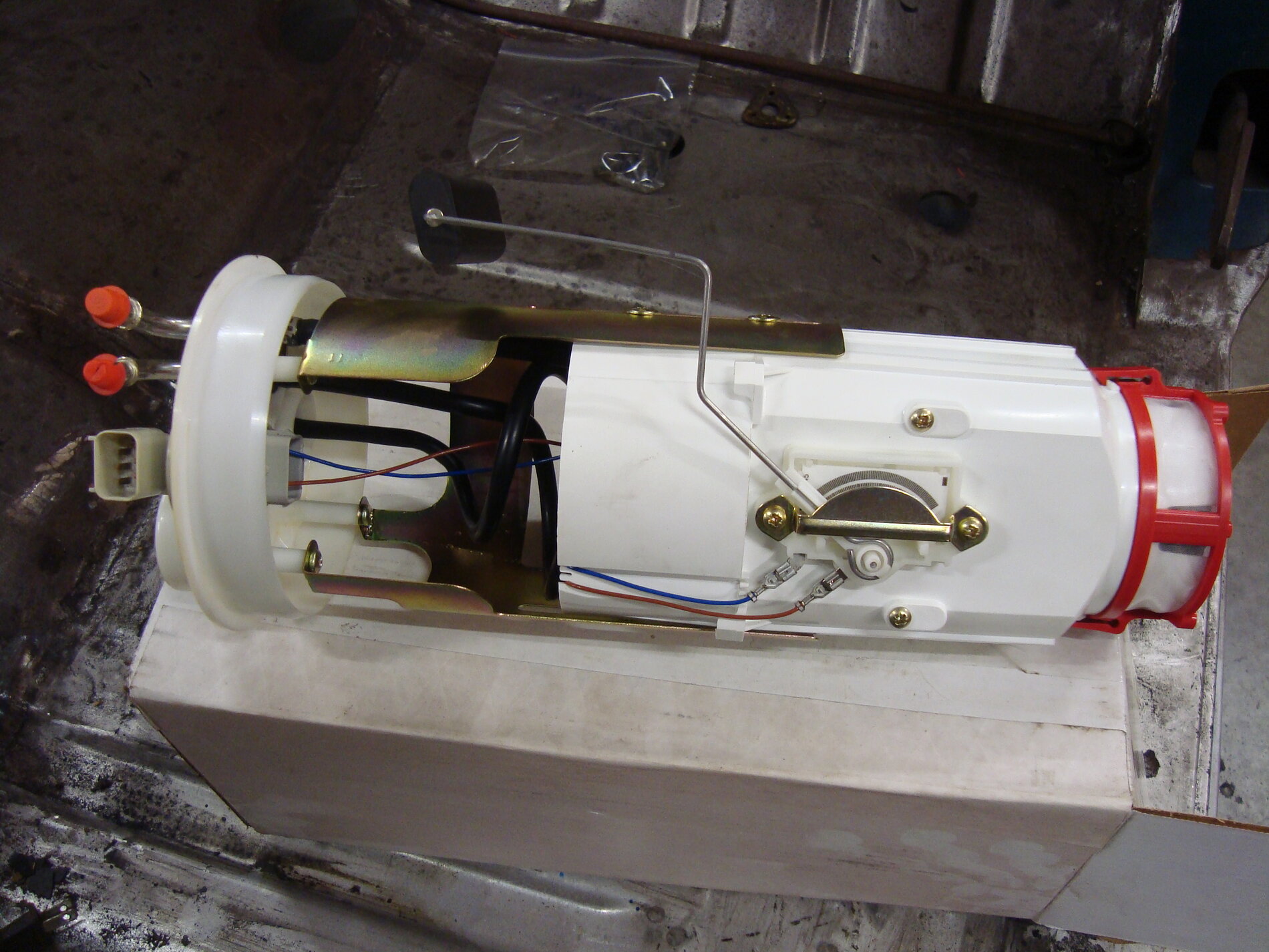

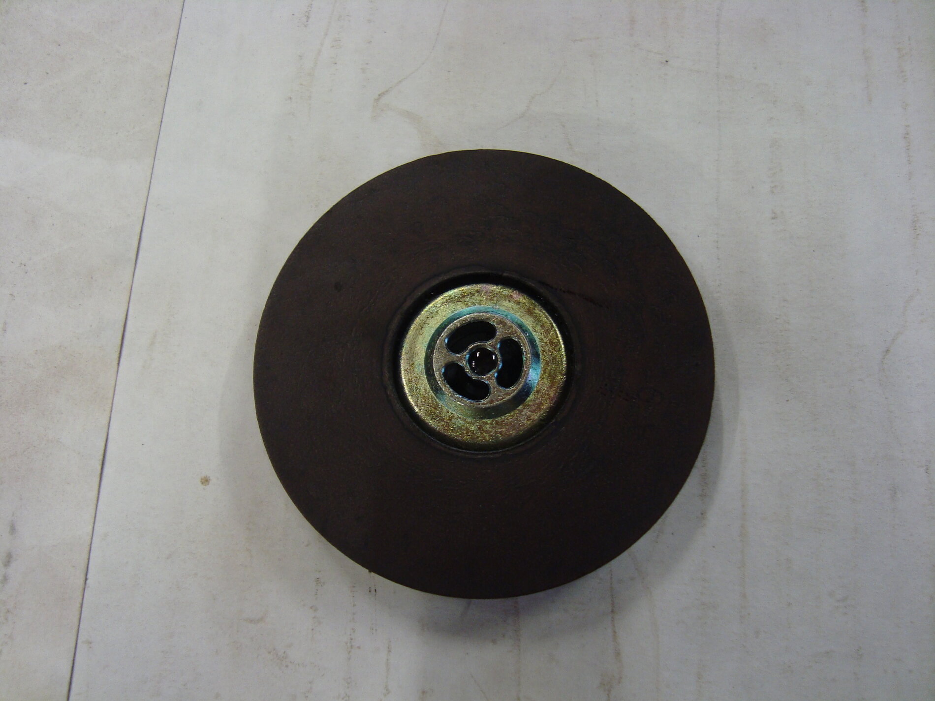

The old "sediment in the tank" wives tale. I've had my tank off three times to replace the canister/gauge sending unit. I've refueled in some pretty nasty windstorms in the desert, Canada and North Dakota. My tank has never had any sediment in it nor has the screen ever been clogged. This is a picture of the canister. Note that it is open at the top, not all the fuel that goes to the engine passes through the bottom strainer. There is only one.

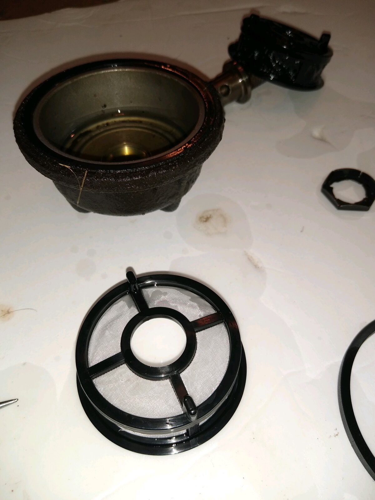

This is a picture of the canister strainer next to a prefilter screen. Notice how open the mesh is on the canister strainer?
Excellent photographs! It helps me to visualize what is inside my fuel tank. Hopefully, I'll find a debris-blocked pre-filter strainer when I open up the fuel heater's bottom enclosure.
My understanding is the design of the fuel tank module mitigates potential for fuel starvation. When I was reading about the fuel tank module (cannister), the writer indicated the cannister is designed to admit fuel through a one-way check valve into the "bucket" when the tank fuel level is low and the truck is on level ground. If the fuel tank level is low and if the tank is inclined while the truck motors up a hill then there is sufficient fuel in the bucket to crest the hill.
Presumably, the check valve is located inside the basket strainer.

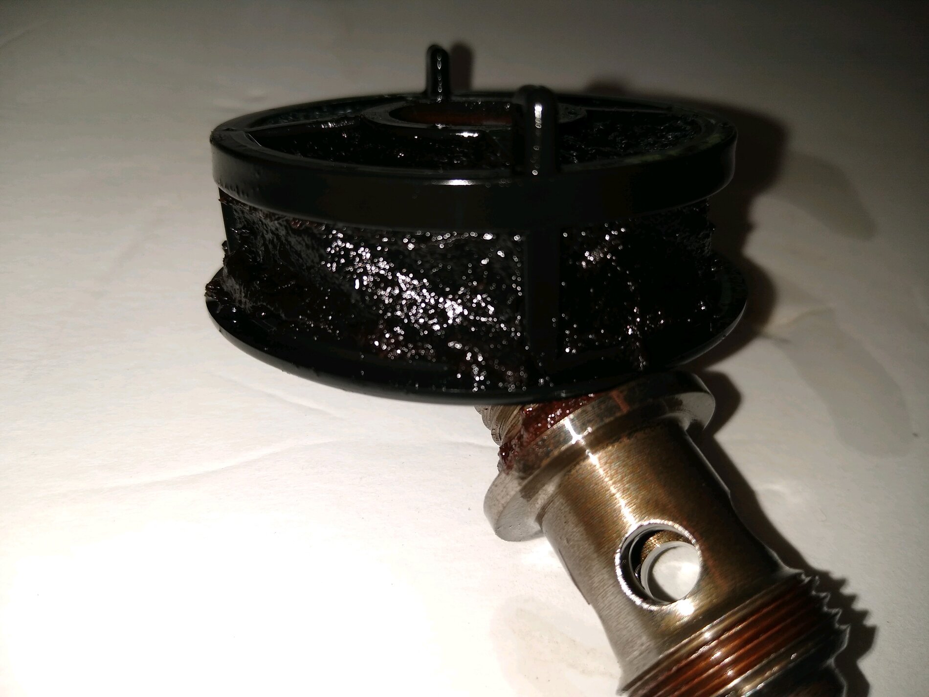

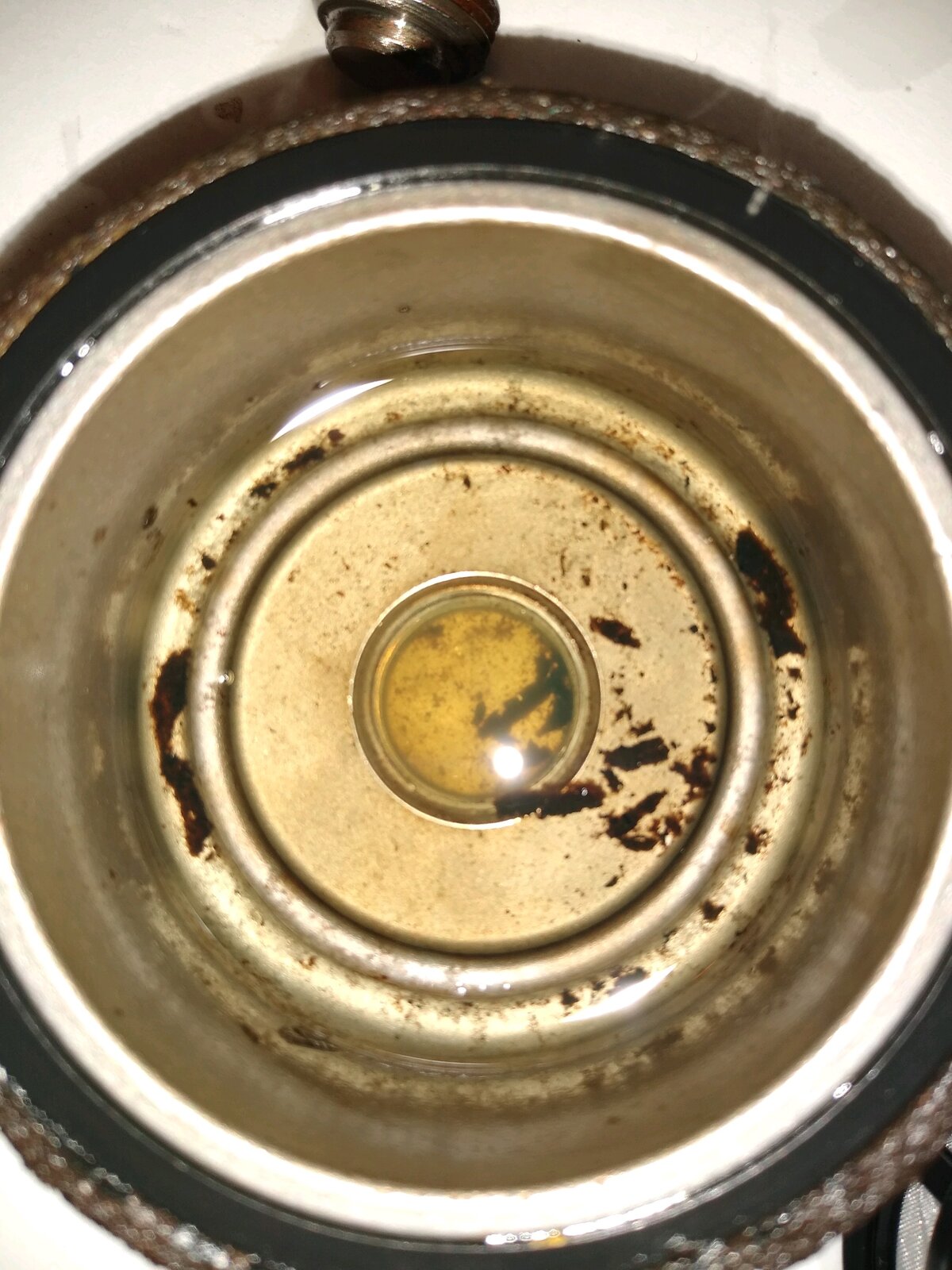

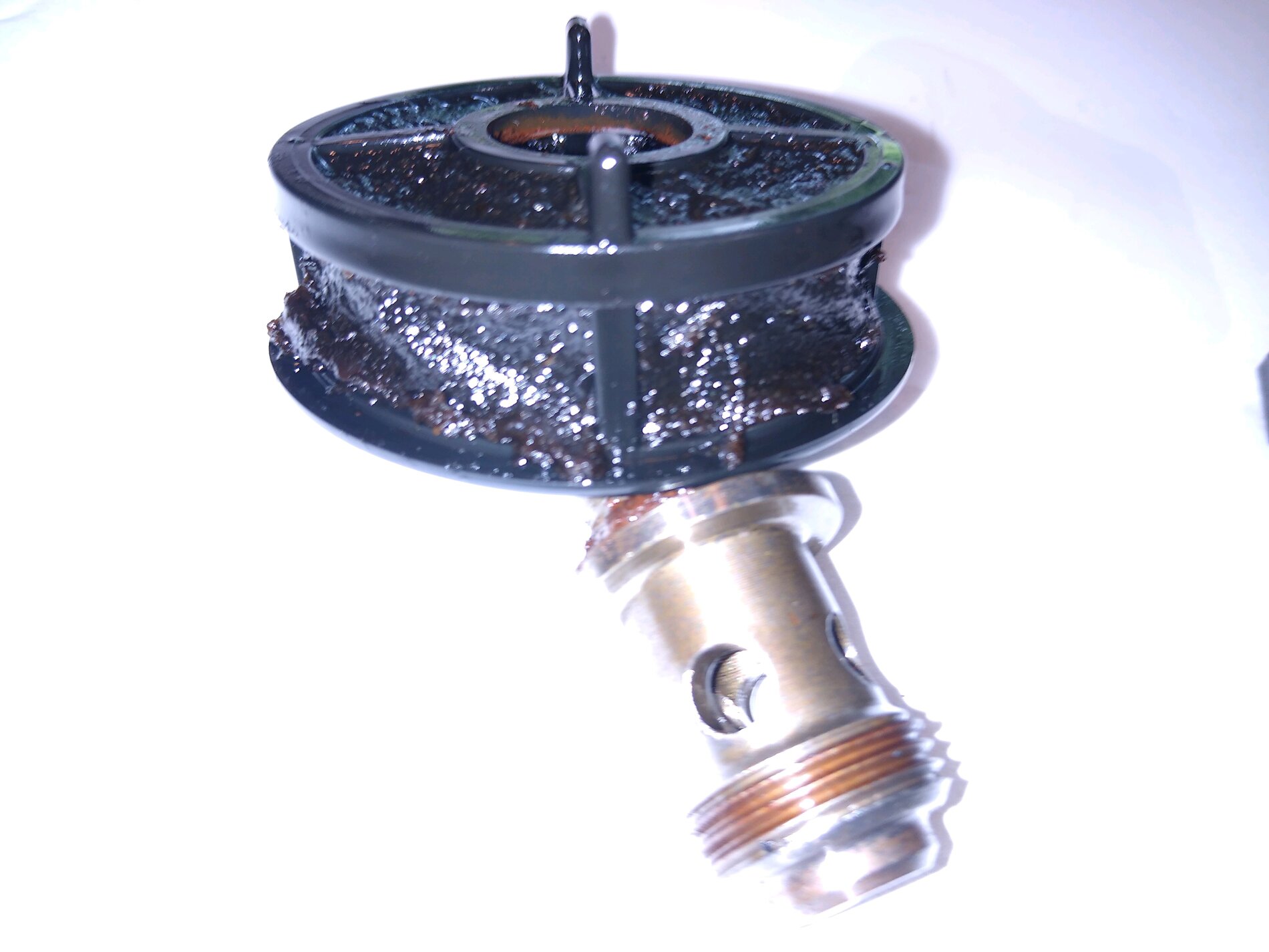

I just received a Fleetguard fuel pre-filter/strainer and it is unusually small compared to the much larger pleated paper fuel filter. I can readily see how this little strainer can become filled with fuel-restricting debris.
I'm up to my elbows in diesel juice working to eliminate fuel starvation and get engine running again. Fuel pre-filter strainer is caked with fuel-flow-restricting spooge! This is "Smoking gun evidence" for the cause of my diesel engine's fuel starvation problem. New fuel strainer is in the photo next to old fuel strainer.
