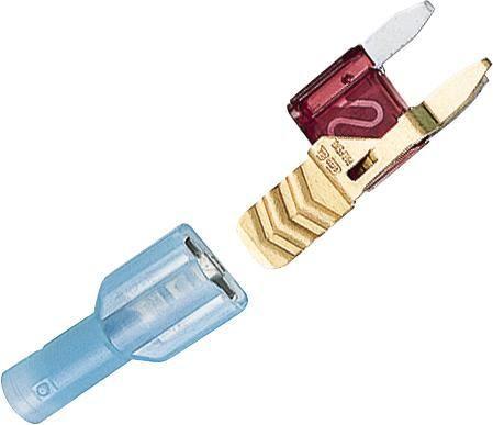

A blade fuse tap works nicely for this application:
Ideally you want to tap into the side of the blade fuse which does NOT have power when the fuse is removed. This will insure the blade fuse is protecting the circuit to your Isspro gauges.
