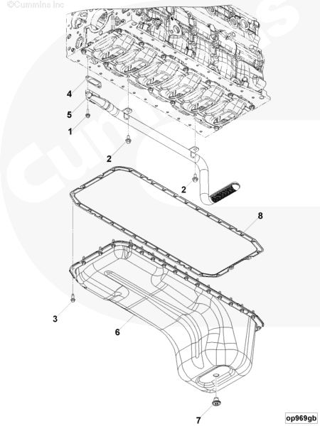

this is the 12 quart oil pan for these current engines. I looked it up on Quickserve with my engine serial numer so it appears to have a Cummins part number, not a mopar source.
6 5284232 Oil Pan
7 5301901 Threaded Plug
