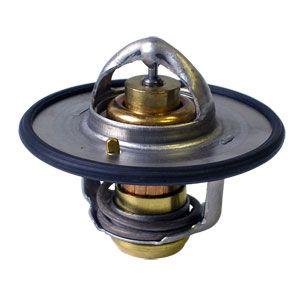

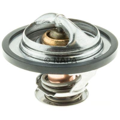

Hi Nick, the 180 degree thermostat may help reduce temps for you and I have found the 180 to be more than adequate for heat in the Winter all the way down to single digits temps. Usually have the temperature setting on the dash between 11 o'clock and 1 o'clock on the temp dial.
I also have found not all 180 thermostats are the same. When I looked into replacing the original it was difficult to find one with the same diameter opening. Replacement from Cummins parts counter and auto shops were all slightly smaller diameter opening. I did find the Napa 180 to be the same size opening as my original.
I'm traveling right now and don't have the part numbers of the original thermostat available at the moment!
Also I did see a Horton fan and wiring harness for 12 valve Dodge Cummins on eBay recently. I may be able to find and forward info if interested.
Running cooler may help everything attached to the engine over time!
Good luck with getting your engine you run cooler and keep us posted.
Michael
Michael, The opening size is an awesome catch! I have had the 5.9 Cummins for 28 years and never noticed, maybe because I always buy Napa, Lol Here are two pictures of the difference, first one is Gates, second is Napa.
