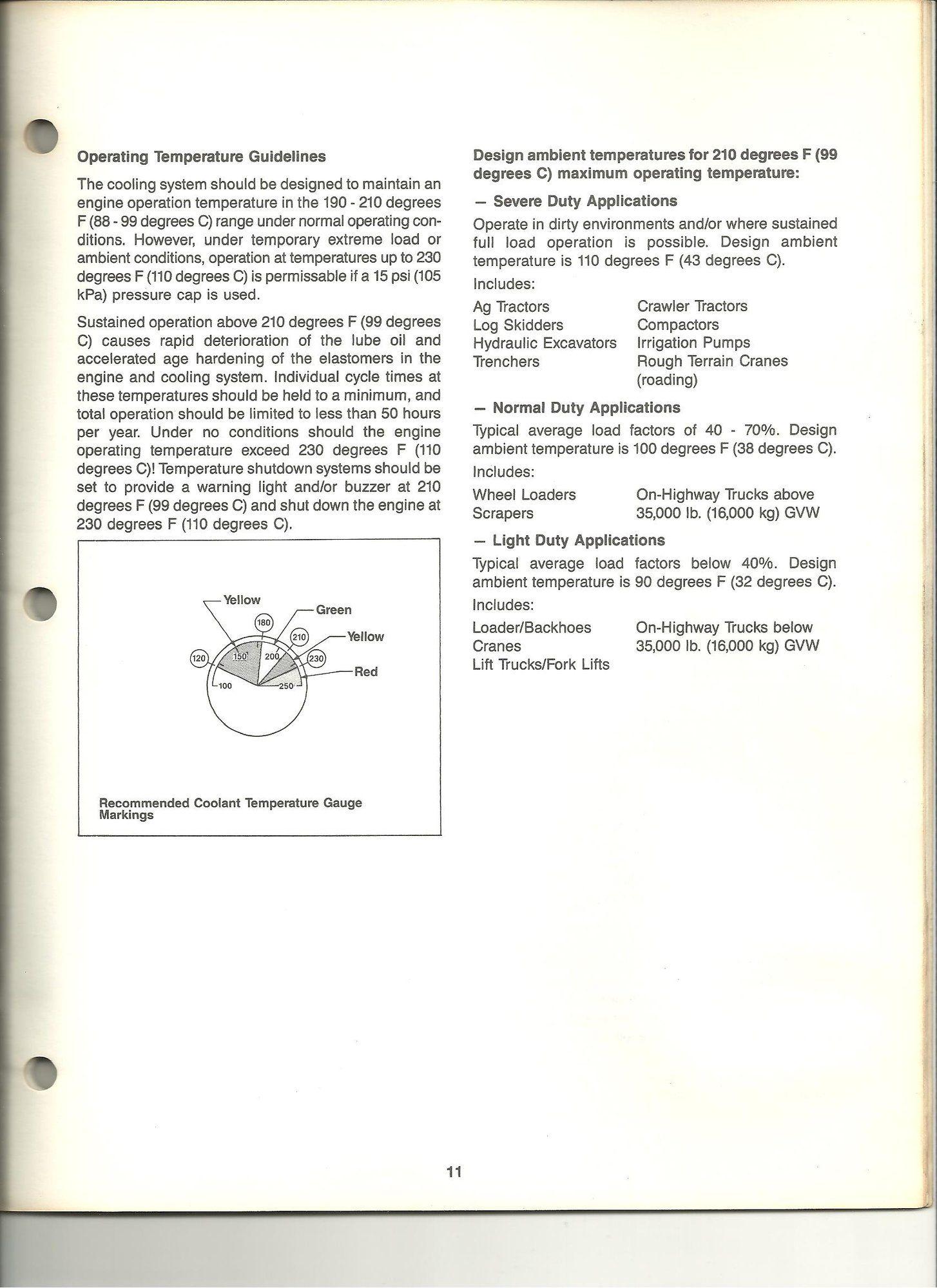

Note what Cummins says about coolant temps in my Re-power book. I am thinking the higher temps we see on the newer trucks are mostly emissions driven and not what's best for the engine. Fuel, engine oil, IAT temps will be cooler across the board, a win win. Fuel/injector VP pump, running cooler has to be a good thing.

I agree, I think everything will benefit with a 10* drop, in general, in the long haul. Case in point...my '91 Dodge and Ford Cummins both use 180* thermostats oem. The head gaskets, tappet cover gasket and ('91)vacuum pump seals are all original. My '01 uses 190* oem….it has had them all replaced, the vacuum pump seals twice.
Nick
View attachment 108218 View attachment 108219
Nick, the Cummins Re-power book is interesting reading and thank you for posting online. Since you are in high ambient temperatures during the summer months and with higher sustained engine temperatures have you tried using a 15 psi radiator cap as suggested?

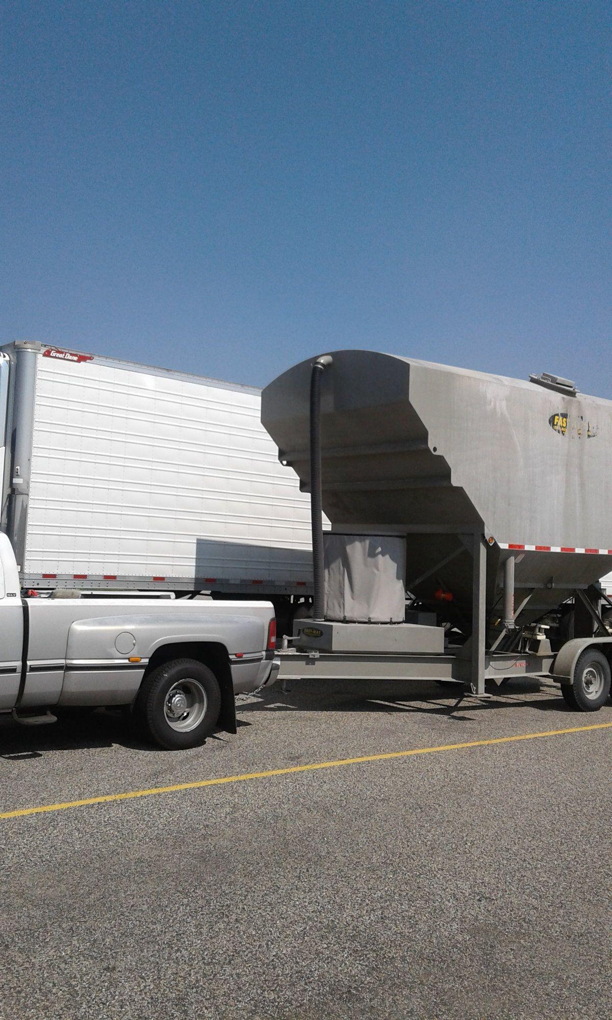

I found a load that met the match. 13' 6" tall, 8000+ pounds and worse aerodynamics than a brick. 15 pounds of boost and 900 egt to pull it on flat ground, no wind, 57 mph. It requires power to descend a 6% grade and maintain 55 mph. I saw 200-210 crossing MT on I-90 with the outside temps at only 85 degrees while climbing hills. I didn't have to turn off the AC though.
Is that the same one you hauled from Montana to West Virginia about 8 years ago? Imagine the power required to pull it 70 mph!

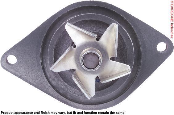

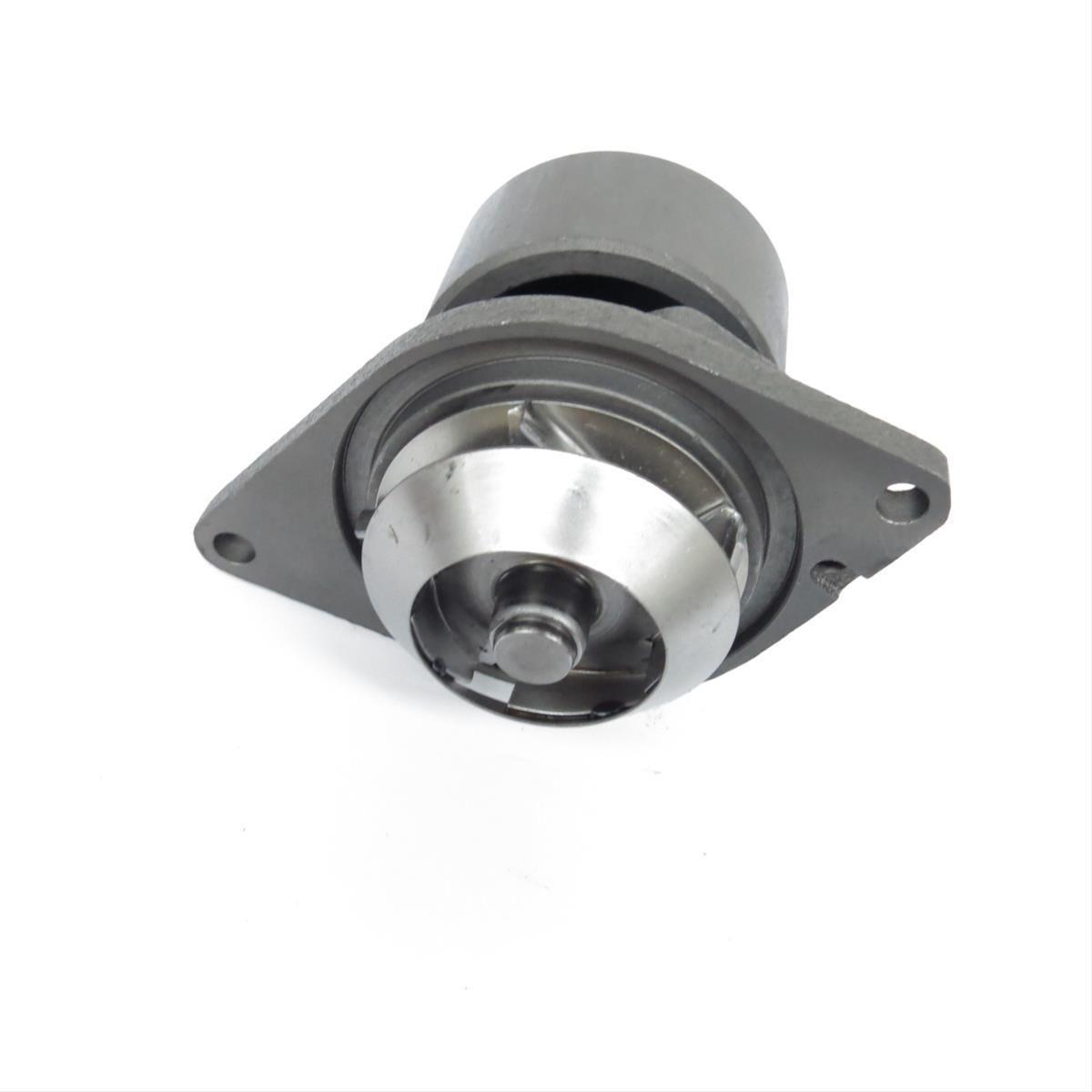

After my last post the gears started turning. Pump fins don't wear out and it isn't leaking BUT serpentine belts do wear out. If a slightly stretched belt can cause an alternator to under perform can the same be true of the water pump? We will find out soon. I replaced the belt and I still have the trailer, it was held up for non-payment and could be returned to Billings. At the very least it has a bit over 200 miles to it's destination, which will take me through Houston. Plenty warm there.
A new belt was probably a good call. Does your tensioner feel stout? I don't think the water pump has any wear items, however, they do make two different styles. I have used both but I have no clue of any difference in performance. Do you know which one you have? My belt and tensioner are both new as is my water pump.

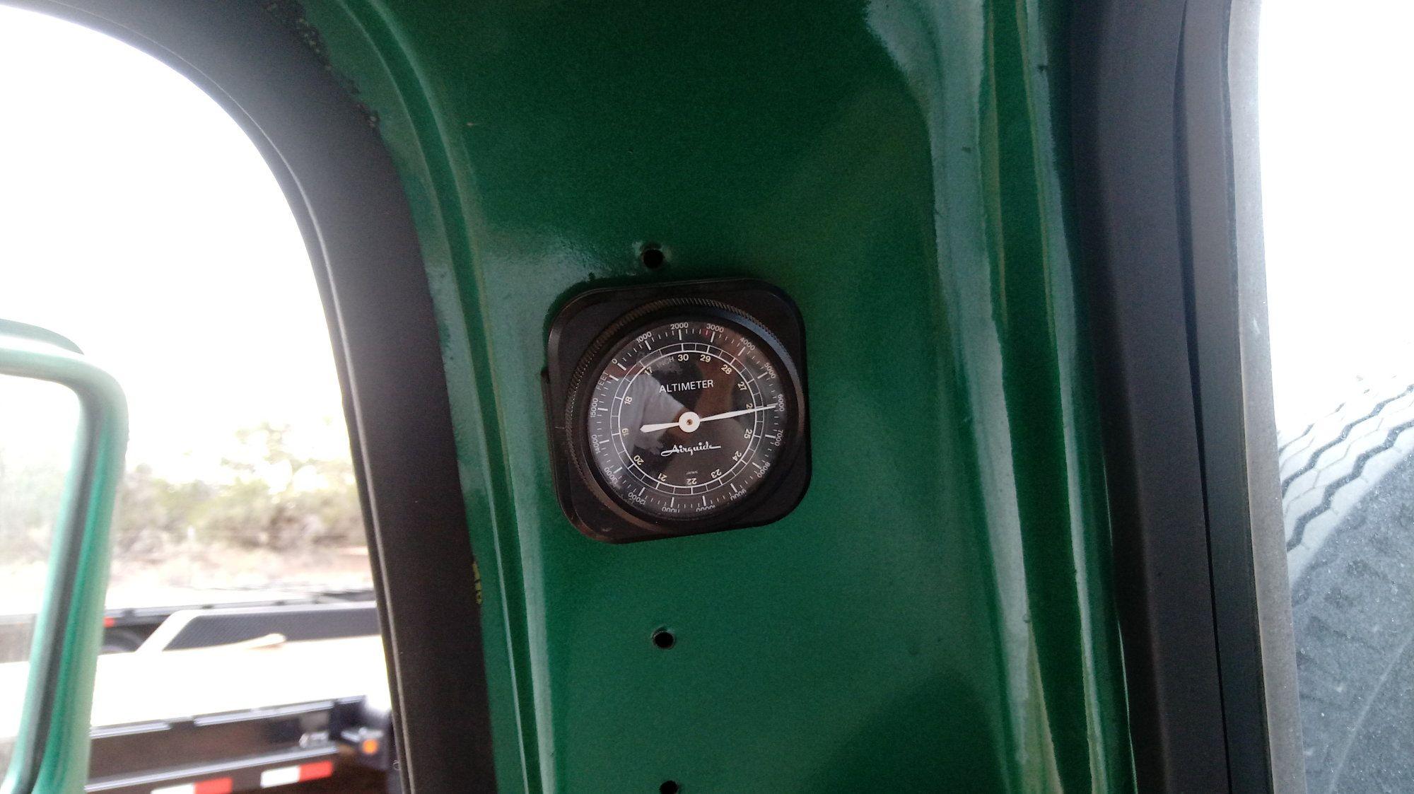

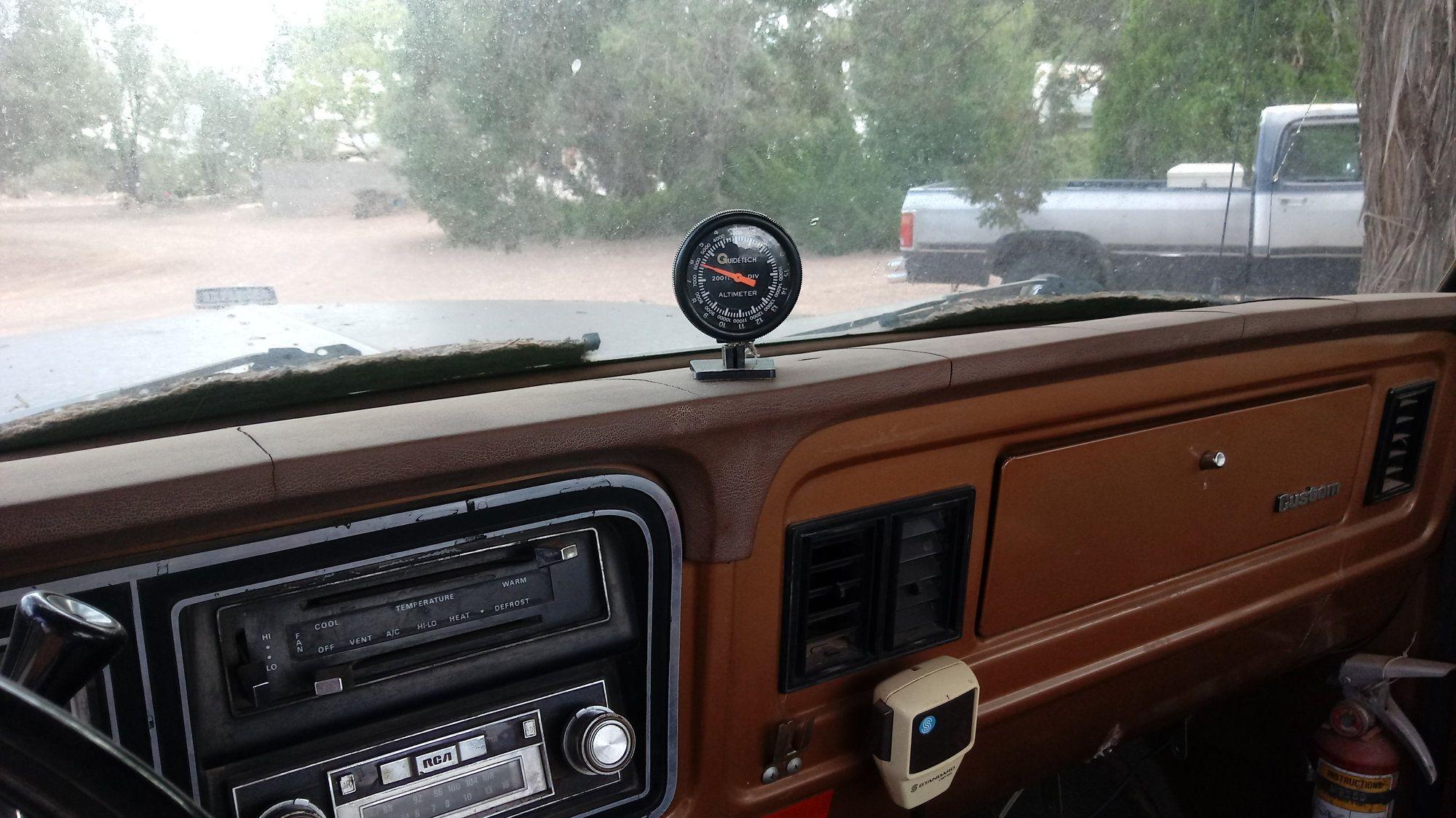

I have always been interested in elevation in my travels, I don't know why, I am not a pilot..Lol Here are my two old school altimeters in my old Fords, they are probably 30-years old:)
Those can be handy for knowing if you are climbing or descending, but checking actual elevation above sea level requires knowing what the barometric pressure is. Aircraft altimeters have a knob to adjust the setting. Aviation weather and/or ATCs in the tower tell a pilot the current pressure.
