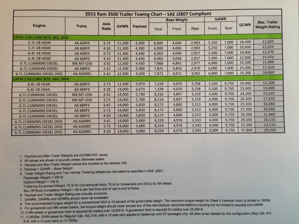

This topic has been ran over a few times! I have owned 3.42's with 68RFE and now 4.10's with AISIN. I towed 28-29K combined with my 11 HO 3.42's in 5th at 60 at around 1,750 rpm's. I tow 33-35K combined with current truck in 6th at about same rpm at 60.
The AISIN makes the 3.42's work great up to 28K or so because of it's lower starting gears. Bonus is the 3.42's will give MUCH better mileage solo than 4.10's. Don't even consider the 3.73's.
Look at the 3rd line up from the bottom. 29,300# SAE rated combined load!

I guess the SAE chart I posted above means nothing. I have towed with both, if my combo was 29k or less I would be running 3.42's.

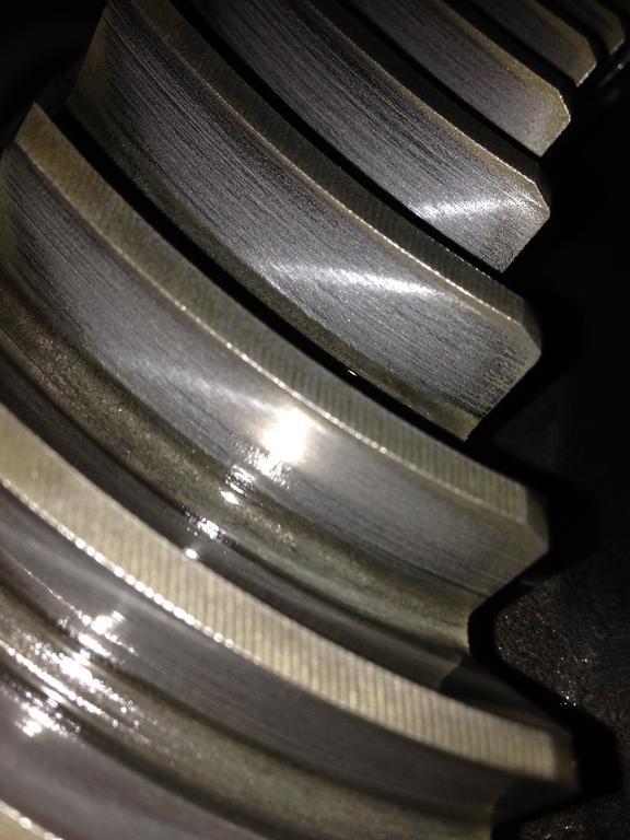

Second pic is at about 60K, with the machining still shows on the ring gear. Running AMZ/OIL 75/110 severe Gear 50K on lube.

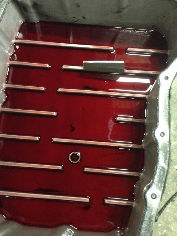

Third pic about 50K on the AMZ/OIL Universal ATF.
