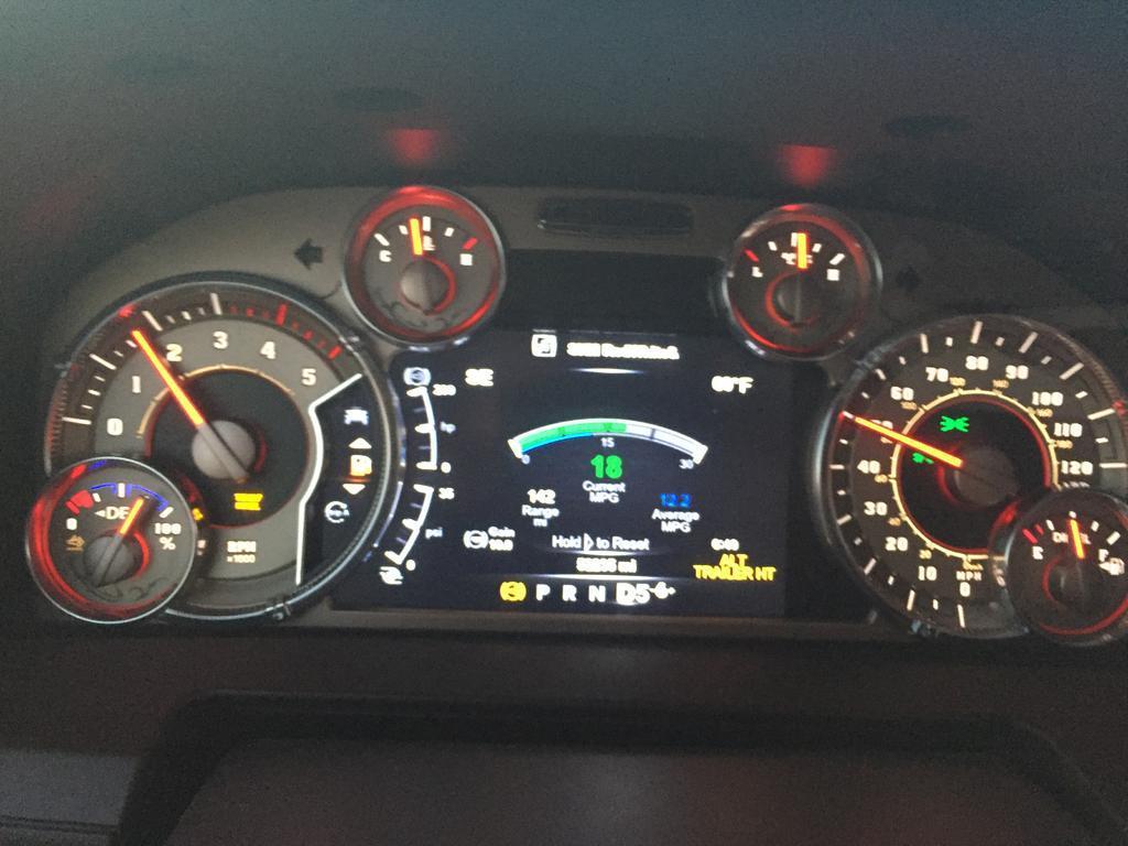

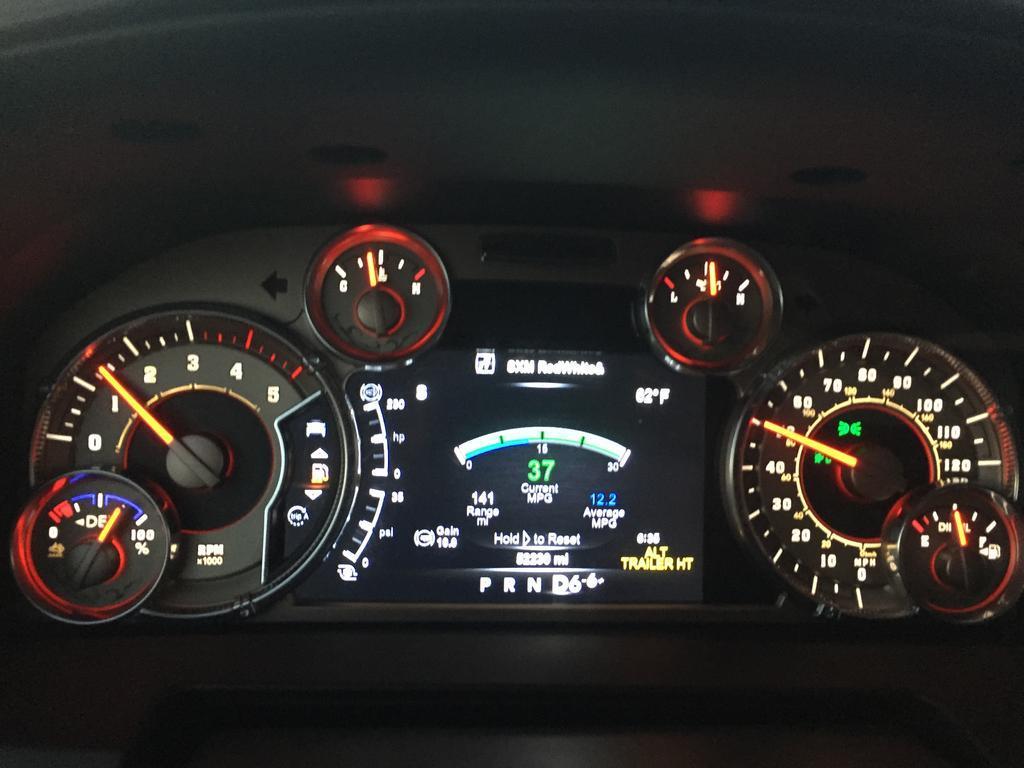

"Quote Originally Posted by RVTRKN View Post
What RPM when empty, as an example 50MPH T/H off and Aisin in Drive cruising on level ground?"
Here ya go! First pic is no TH or EB Second is with both.
