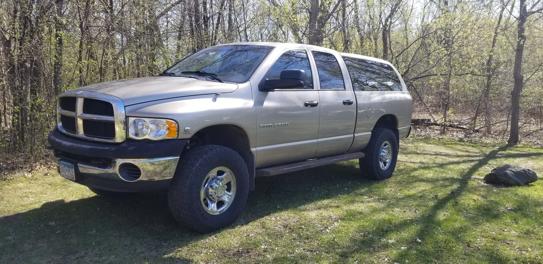

My early ‘04 2500 is also a RWD HO 305/555 with NV5600.
The NV5600 was available from 1999 through early 2005 in 2500's and 3500's. Not sure why you are thinking that they are restricted to only a 3500.
Yup my buddy has an 05 3500 dually with the 5600 and I had a 05 2500 crew cab long bed with it as well. Cutoff build date was like March from what I've seen.
