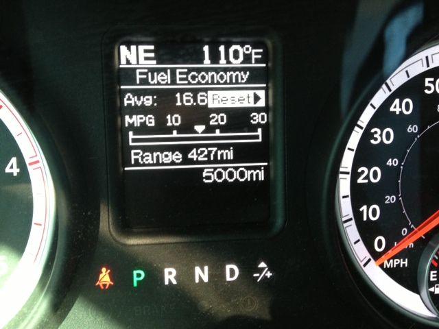

I have been runing a DEF equipped truck for 3 years now in some of the worst conditions... . have not had any issues with DEF being old. .
Wingate, if it deteriorates 1/2 as bad as sag2's info says, thats more then likely what my problem is. In the shade, the temp gauge will show 115-119 on occasion so that means the DEF tank, right next to the ground is probably getting that heat too. The gallon I had for a spare was in the bed in a tool box. No doubt it got as hot or hotter then the above. Only 3 weeks old, subject to high heat. .
