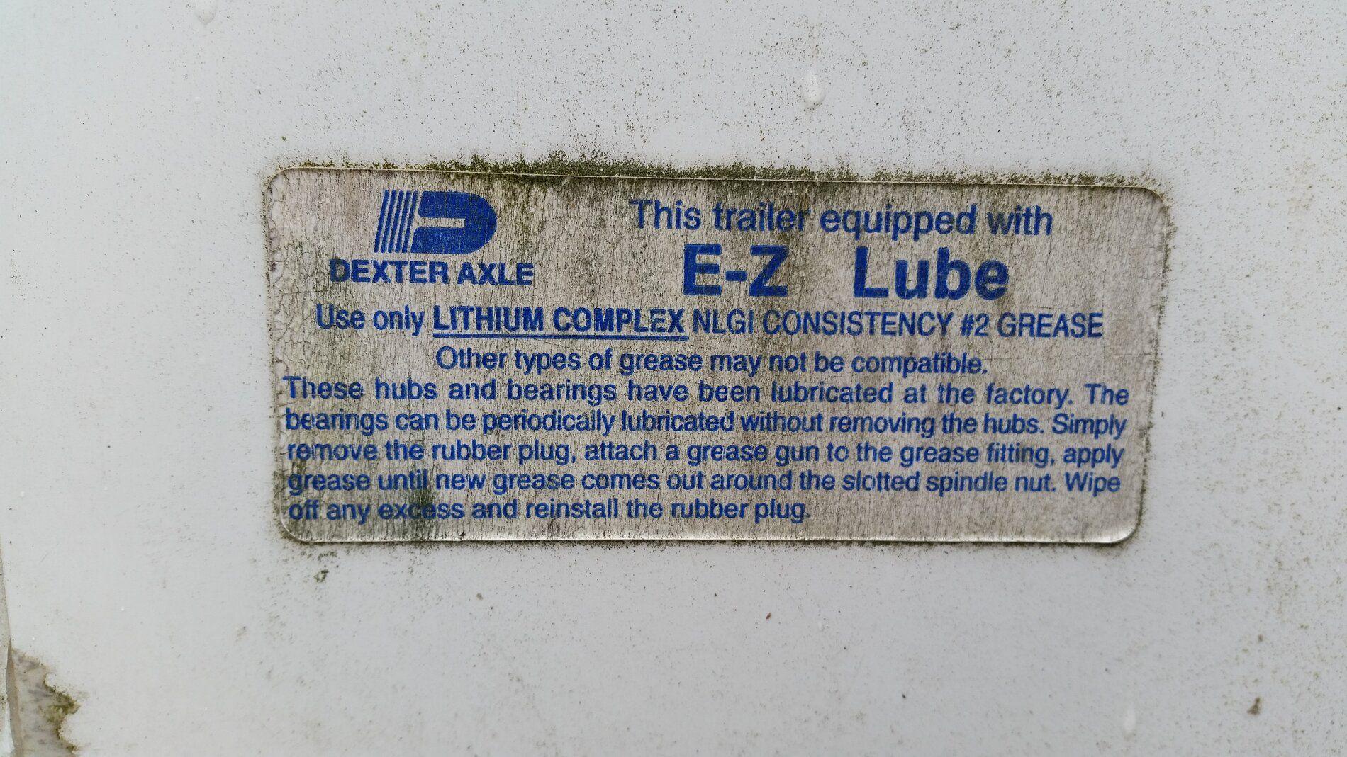

You can understand why people over grease these bearings. Look at the instructions on the side of my cargo trailer for the Dexter axles.
"Apply grease until new grease comes out around the spindle nut". I can imagine some unknowing owner just pumping grease until it is coming out everywhere.
In order to have grease coming out around the spindle nut the entire hub has to be full of grease. So "over" greasing is part of the process. A really stupid system for trailers with drum brakes.
