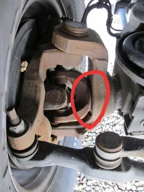

When changing the wheel bearings, did you put back on the brake shields or left them away?

The point i go to is - the axle shaft has very little endplay to the axle tube itself, if something on the outer (knuckle) assembly is not in spec, the axle shaft will grind the face of the axle tube.
I had that once with a failed (non stock) balljoint on my truck.

I forgot to re-install the drivers side brake shield, just left it off. Torqued everything to spec. I have not changed the ball joints. I’m sure it’s coincidence but only started having this problem after the tires. Hoping to get it knocked out this weekend. Thanks
Now I'm pretty sure about that, please do a test.
Check the area shown in the picture.
Mine touched there, with the brake shield missing your shaft moved inward 1/16.
If you want, use some oil on that gap to test if your noise disappears.
Mine did.

Well that was definitely the problem. Got back home and tore it down again, this time installing the dust shield. I painted it up before hand. No more grinding noises. Thanks Ozymandias
