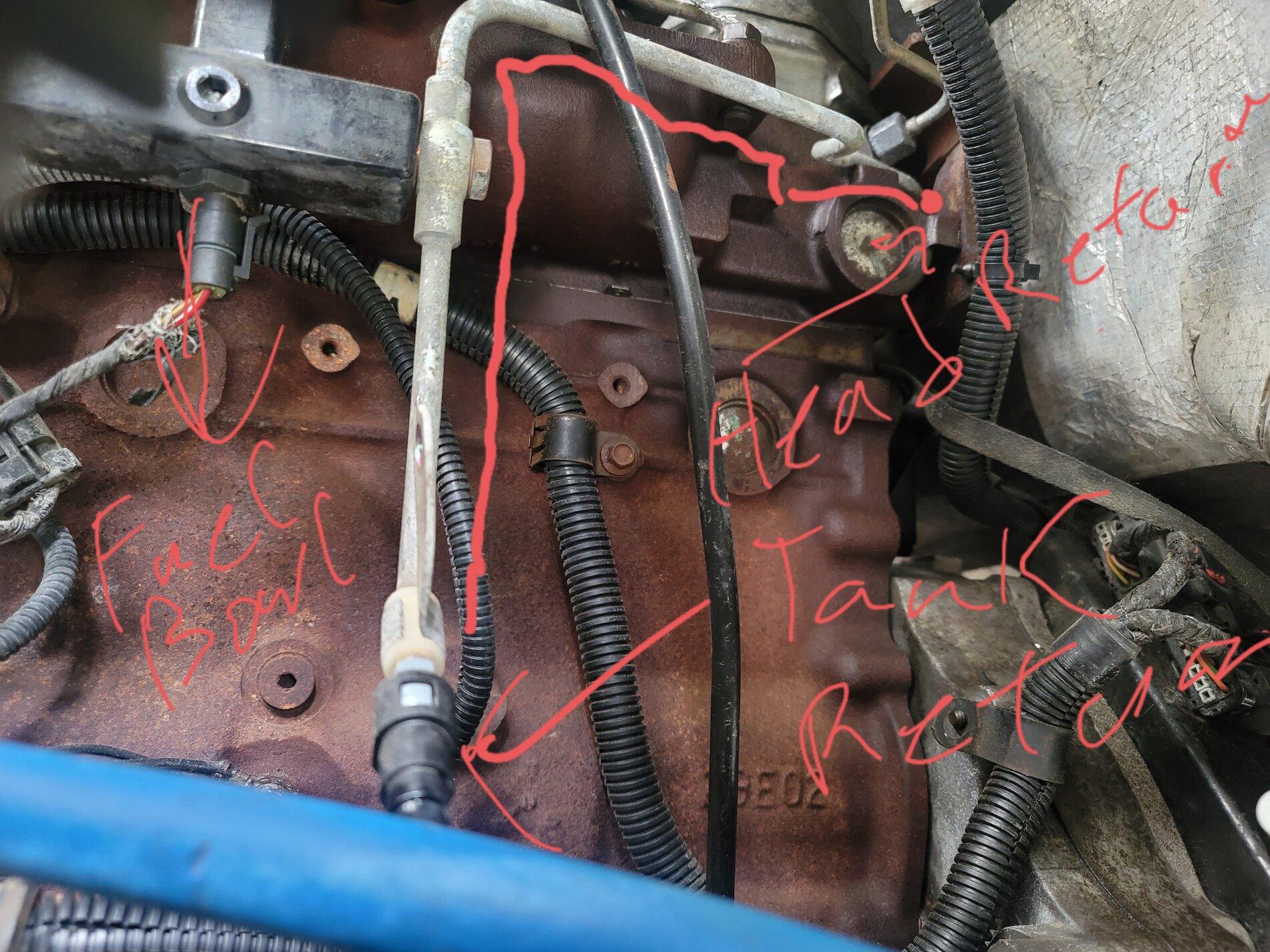

Return flow on your injectors I assume?

I have never seen it anywhere near 4 or 5K while cranking, but I have battery issues on the tester that I need to fix. I have ordered the test kit for fuel return test, is it difficult to access the port? I will replace the batteries in my tester and retest, it frequently shuts off while I am cranking.

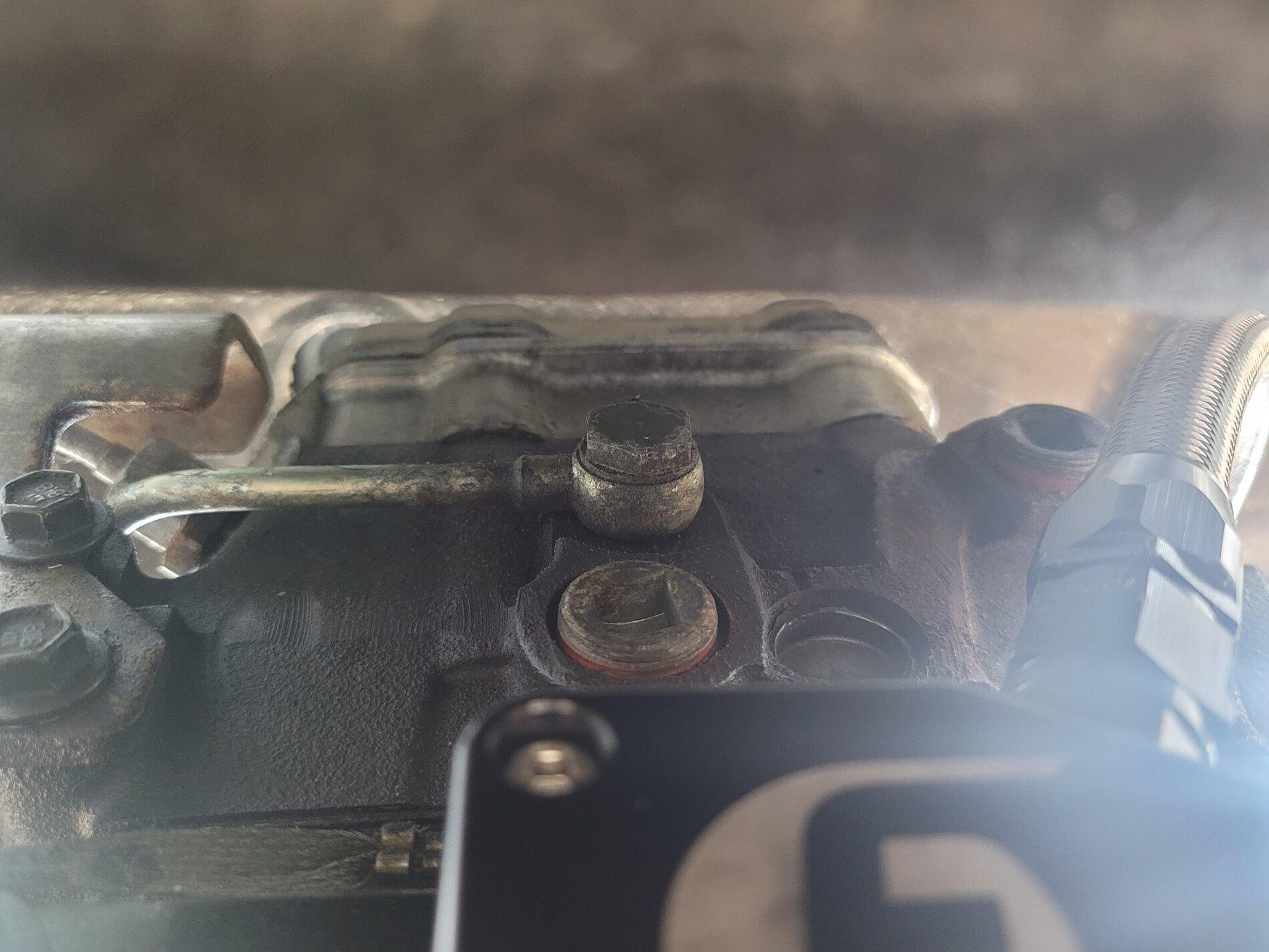

I have replaced the FCA pigtail and the pressure relief valve. Am I down to the injectors? Should I use the cap tool and go through the rail 1 by 1, or just replace all the injectors and tubes? I don't think I can get to the back of the head.

Well, I am deep into it.... Haven't been this filthy in years. I have the first five lines and tubes off, but I just can't see hw to get to #6. It is just way back there. I have removed the lift hook, needed to do that to remove #5. Any ideas or shall I skip it? Hate to do that.... but it is my only vehicle and I can't have it down for a long time.

Also, I bought every tool I could find that was recommended (except the top creeper, REALLY regretting not getting that) and I needed every tool. I have the 24mm special flair nut wrench and I just can't get to that last line. And if I start messing with it and am unsuccessful, I am screwed because I'm sure it will leak. Of course if that injector happens to be bad, I am still screwed.
