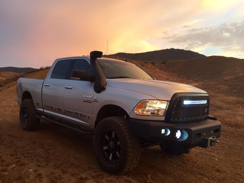

BTT and my first post on TDR - I'm Dave Bennett (I looked for an intro thread to no avail) and I run another Forum called American Adventurist, this forum was recommended to me by @Photowrite aka James Langan.
That said, I have 37 inch Toyo RT's on my 2016 Ram 2500 CTD 4x4 that I affectionately call the Torque Wagon. And I have TPMS issues that I'm seeking a fix for. Max pressure per Toyo is 65 PSI - so 80 PSI is never gonna happen.
I scheduled an appt to update the Uconnect 8.4 firmware and to address the TPMS system. I see new 2500's on the lot with dealer added 35's (non-80 psi tires) so I know it can be done.
So after speaking with them on the phone to schedule my appointment and CLEARLY stating my desire, I took time off work today to take it in.
Now the service writer tells me that they can't change the TPMS threshold. So I'm asking, what about all those shiny new ones there on 35's and 6 inch lifts?
...there's no fricken way that someone is going to buy a new truck with the TPMS idiot light on. Service writer says they can't "legally" change the threshold and that "somebody" does that aftermarket. Basically, a bunch of BS and a big disappointment.
I hate having my time wasted. So my next stop will be 4 Wheel Parts here where I "think" they have their lifts and tires done at (you know, the ones that they add a second sticker of like $10K for), we'll see if they have the Dodge Star or whatever software to do this seemingly simple task.
So I just spoke with the rep from DSI (a division of 4 Wheel Parts). He said they do all the lifts and tires for the dealers in this area. They use 80 PSI tires because they cannot reset the TPMS to different thresholds. Damn frustrating, but now I know that answer. On to the next option - remove dash and smash idiot light!
