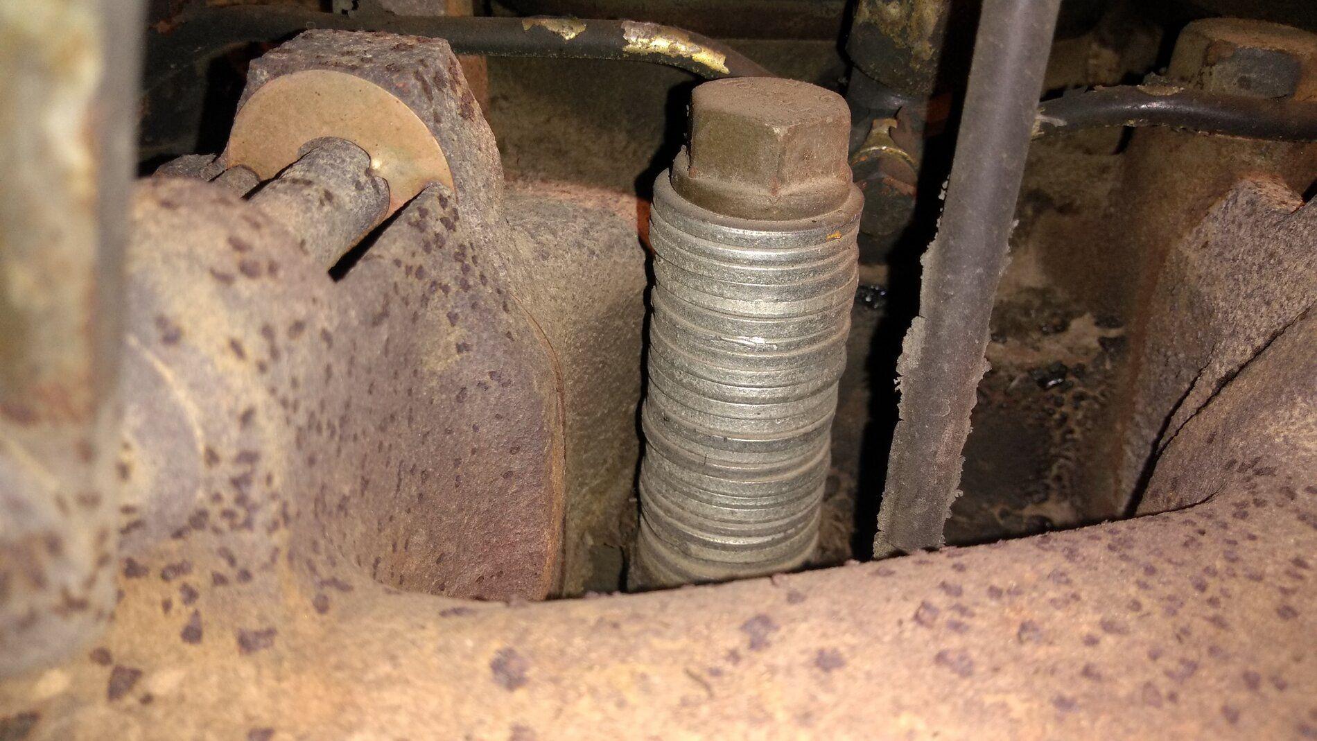

In 2015 I overheated the engine and broke a head bolt on the exhaust side at 350k. It broke the same as yours did - sheared flush with the surface of the head. At the time there was a national back order on head bolts. I have a friend that owns a diesel repair shop so he gave me a 24v head bolt that he had laying around and said good luck. 24v bolts are a fair bit longer than 12v bolts so I had to put a bunch of washers under it. I figured I'd rebuild it in a few months so what the hell. A few months turned into 4½ years and it's still clamped, gets 18mpg, and has 425k on it. I think yours will be ok.
