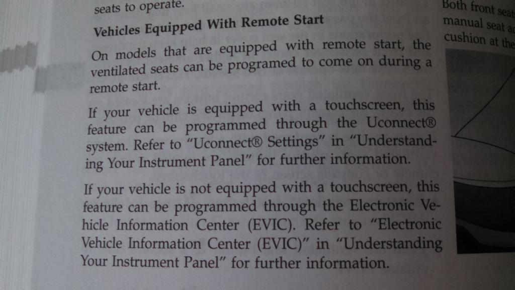

This is from the Uconnect manual.

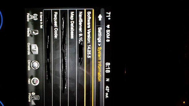

14.05.3

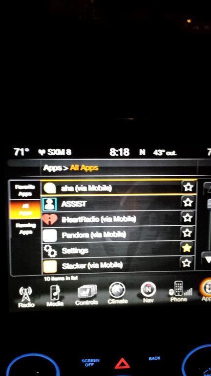

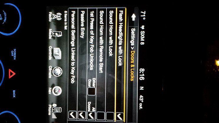

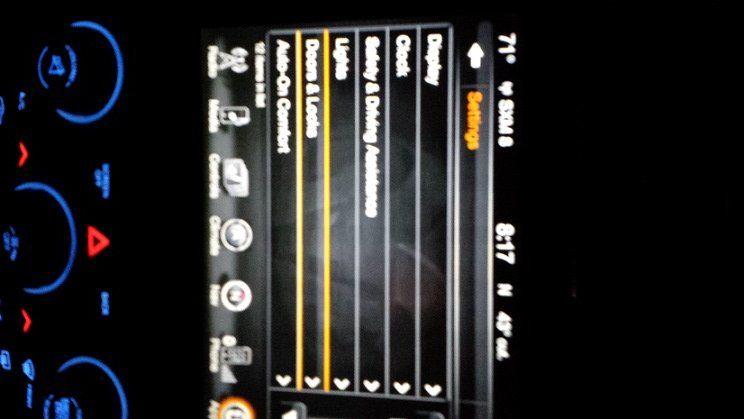

Mine works fine, no issues as per stated by some posters. screen shows as per photo. Hope this helps.

Todd, I would if the friggin box was there to CHECK! Or if the line on the screen had any text in it.
PLEASE put your truck on that screen for auto on comfort settings and PLEASE post a pic for me....
Todd, does your truck have factory remote start and heated/vented seats? The line USED to read
AUTO ON COMFORT AND REMOTE START
It was where yours now reads AUTO ON COMFORT
If you have factory remote start and heats seats/steering wheel and ventilated seats, when you selected AUTO ON AND REMOTE START, there was a complete page of options to tune the seats, steering wheel, and remote start. Since the updates, there is only HEATED STEERING WHEEL on the next page and the box when checked unchecks itself. I attempted to exit the screen, save to a FOB etc... so far, no luck.
I have not found a way to select the seats on REMOTE STARTUP or on a startup from the drivers seat. These functions were in there when I purchased the truck and are no longer there.

14.25.05 is the latest Version

Thats not what I purchased and not what it clearly states in the owners manual and the uconnect manual.
