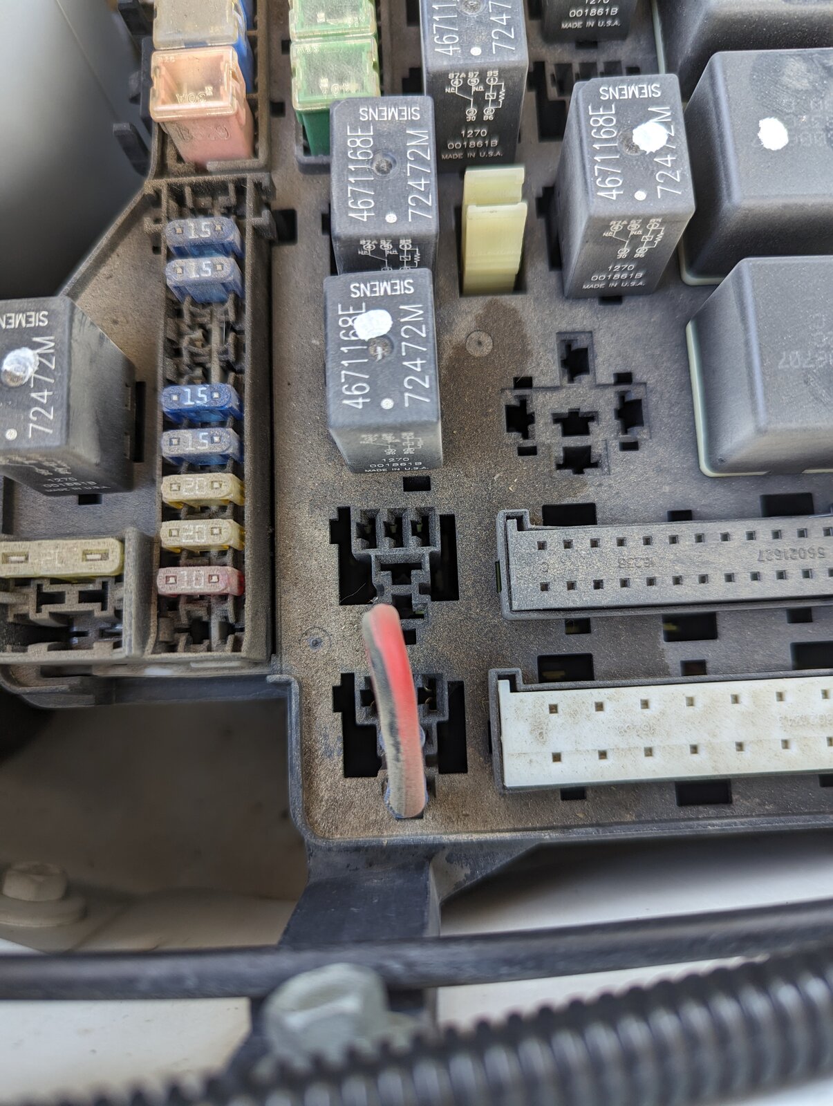

There is a fog light relay in the PDC under the hood. Pull that relay and jumper it. When fog lights are on, they are on regardless of low beam or high beam. I run with mine on 100% of the time with some orange LED bulbs, more as a running light than anything, the 2nd gen fogs are worthless as a fog light, so I put them to use as an orange running light.

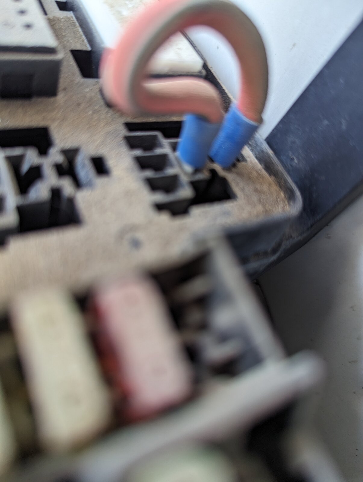

Can't recall which terminals get jumpered, mine has been like that for probably close to 20 years. if need be I can look and maybe get a photo.

A pic would be helpful if you could, thanks.
This jumper allows factory fog lights to remain on with high beams, 2001, non sport truck, YMMV with other years and sport trim.
